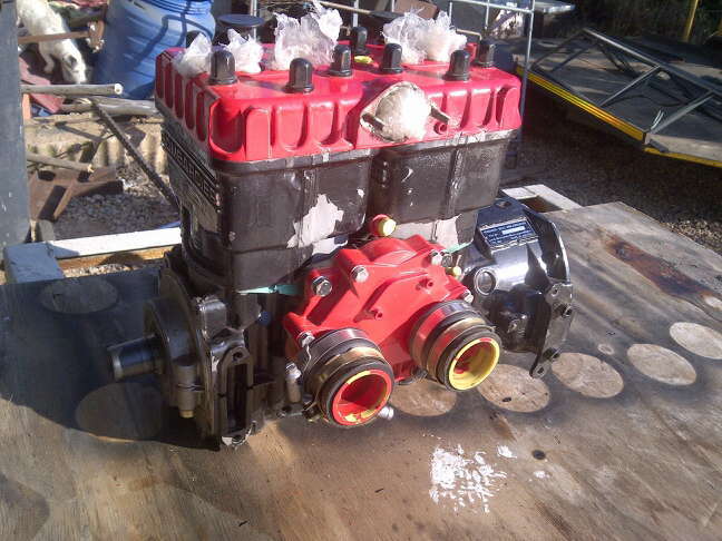

Hallo all
Does anybody recognise this type of engine?
Its a Rotax 582 according to the data plate.
Is it a blue top or silver top,or does it come standard with the RED top? :roll:

Postby flyingdutchman » Mon May 05, 2014 9:41 am
maybe its a silver top
can it be coverted top a bluetop with out to much hassle?

Re: Rotax 582
Postby nicow » Mon May 05, 2014 9:07 pm
Its a painted silver top 582 motor...
Re: Rotax 582
Postby nicow » Mon May 05, 2014 9:09 pm
You can make it a blue top(without paint ## )but first check the hours and the crank(full inside inspection (**) )

Postby John Boucher » Mon Jun 30, 2014 12:56 am
Rotax Red Top is usually a 583 (90hp?)
Posts: 1262
Re: Rotax 582
Postby Jean Crous » Mon Jun 30, 2014 9:56 am
The 583 has the same water circulation as the 618 and the 582 blue top, also the 583 has the RAVE valves of the 618, and the head is silver vhpy
Jean.
Posts: 4330
Re: Rotax 582
Postby John Boucher » Mon Jun 30, 2014 1:39 pm
The engine in the picture looks as if it has been pulled out of a snowmobile (which the 583 really was used for!)
Scorpio
Posts: 128
Location: BRITS
Re: Rotax 582
Postby Scorpio » Sat Jul 05, 2014 7:42 pm
Not a 583...There`s no rave valve, which the 583 has, also 583 is a single ignition, comes from the snowmobiles. this is a Sivertop 582....Water port on cyl.head is side ways...582 Bluetop is side and upwards.---582 mod 90, that is resprayed. Nice looking though..

Posts: 1161
Re: Rotax 582
Postby Leprachaun » Tue Jul 08, 2014 3:14 pm
I need a picture of the cyl head from the top , and the waterpump inlet fro the side , and flywheel side , clear pic please looks like a modified silvertop , ex spraypainter . leprachaun

Postby mulderpm » Wed Jul 09, 2014 10:51 am
Without opening it you could also send the serial number to Rotax. They will know what it belongs to.

Posts: 1161
Re: Rotax 582
Postby Leprachaun » Tue Jul 15, 2014 1:20 pm
I am pretty sure that engine came from George with a highly modified trike , silvertop , with painted barrels and Cyl head , is it for sale ??? :mrgreen:
