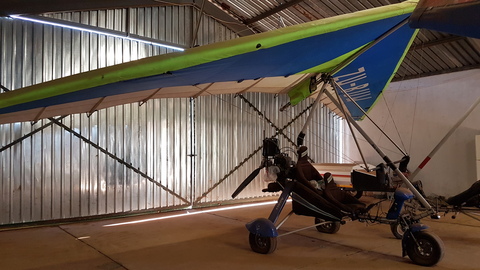

Here are some of the pics.. will get some of the engen during the week..

Re: Aquilla 582 price
Isn't an aquilla 2 wing keel pipe supposed to be inside the wing sail?
Suggesting an Aquilla 1 wing?
definitely an Aquilla 1 wing ... the washout batton is also on the outside

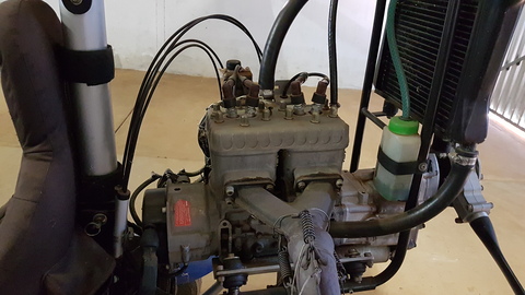

If you see something in the pics to follow..then please let my know..

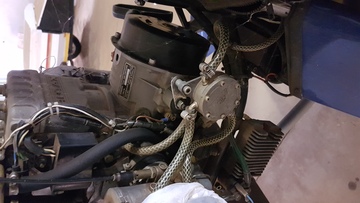

Some xtra pics.
The hoses on your plane are air hose, replace them with proper fuel hose. Air hose gels up with fuel and may result in an unintended landing somewhere.

Gav is 100% right....those hoses gotta go pronto!
