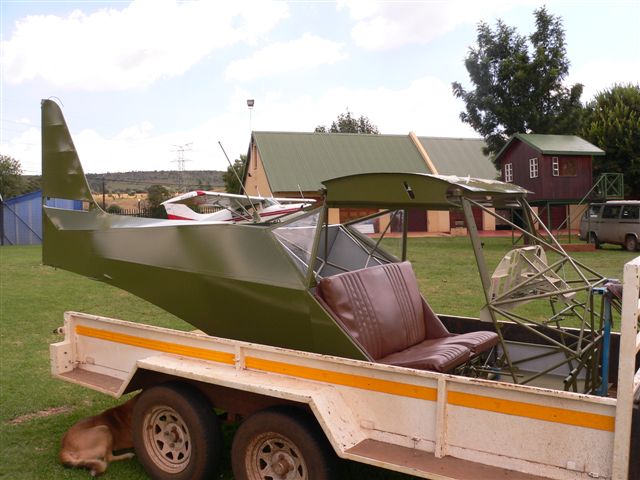

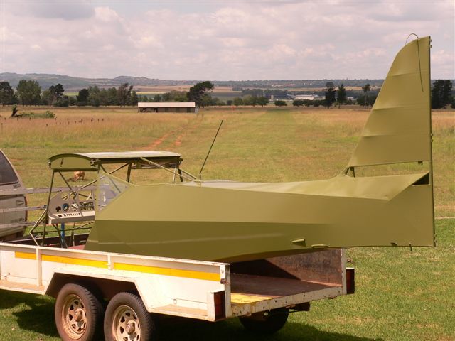

My explorer is making good progress in the capable hands of Peter Magnus who is doing the major part of the construction with me running around doing lesser things.
The fuselage is now covered and I will be collecting it tomorrow to start the painting process.

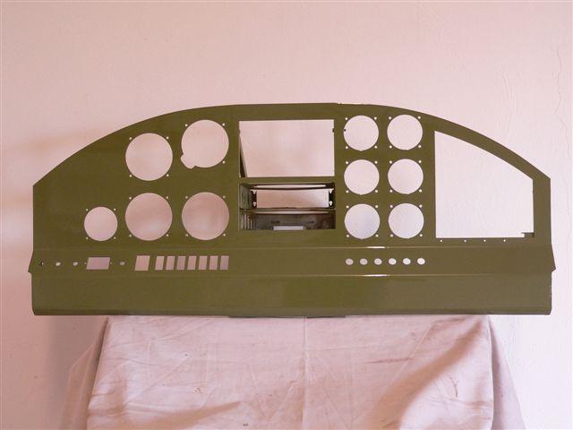

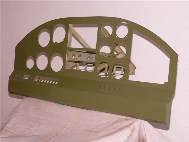

My biggest contribution has been the design of the instrument panel which I have now painted, pics to follow.

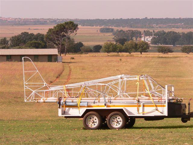

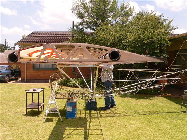

Delivery
bUSHBABY 010 (Small).jpg (62.02 KiB) Viewed 8263 times

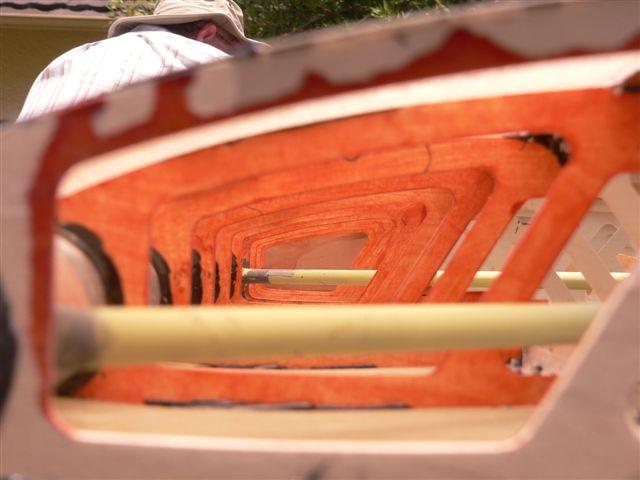

View of the ribs
bUSHBABY 012 (Small).jpg (34.04 KiB) Viewed 8266 times
Wing side View
bUSHBABY 014 (Small).jpg (83.89 KiB) Viewed 8275 times

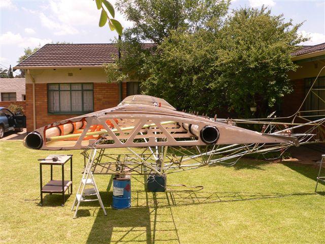

Both Wings on
bUSHBABY 016 (Small).jpg (82.39 KiB) Viewed 8277 times

Dash
bUSHBABY 019 (Small).jpg (28.32 KiB) Viewed 8277 times
Another Dash
bUSHBABY 022 (Small).jpg (29.09 KiB) Viewed 8278 times

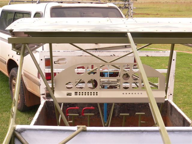

I spoke to Nico today and there is just something that I would like to point out to builders. Make sure that you have your seat installed(and upholstery) before starting your panel design. I find that with a thin cushion I can only touch the panel with my finger tips. This will be a probl for a short guy(like me) when your are strapped in with a 4 point harness, especially when you have an instrument that has a button to push that is situated far from the pilot seat. Plan your layout that all instruments that need manual input can be reached from both seats in the strapped in position. Happy building

Where did you get the panel cut?
Dusty Eagle
Posts: 127
Joined: Wed Aug 31, 2005 7:57 am
Location: alewynspoort
Re: Bushbaby Explorer # 130
Postby Dusty Eagle » Thu Feb 05, 2009 10:01 am
I had the panel cut at Metal Centres in Booysens.If you need a number, please pm me.
It was their first attempt without a cad drawing being prepared, but with a bit of time and fine tuning, panel # 2 came out exremely well.
The first panel was a little extravagant, in that we made it both too high and too low. The hight interefered with the windscreen and the low came a little close to the knees, workable, but I changed that as not all the space on the bottom lip is needed.
The seat and floor boards & pedals were in before the panel. The seat has 40mm sponge in and even with the new panel angled forward, I comfortably reach the Garmin 296 in its panel doc at the top.
We havent tried with seat belts yet as those supplied do not fit.
