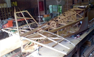

I started this project last year in August. It took me 3 years to decide what to build. I was going to build a Petenpol, but decided on a "LM5X-W" from Miniature light aircraft Co. in the US. The plans are full scale and come with a CD and 250 page instruction book.
I am using saligna as the main construction, and the paneling is marine ply. The fuselage and tail feathers construction is done. I have started with the controls, seats and inside panels. I will probably import the landing gear. When all is done, including covering, I will start the wings.
- DSC00269.jpg (76.9 KiB) Viewed 9541 times

This photo is the latest, but will post a few of the older ones. Had its first inspection yesterday. So I can now carry on, met fotos.

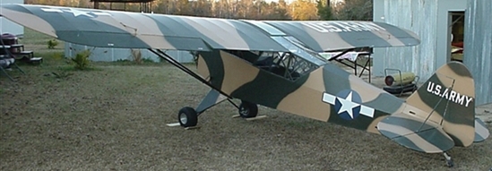

This is the best picture of the finnished project that I could find on the CD supplied. It is the military version that was built (note the extra observation area behind the skylight) according to Jane's "Vintage Aircraft Recognition guide" it was called a L-4/L-18 Grasshopper.
