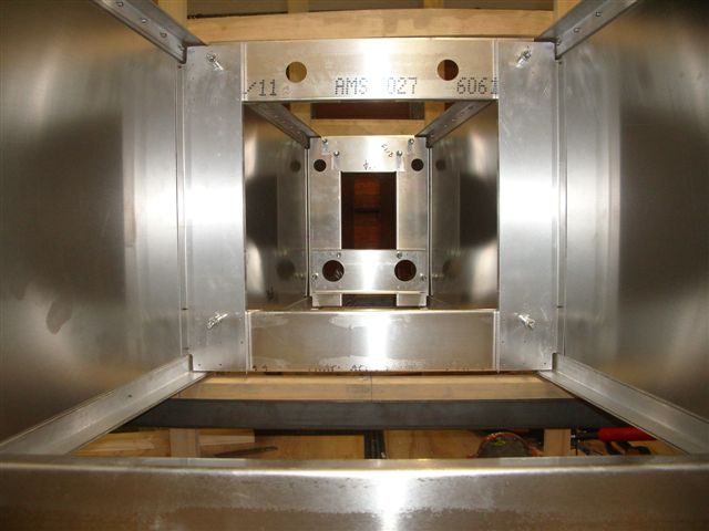

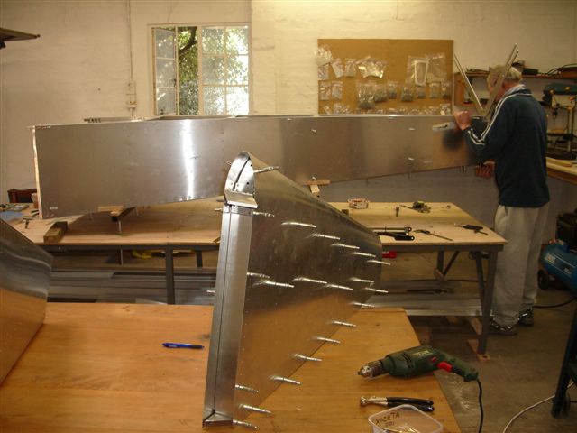

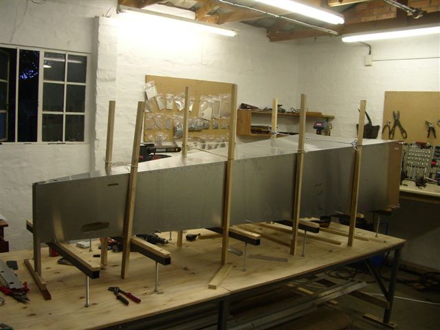

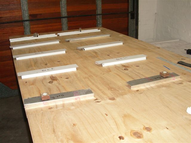

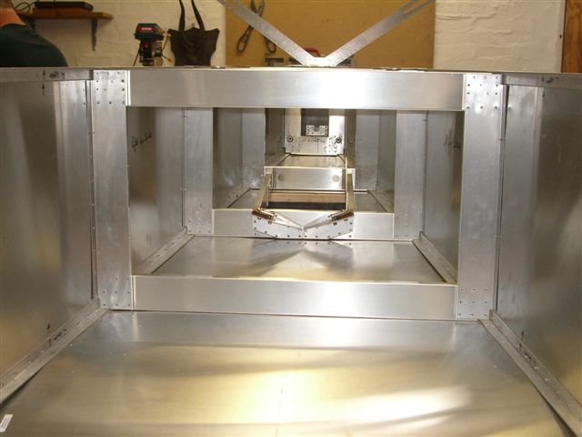

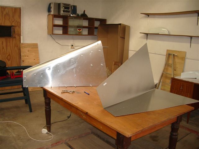

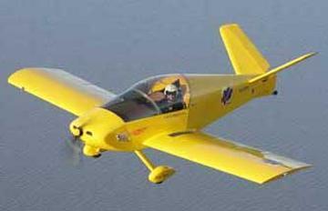

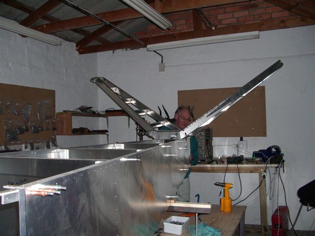

HI All
Cant seem to post info directly from the site, so herewith web info.
http://www.sonexaircraft.com/aircraft/waiex.html
Have a look, let me know thoughts.

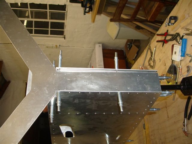

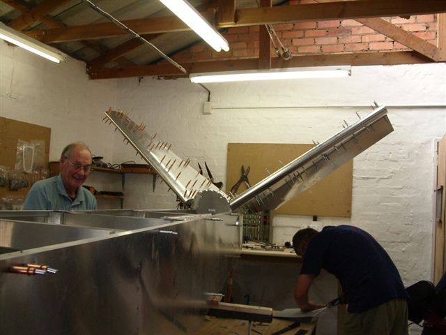

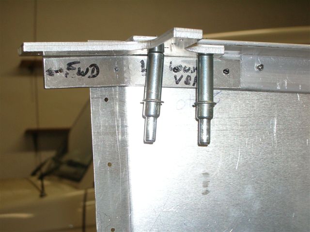

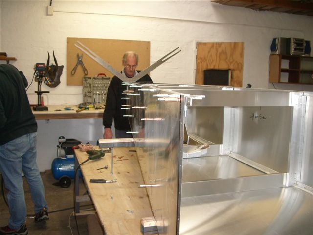

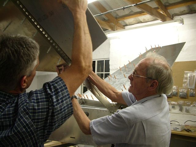

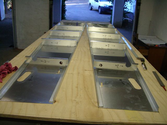

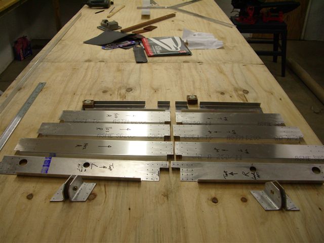

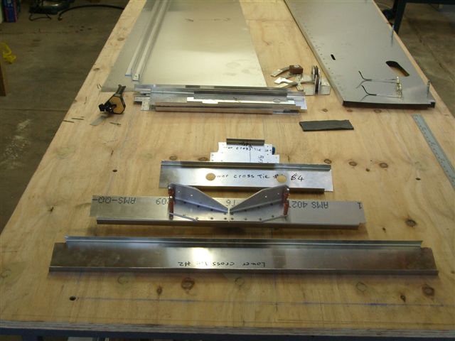

Build project going well, will post pics soon, fuselage well on the way, empenage almost complete, ready to be fitted.
Have chosen the Jabiru 2200 option, engine waiting for collection.
The way were going now, hoping to complete early next year, hopefully February

Good luck! - I've done a lot of surfin and in my opinion this plane/Sonex presents one of the best cost/performance ratio's out there and would be high on my list of "Wanted" aircraft.
With the Jabiru engined Waiex you've got a project that ticks a lot of my boxes:
- All metal plane so it should last loooooong
- Titanium undercarriage for those early "training" landings
- Compliance to the KISS principle
- Compliance to the "Build it light" principle (Sonex is one of the lightest kits out htere)
- Very Good cruise speed so you can go places
- Lowish stall speed so if the worst happens you get a good chance to walk away
- Excellent fuel economy from Jab engine
- It looks mean and aggressive and goes fast even when standing still!!!!

Hi Rudix and Miskiet
Sonex factory, plus extras leather upholstery, brakes etc- $16345
Shipping, vat, customs etc, R31577.00
Jegs for oil coolers etc $248.00
Wicks aircraft supplies $2314
So, about R165 K
Now I still need to get the jab motor - R90 K, prop and instruments.
Will probably put the mgl enigma, or latest version, still to be released, into the plane, with the mgl compatible radio. will have to look at a transponder as well, as will be visiting many new destinations in SA, and Moz, etc.
With regards strenght, there are lots flying now, without any break ups that I know of. THey have apparently been tested to Plus and Minus 11 !!
Thought the Sonex was not a great looking plane, but it grew on me, but I eventually preferred the look of the Waiex. All flight tests seem to indicate no difference in flying characteristics, so thought why not be a first?
Only one I know of that flew in SA, had an engine problem, and crashed with two fatalities. Other than that, one that I know of, flying in Zim. One in PE, ready for completion, but owner dragging his feet! Another, built from plans in Jhb, either finished or very close. Owner now working with CAA to get non type approval, a huge mission, but seems to be in hand, and coming along.
Another about 60 % in PE, being built by SA agent. Another one or two, being built in Bloem area.
I think two kits available in PE at the moment.
All Sonex, mine the only Waiex.

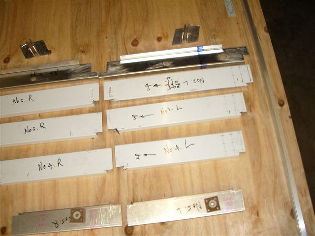

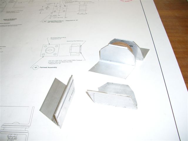

Quality of the kit very good, lots of work building brackets, cutting, drilling etc, but measurenments seem accurate. Sometimes a lack of an actual desciption causes confusion, and the plans can be difficult to understand.
About 3 monts from ordering, to leaving USA, and another 5 weeks to arrive at home.
Any more questions welcome, will keep posting as we go along.

Hi Larry,
There is another one in Secunda but it is a Sonex so maybe not of interest to you.
You seem to be moving along at a fair old pace and it seems as if in another 300 hrs or so you might be close to finishing.
Good workmanship, keep going you will soon have a super flying aerie.
Kind regards,
Gunter Rostek.

Hi Gunter
Is the one in Secunda finished, and or flying? I did hear of another one, somewhere up your side, that was for sale, I think with fuselage finished?
Maybe the same one?
I will be away for a week now, and will start the wings when I get back, while Jack, my co-builder, carries on with the turle deck, and forward fuselage
LM
