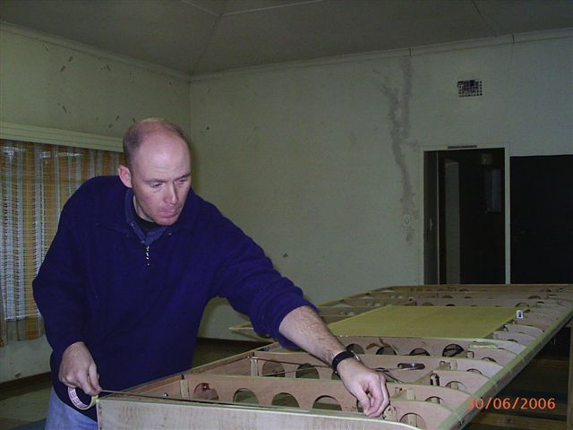

Busy putting on the tape. Damn there is alot of tape going on here !!!!!

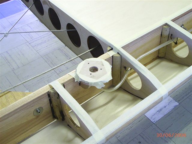

Pitot location masked up all edges
masking 2.jpg (54.74 KiB) Viewed 8740 times
Masking up all the sharp edges so i can start to cover

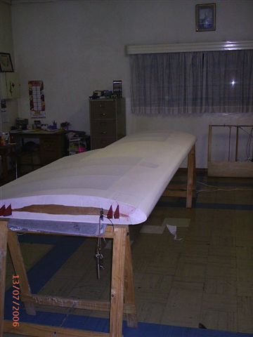

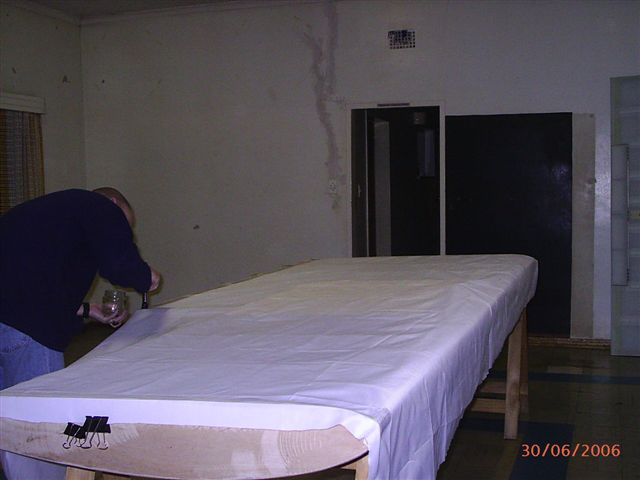

Starting to tack the material in place, damn shoulda been sucking on the glue sooner. had a major headache in 20 min after starting.
slapping on glue to hold in place.jpg (36.66 KiB) Viewed 8710 times

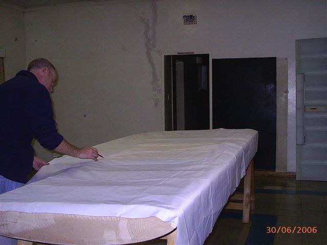

Making pencil markings so if the covering moves i can move it back
marking locations.jpg (36.48 KiB) Viewed 8697 times

Postby Tailspin » Thu Aug 10, 2006 12:23 pm
Will do
In the last photo there is a glimpse of the horizontal stab, waiting for the coats of butrate and alu-paste.

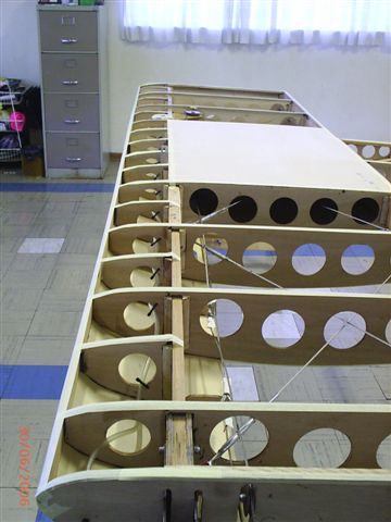

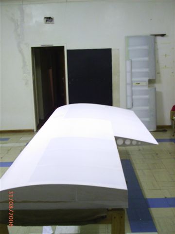

Here is the first wing ready for the tapes and rib stitching etc.
Another View.
Covering VP wings 4.jpg (21.59 KiB) Viewed 8514 times
Still stressing alot but it is really starting to get exciting seeing it all come together.
Covering VP wing 1 .jpg (25.94 KiB) Viewed 8510 times
