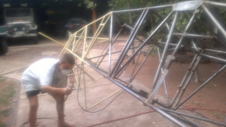

Postby avgas » Mon Apr 27, 2015 10:08 pm
day 1
sonerai small.jpg (28.62 KiB) Viewed 22989 times

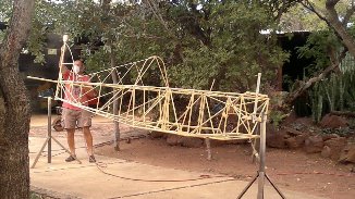

Postby avgas » Mon Apr 27, 2015 10:10 pm
small 2.jpg (36.88 KiB) Viewed 22989 times
