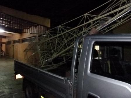

Postby Mozfly » Sun Nov 18, 2012 4:24 pm

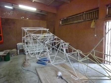

Off Loading after the long process of importing
Off Loading

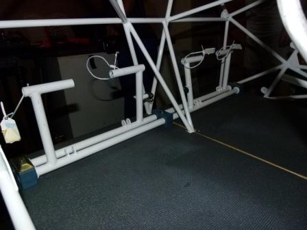

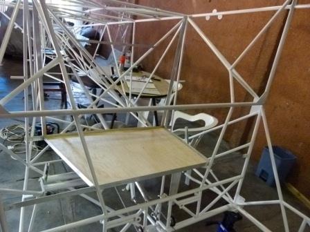

Floor boards in :)

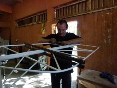

Postby Mozfly » Sun Nov 18, 2012 4:31 pm
Centralizing the elevator and then the elevator in operation vhpy

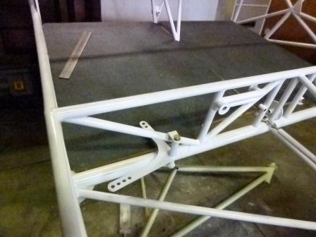

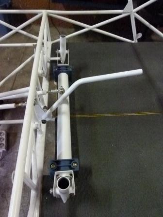

Control column and flap fitted. Spent time on the brass bushes to ensure no play. Had to take about 1mm off the bearings to get a snug fit. Fitted the flap lever with a M8 bolt and lock nuts and not a nylon bush with M6.

Ailerons and Flap mixers installed. Needed to ream out the bushes on the fuselage alot due to the weld "crimping" the bush but after installed with the bronze bush and shimmed it with one washer each side, got no play at all. Spent time on the nylon bush in the flap mixer to the aileron mixer. The inner nyloc was countersunk and after fitting locktite it was a mission to tighten up till the bush swelled and bolt not turning. Got no sidewards or upwards play and turns freely, feels good to me.

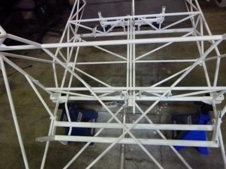

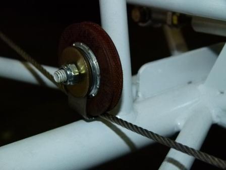

Rudders pedals dry fitted.

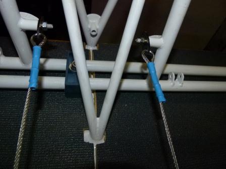

Postby Mozfly » Sun Nov 18, 2012 4:51 pm

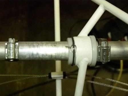

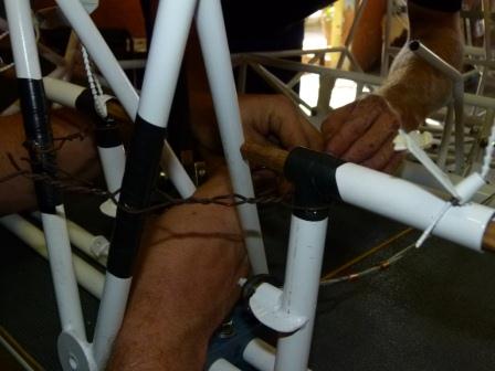

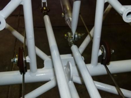

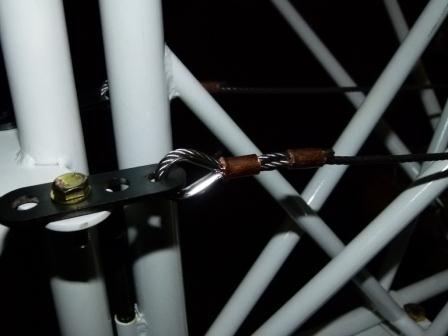

Rudder cables installation and working! vhpy
Done with all the controls now
Laying the cables
Rudder cables crimped first
Setting up for the front crimping
Job done!
Bracket made for cable roller guide

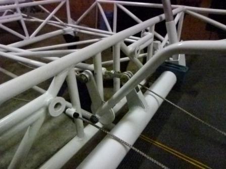

Not too keen on leaving these clamps as stoppers for the elevator. Going to remove them and make cable stoppers on the control arms under the seat. Will put a pic of that when done and then take a final decision. As it stands i think i already know what option to go with!

Dry fit of luggage box. Starting with the second luggage box and should be done in a day or 2. Will put pics on the final luggage box.

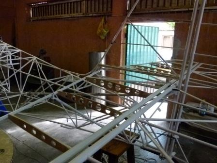

Postby Mozfly » Sun Nov 18, 2012 4:57 pm

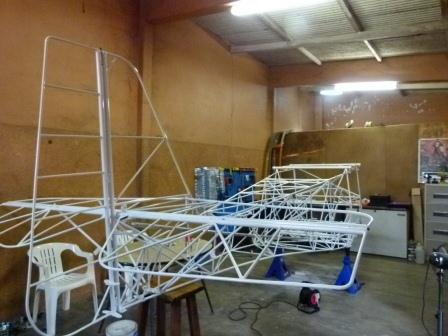

Ribs done for the tail, dry fitted. Still to fine tune and epoxy.
