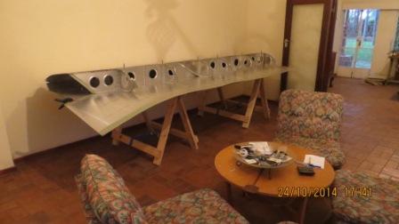

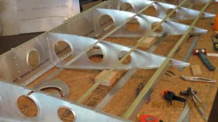

83C Left wing anti oil canning channels fitted.jpg (31.94 KiB) Viewed 20472 times
83B Left wing rear channels fitted.jpg (31.25 KiB) Viewed 20472 times
83A Left wing raer ribs fitted.jpg (29.99 KiB) Viewed 20472 times
83 Left wing Spar.jpg (28.08 KiB) Viewed 20472 times
82A Right wing waitng for fuel tanks to be installed.jpg (27.95 KiB) Viewed 20472 times
82 Right wing upper strut bracket.jpg (26.03 KiB) Viewed 20472 times

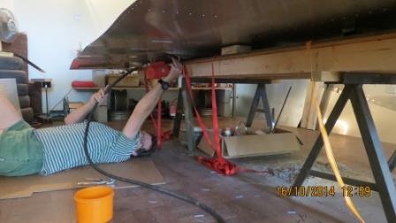

81E Riveting nose skin.jpg (30.42 KiB) Viewed 20472 times
81D Nose skin clecoed in position.jpg (27.15 KiB) Viewed 20472 times

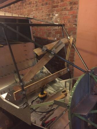

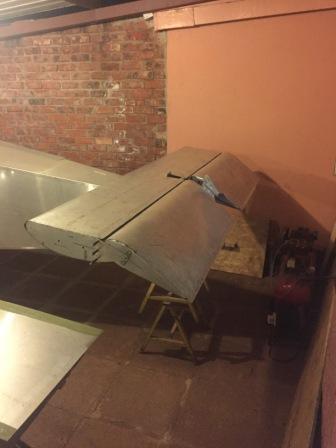

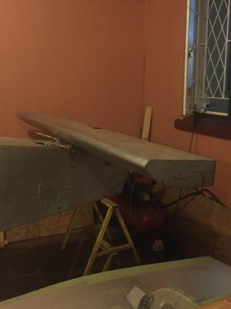

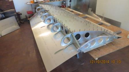

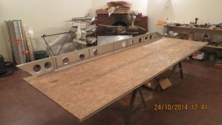

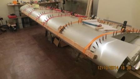

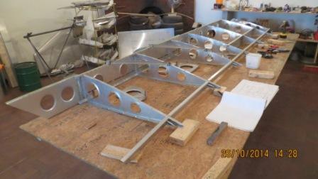

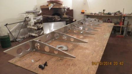

Here with an update on the build. Right wing is as far as I can go as I still have to make up the fuel tanks. Plan now is assemble the left wing upto fuel tank instalation stage,have both wings inspected and signed off for closing up.In the mean time here as some photos of progress. Building the 2nd wing is so much easier than the first wing. Actually had a good laugh at how I struggled to build the first wing as compared to how easy the 2nd wing is coming together at this stage.

I had to laugh when i saw the second last Photo. They (whoever they are) say that only mechanics and prostetutes lie on their backs and work. vhpy vhpy

:lol: Ranger I think I need to respond pronto here before our members go off topic seeing me enjoying WORKING (**) lying on my back :lol: :lol:
For the record you are 100% correct, I am a motor mech by trade, not as glamours as the other trade you mentioned.

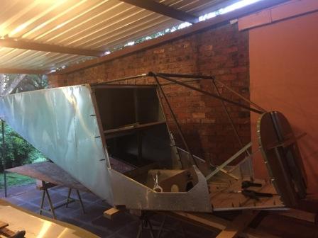

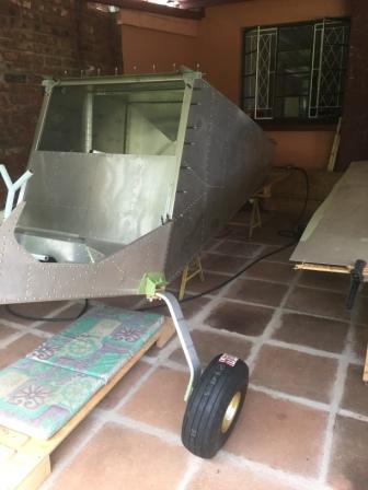

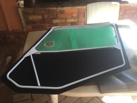

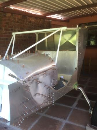

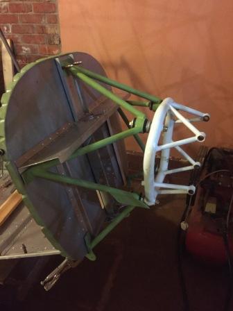

A big hello to the guys following my build and pushing me to update my build blog and apologes for not keeping the posts current.So here a quite a few pics of the build.
I have been a little slow as I am doing my PPL at Executive Air based at Charles Prince, Zimbabwe for those who dont know where CP is located, at the same time. This morning at Exec flight school was a big morning for me as I went solo this morning.
Right back to the important topic, the build.
Z-MRP

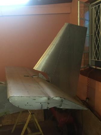

93B Rear Emapenage.jpg (22.24 KiB) Viewed 19604 times
93A Rear empenage.jpg (24.62 KiB) Viewed 19604 times
93 Rear empenage.jpg (20.55 KiB) Viewed 19604 times

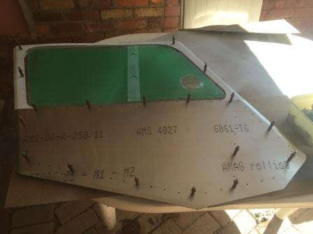

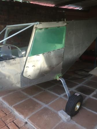

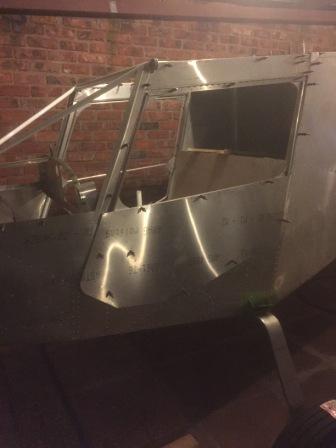

92C Cabin door complete outside.jpg (22.28 KiB) Viewed 19604 times
92B Cabin door complete inside.jpg (24.49 KiB) Viewed 19604 times
92A Cabin doors.jpg (27.01 KiB) Viewed 19604 times
92 Cabin doors.jpg (23.11 KiB) Viewed 19604 times

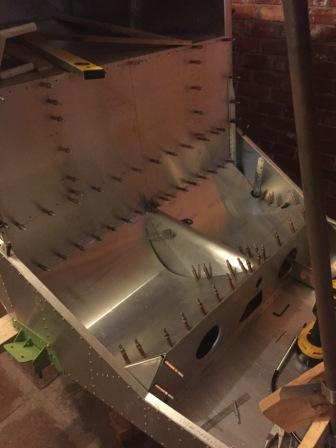

91 Forward top skin fitted.jpg (30.93 KiB) Viewed 19604 times
90A Front side skis clecoed.jpg (28.57 KiB) Viewed 19604 times

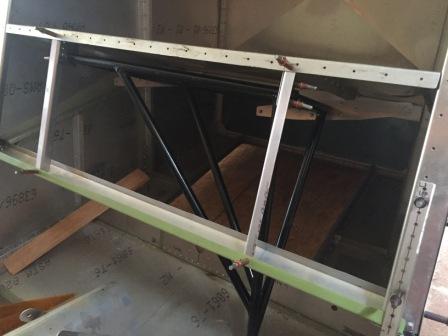

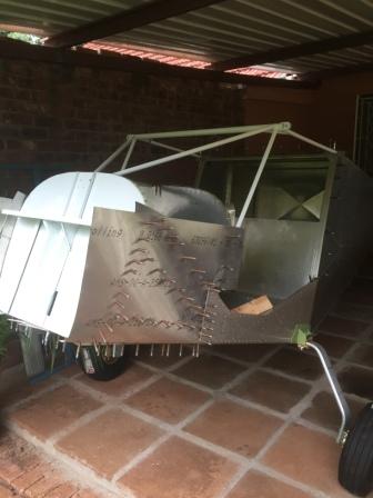

89 Final Cabin frame fitting for welding.jpg (31.08 KiB) Viewed 19604 times
88 main gear fitted.jpg (28.91 KiB) Viewed 19604 times

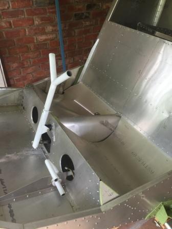

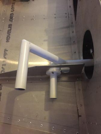

87 Centre stick mounted.jpg (27.34 KiB) Viewed 19604 times
86 Flaperon control mounted.jpg (22.21 KiB) Viewed 19604 times
85A seat paneling.jpg (26.15 KiB) Viewed 19604 times
85 Rear seat frame and Flaperon frame mounted.jpg (28.14 KiB) Viewed 19604 times
84B FWF anf Rotax ring mount.jpg (25.66 KiB) Viewed 19604 times
84 Joining Forward and Rear fuselage.jpg (30.18 KiB) Viewed 19604 times
81D Nose skin clecoed in position.jpg (27.15 KiB) Viewed 19604 times
81B Right Wing nose skin fitted.jpg (27.97 KiB) Viewed 19604 times

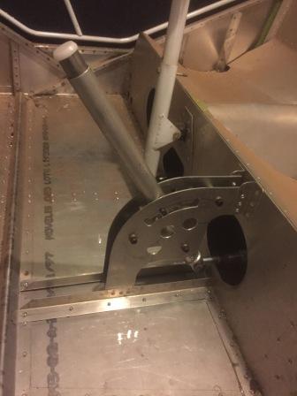

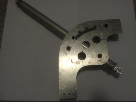

95C Upgraded flap control.jpg (26.34 KiB) Viewed 19320 times
95B Upgraded flap control.jpg (18.44 KiB) Viewed 19320 times
Work has started again on the build now that I have a little bit more time to spend on building.Just completed the upgrade 4 position flap control.Took a bit extra time to make as no drawings available so worked from a photograph of this upgrade.

Hi MRP
Good to see you are still building. The end is getting closer (^^)
Did they change the flap degrees with the new plate
Groete
Goose
Z-MRP
Posts: 190
Joined: Fri Jul 25, 2008 11:35 am
Re: CH 701
Postby Z-MRP » Fri Oct 14, 2016 2:40 pm
Hi Goose, following the Zenith video of this upgrade the total flaps is still 15deg but now have the option of 5 and 10 deg.
With the original flap control it was 0 or 15 deg only.
I know the savanah goes into higher flap deg numbers but I have stuck to info that was given in the video promotion of this mod.
To buy the mod is expensive $355.00
Having plenty materials left over this mod cost me not more than $20 and a few hours sceeming how to make it.
