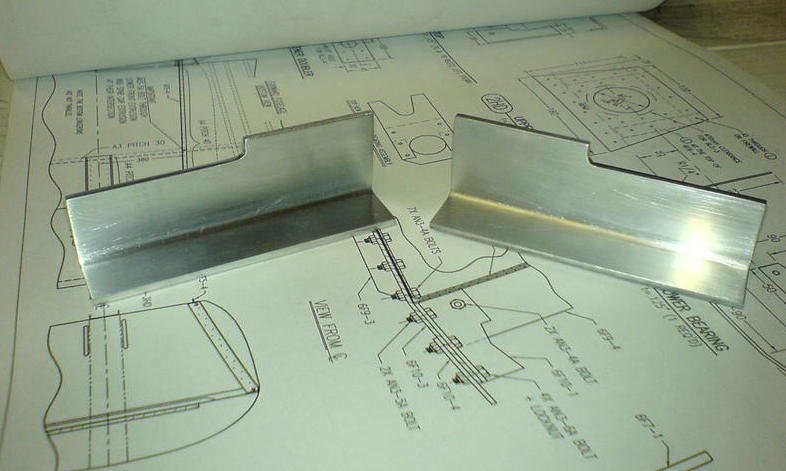

Wow - I am developing new respect for scratch builders. I have just spent 1.5 hours working on ONE bracket, and it isn't even finished yet!
measure, measure (and measure again, just for luck), cut, file, polish. Lather, rinse, repeat...
Two more cuts, and it is ready to be match drilled. Make the next, and I can re-fit the nose gear.
How long must it take to build an entire aeroplane like this? Someone has a lot more patience than me

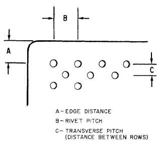

Spacing and edge distance
Rivet spacing, also referred as rivet pitch, is the distance between the rivets in the same row, and is measured from the rivet center to the rivet center. Transverse pitch is the distance between the rows of rivets, and is measured from the rivet center to rivet center. Edge distance is the distance from the center of the rivet to the edge of the material being riveted. Figure 13-43.—Rivet length. There are no specific rules that apply to every case or type of riveting. There are, however, certain general rules that should be followed.
RIVET SPACING.—Rivet spacing (pitch) depends upon several factors, principally the thickness of the sheet, the diameter of the rivets, and the manner in which the sheet will be stressed. Rivet spacing should never be less than three times the rivet diameter. Spacing is seldom less than four times the diameter nor more than eight times the diameter.
TRANSVERSE PITCH.—When two or more rows of rivets are used in a repair job, the rivets should be staggered to obtain maximum strength. The distance between the rows of rivets is called “transverse pitch.” Transverse pitch is normally 75 percent of existing rivet pitch, but should never be less than 2 1/2 times the diameter.
EDGE DISTANCE.—The edge distance for all rivets, except those with a flush head, should not be less than twice the diameter of the rivet shank nor more than four times the diameter of the rivet shank. Flush-head rivets require an edge distance of at least 2 1/2 times the diameter. If rivets are placed to close to the edge of the sheet, the sheet is apt to crack or pull away from the rivets. If they are placed too far away from the edge, the sheet is apt to turn up at the edge.
NOTE: On most repairs, the general practice is to use the same rivet spacing and edge distance that the manufacturer used in the surrounding area, or the structural repair manual for the particular aircraft may be consulted, Figure and edge distance. 13-44 shows rivet spacing .

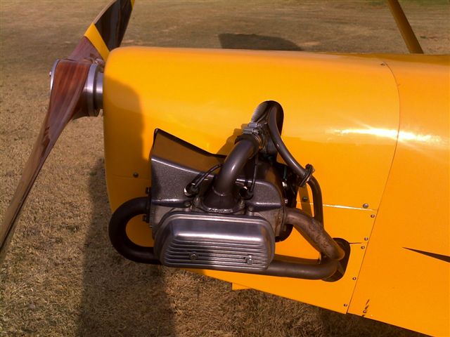

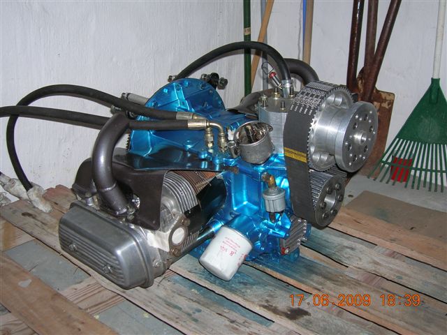

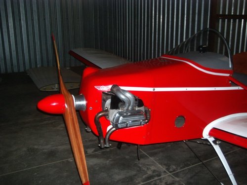

Boet and Justin I am posting pics of the cubby VW with it's cooling baffels. I would like your opinion on this setup. Is this effective or can it be improved . I must say that we have no problems with our VW (touch wood). she runs very cool (between 60 and 75 degrees). I dont really unnderstand what is required in sofar as cooling. Boet can you please draw on my pics to show where the air is supposed to come in and where it is supposed to exit. Why are the baffels on the top but nothing on the bottom. what is the purpose of the black plate in the front on the cooling fins. Also does it make a differnence that on the cubby the entire cylinder head sticks out into the airflow and is not hidden in the aengine cowl.

OK - back from my holiday. Started out as a long weekend, but accidentally booked an extra night. Got up Wednesday morning, and it was so great, I said ---- this, and booked the rest of the week. So I spent the last week passed out on the beach or snorkelling, and no time building...
As to the lack of bottom baffles, I don't know. Everything I have read says that this is a big no-no, but perhaps the strong airflow under the cylinders creates sufficient suction that this is not required?
I hope Boet jumps in on this too, but I will try to comment from the reading I have done. Firstly, the top baffle looks great - it seems to seal very well all the way around, which is very important. The front baffle is generally used to stop the front cylinders from getting too cold - they have a LOT of cooling air hanging out in the breeze like that. Many cowled installations also end up with a small plate partially shielding the front cylinders, so keep them at more-or-less the same temps as the rears.Giarc64 wrote:Boet and Justin I am posting pics of the cubby VW with it's cooling baffels. I would like your opinion on this setup. Is this effective or can it be improved . I must say that we have no problems with our VW (touch wood). she runs very cool (between 60 and 75 degrees). I dont really unnderstand what is required in sofar as cooling. Boet can you please draw on my pics to show where the air is supposed to come in and where it is supposed to exit. Why are the baffels on the top but nothing on the bottom. what is the purpose of the black plate in the front on the cooling fins. Also does it make a differnence that on the cubby the entire cylinder head sticks out into the airflow and is not hidden in the aengine cowl.

More than enough,Vp had the same. Just make sure the little plate between the cylinders at the bottom is in its place!

Yes I agree, the little plate at the bottom ensures that the cooling air flows AROUND the cylinder fins, instead of just straight thru the middle and out. The bottom half of the front cylinder therefore have to have a baffle plate as well. Theoretically...... for I have seen VW installations like the cubby and the red VP in the pic, give many years of trouble-free service. You decide.

Thanks Boet Justin and German for your opinions.
The volla on the cubby is very happy at this stage (touch wood). My only real concern is the belt drive. will be changing the belt every 50 hours. Hope you get the yaris convex right boet, then i will be one of your 1st customers. Clive who owns cubby zu-djz in witbank is keen on building a raven and the yaris should be very suitable for that.

Whee! Just finished fabricating my first aluminium brackets! Lots of schlepp and false starts, but done, and ready for match drilling. Hope I don't stuff them up now!

Here are the results of my efforts so far. Ran out of fine sanding pads, so still some scratches left, but will take care of them when the brackets are drilled and deburred:
Not a hell of a lot to show for 3 evenings of work, but things are going quicker as I get some practice...
