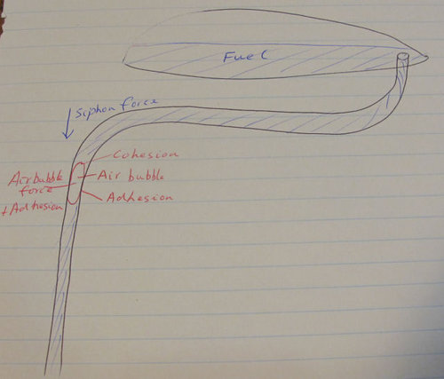

Anybody working with fluids and pipes must understand the concept of cohesion and adhesion. Let us define “cohesion” we are familiar with cohabitation or living together. It is the force that keeps similar molecules together if you take a water droplet in air the fact that the droplet is round is the effect of the cohesion forces. That is thus water in air. If we have a gas or air in a fluid and take for example your sodastream bottle then we again have air or CO2 bubbles these bubbles form because of the cohesion forces.
Now lets look at adhesion, take adhesive the concept of sticking objects together. Now when we combine these forces, we see how water droplets can stick to a leaf and we have a wonderful combination of cohesion and adhesion both working. I got a photo on the net from Wikipedia of a leaf with water droplets on it, it is a superb example. Now if you take these principles and put fuel inside a pipe and put an air bubble in it , and the right conditions then with adhesion and cohesion you have the making of an old fashioned air lock. More tomorrow on practical examples and how to fix it.

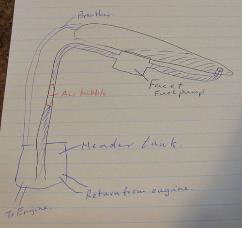

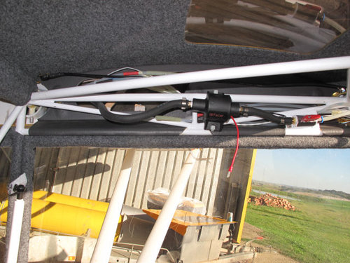

The saga of cohesion and adhesion continues. We will look at a more practical application of these principals. If you look at photo one, the air bubble and the siphon column of fuel is in equilibrium. The result is no flow and stagnation can occur and the result is fuel starvation. Something we do not like in aviation . We like the motion potion to flow freely. If there is the slightest possibility for stagnation of fuel flow a fuel pump should be added in line. Tail draggers are more prone especially the Bushbaby due to the way the fuel lines run and the rear pickup in the tank. So if you have a fuel installation look at it critically and visualize where can adhesion and cohesion with an air lock cause havoc and if there is any chance pump it away with the installation of an inline free flow pump, the action of the pump is just to start the siphon function . Once the flow is activated the siphon flow will continue without the pump action. This is the reason why the Bosvarkie has two inline pumps. I was not happy with the siphon characteristics of the design. I hope the readers of this site will have bubble free gravity fuel systems. Comments are welcome and readers opinions and experiences will enhance aviation safety. Remember 80% of engine stoppages are fuel related.

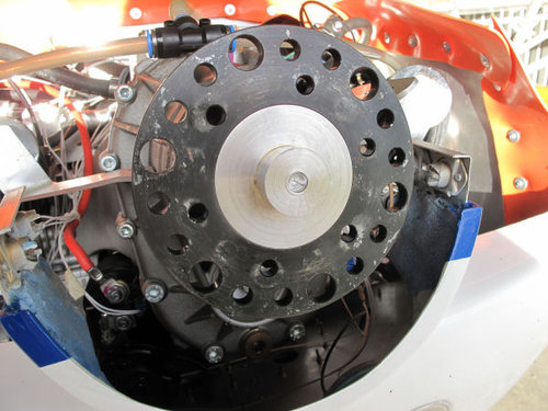

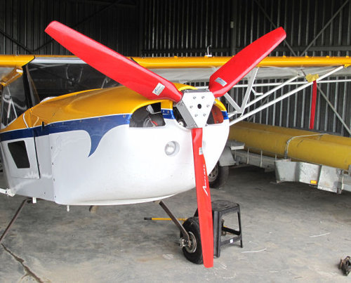

I did a very interesting test today . One of the 912S's on the DTA trike that we fuel injected has a Arplast prop on it and because the 912 turns in the opposite direction then the BMW I could use the pusher prop of the trike and put it on the Bosvarkie. The 912 has a reduction box of 2.43:1 and on that setup the static revs are 5400rpm with the BMW reduction of 3.2 :1 the theoretical equivalent revs are 7111rpm. When I test ran the engine with the Arplast prop the engine ran to the rev limiter of 7200rpm. Being the same prop with the same pitch I can make the statement that the BMW gives the same power as the 912S maybe even more. This was a very exciting test. The less exciting is that my Woodcomp prop cannot absorb the power the BM delivers luckily WoodComp makes other blades and I will talk to the people to-morrow. The problem is that when I set the variable prop so that the engine does not run away , the pitch is so course that the prop cavitates. But with careful testing we will get the correct prop engine airframe combination. Boet is sending me a De Necker wooden prop and I will test that as well. I will also do a pulling test. More tomorrow.

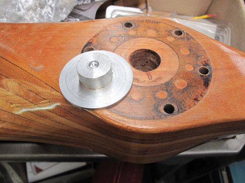

Today I documented the data we tuned on the Eboxi's and took a photo of the Arplast prop.The results of this test was given on the last posting.

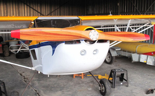

This nose job did not improve the aesthetics of the Bosvarkie. To-morrow I'm getting the de Necker Prop for comparison. It will be interesting testing. I have to do all these things while I'm awaiting the paper results from CAA. Enjoy the picture

Oupa, en hoe vliee hy met daai rooi prop??
Boet jy weet mos ek kan nog nie vlieg nie wag nog vir die pampiere

The other exciting thing is that I today fitted the Pieter de Necker prop, now Boet has been quietly breathing down my neck about this wooden plank and sometimes also not so quietly. Now I promised to do honest reporting and I was not happy with the performance of the variable pitch prop. I tried the Arplast the engine overpowered it and the prop must go back to its trike. So the wooden plank was test run and what a wonderful experience it was like a horse with a swarm of bees up its backside. The Bosvarkie wanted to get airborne on the taxiway. The BMW 1200GS is giving similar performance as brand X. We must now work on the reliability side which is hard to beat but something to strive for. The benchmark is set very high. Enjoy the pics.
