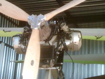

Air Hog, I used the throttle cable junction box that came out of the bike. It works like a charm. See pic.
- IMG_0045.JPG (94.77 KiB) Viewed 5869 times

Hi Boet, using the same. The cable I am getting is the one from the Throttle box to the lever.Boet wrote:Air Hog, I used the throttle cable junction box that came out of the bike. It works like a charm. See pic.

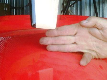

Progress is slow. My Auto-electrician did not pitch... again... so had to do it myself. Have put the pod back today and it is starting to look like an Aerie again. Also fitted the prop to check clearance and it looks 100% Will finish the electrics on Tuesday and will then be ready for start.
