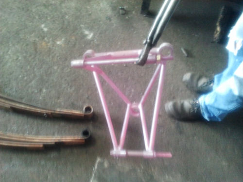

Here is the Trike's new engine mount "hot" of the press in the famous "Pienk or also referred to as cherry red " So now for the painting.

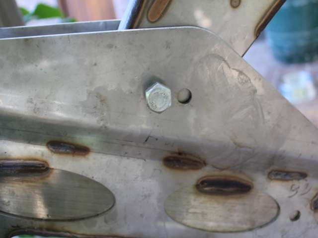

After my little mistake with the CFG calculations, I drilled a new set of holes for the pylon bottom hole and drilled the final hole in the pylon.

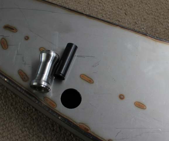

Next was a stop over at Gerrie. He added the last bush, a pipe for the wires and the end caps to the pylon.

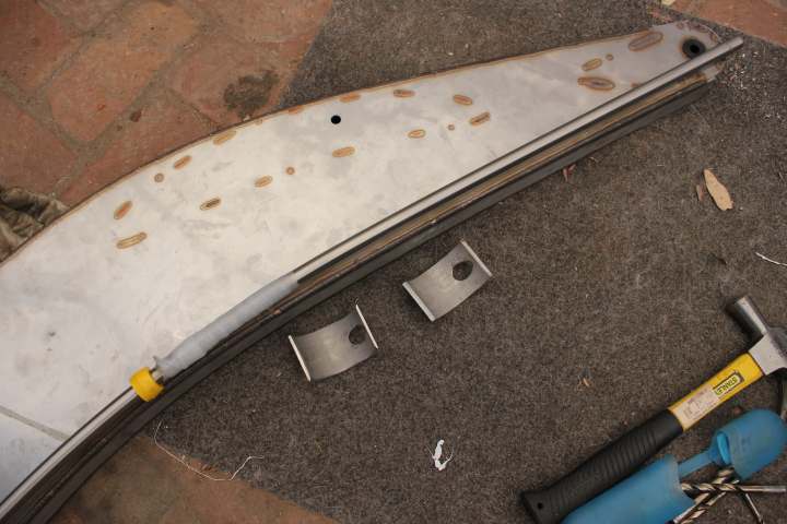

The photo above shows the pylon with the last couple of pieces that must be added. The pipe will be inserted inside the pylon and will be used to lead the wires to the antenna and the actuator. The other 2 half round pieces will be welded on to the ends of the pylon.
The end result will be completely sealed pylon. I will add a car valve to the pylon and inflate it slightly. One of my pre-flights will be to check the pressure in the pylon to ensure that it does not leak. By the way, this is not 100% original because they use it on aerobatic earoplane s and in some helicopters, but it might be the first trike with a pressurized structure.
The white and yellow that you see around the pipe is polyuthethane rubber and silicone tape. That is to ensure that the pipe does not vibrate inside the pylon.

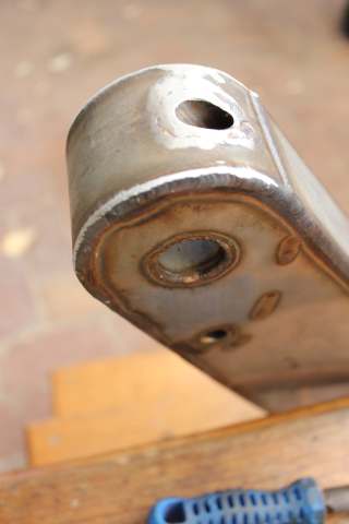

This is the top end of the pylon after welding. The wire exit from the pylon can be clearly seen. The wing mounting hole can also be seen. The hole is about 25mm. A nylon bush will once again be inserted so that I do not have a metal on metal contact.

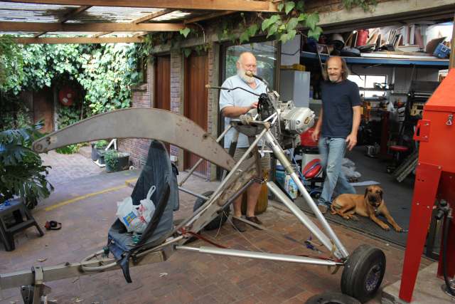

The engine was fitted this weekend. Now it at least feels as if it getting somewhere!
On the photo below Oupa-G is giving a hand. Jo helped to do the heavy lifting and hold the engine in place while Oup fitted the bolts. Jo is also taking the photo - thanks Jo.
As you can see my Ridgeback is also giving moral support. (They say you always know where your Ridgeback is, exactly where you want to put your foot when you give a step back. )
