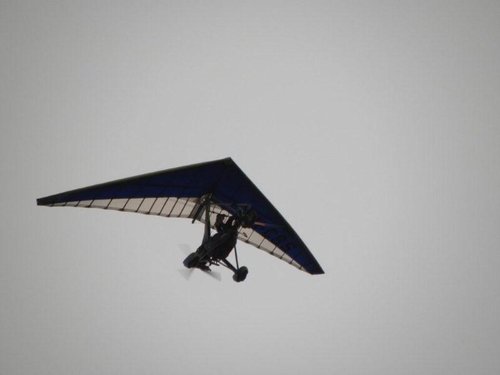

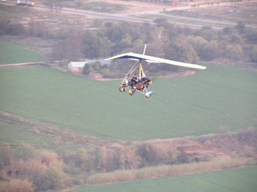

Almost There,
Thanks to all involved at CAA, RAASA and our AP (Johan) from Rustenburg for his extra inputs we've received our temp. ATF in record time! vhpy vhpy vhpy vhpy vhpy vhpy
We did our first tests at ODI and what a blast! vhpy vhpy vhpy vhpy vhpy
After some crow hops and one flight we packed up to do some small adjustments, will be back next weekend for some serious testing!
No stats available at this stage, but the "ToyoCobra ZU CSS" sure has some serious power! It Takes off with a blast and one's got to refrain from putting foot when taking off.
Some fodies below.
Powered Takeoff
First Landing
Can't wait for next week end, Hope the weather holds.

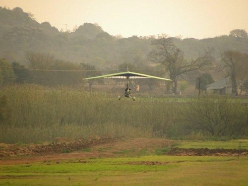

Hi all ....
Thanx Demon, It's been hard work, but worth if .... vhpy
Some more pics taken over the past weekend 8)
All looks goods so far !
