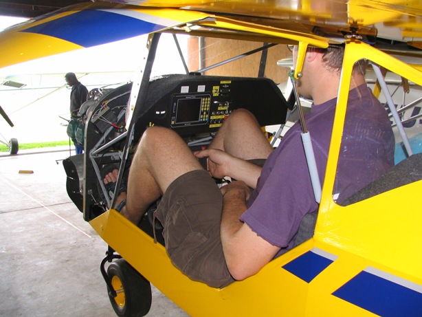

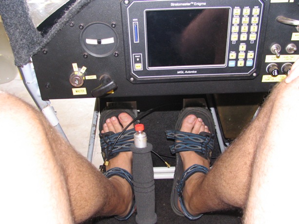

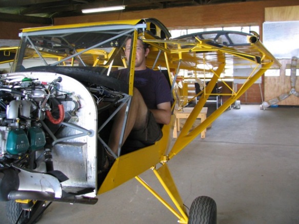

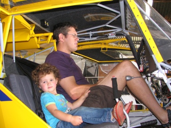

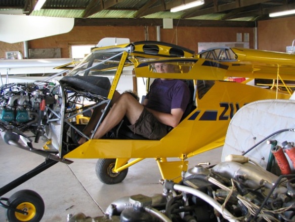

Postby AndyCAP » Fri Sep 26, 2008 7:56 am
Hi Oupa G. Sorry for the late reply - been a bit busy this week!
I used to be a member of TMFC just outside Durbanville and have very fond memories of a certain yellow Franklin powered Cub popping in for a visit with a little jack russel perched on the parcel shelf in the back. I was there the day when that Cub (pilot shall remain nameless! :twisted: ) flew in formo with a 1/4 scale RC version flown by Johnny Calefato. In fact my godfather should still have some pics of that! I was very fortunate to get a flip in NAM from its current (?) owner from Petit about two years ago - was a cramped :oops: but awesome experience!
Andy you are 6"7 i'm 6"2 I'm sure you will fit you must remember the engine is coming forward which will give a lot of firewall space.
Has the firewall (and pedals) actually moved forward relative to the seat backrest? I refer you to the attached pic of myself sitting in a BB Explorer. From what I can see on the pics I presume the design of the Safari's structure is indentical to that of the Explorer? Looking at the explorer. I really looked closely at the explorer trying to figure out if I could move the pedals forward and even possibly build a foorwell forward into the firewall . I think its possible but not ideal since it will mean that the whole pedal assembly would have to be mounted in front of the firewall tubular structure. Alternatively it could only move about 25mm forward. if the Safari has about 5cm or more legroom it will be VERY helpful for a langat like me!
Keep up the good work!
PS I see the advantages of the centrifugal clutch, however it does imply that its another item to check for wear. If it starts slipping, its as good as a partial engine failure. :shock: The other disadvantage is that you cannot propswing it -..errr.. well you can, but only the prop will spin like a windmill and the engine will remain deathly silent...... :twisted:
AndyCAP
Posts: 236
Joined: Wed Sep 14, 2005 1:04 pm
Location: FAFK
Postby AndyCAP » Fri Sep 26, 2008 8:01 am
Another three pics showing the squash!
Sorry for the slight highjack - as compensation you can use me as a test dummy for size comparison when the Bosvark is finished :wink: :lol:
PS NOTE these pics were taken of me sitting in an EXPLORER! :roll:
PPS I have posted these pics elsewhere before - so apologies for those who have seen them before :oops:
