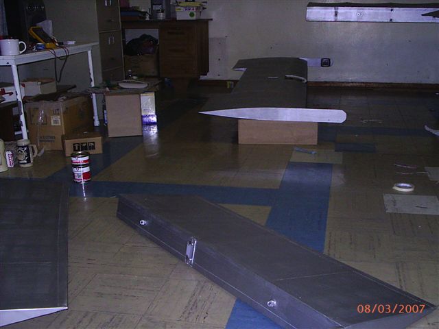

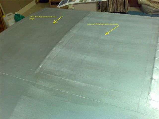

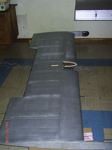

Postby Tailspin » Fri Jun 01, 2007 9:56 am
Hi Guys
Just a quick update.
Started to Finish the second wing. Here you can clearly see the difference of the coats of Butrate with the Alu-paste mixed in. Will post more pic's as i get further.
Two coats of Butrate.
Postby Tailspin » Fri Jun 01, 2007 10:01 am
Here you can see the first layer of Butrate with the paste soaking into the fabrick.
1st coat of Butrate with Alu-Paste
1st Coat Butrate with Paste.jpg (58.36 KiB) Viewed 2943 times

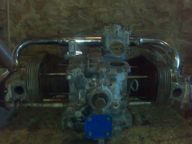

Postby Tailspin » Tue Jun 05, 2007 2:34 pm
Hi All
More news.
Assembled my VW motor and now i start the final Fidgeting stage where you try to make everything work in harmony and then you try to build a cowling around the beast. The pic's are a bit dark but well it was late and i hadto take a pic quickly cos Baby tailspin was getting upset waiting for me.
The Beast. Sorry pic is very Dark will take another one ASAP.
engine front.jpg (51.93 KiB) Viewed 2922 times

I am really glad that you are in the final stretch and see that you have build up an 2l engine so you should get much more power and torque.
Just be sure to put those little air dam plates on the bottom of the cylinders in place to make sure you get proper cooling.
Fit some eyebrow cheeks a la J3 and make sure air can be forced
through the cylinder heads. The weak spot is the exhaust valves on volas
so that area needs much care and air.
http://bobhooversblog.blogspot.com/2006 ... parts.html
See this blog fr some really good info.
Kind Regards
Gunter.
