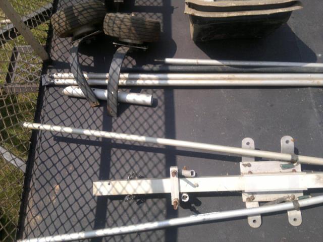

To think I rented & pulled a one tonne trailer 350kms for this... I actually went for something else, but the seller was kind enough to offer this as a alternate at a reduced price as I would not have used half of the other stuff I originally intended to purchase.
Stripped everything yesterday and started to fit the new wheels. I actually wanted bigger wheels, but ended up with original stock standard KR2 wheels & brakes in the end. At least they'll have much less drag & they are in a very good condition.
The only thing I would like still is proper rubber vibration dampers for the engine mount. If anyone has some lying around, I would like to purchase from you please. Also, if anyone has a square tube microlight main kingpost (similar to the one in the pic) lying around, I would like to purchase from you as I'll most probably need more of this. I have been told that the longer prop will put a lot of strain on the firewall & I want to make sure that the engine cannot twist the main mount under full load.
So, finally I've started working on her.

Hi Henni,Henni wrote:Ha!
Cheers all,
Henni
Glad you have started!
I am sure the standard wheels will be fine, she will never really be a rough field plane so you might as well go for the drag reduction. Are the brakes cable operated?
If you attach the engine mount at the same points as the original you will be fine, many guys are running vastly more power than the original using the standard firewall without any issues.
Have fun!
Rudi

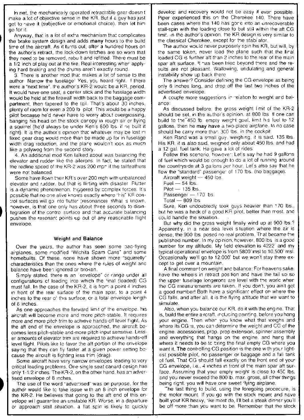

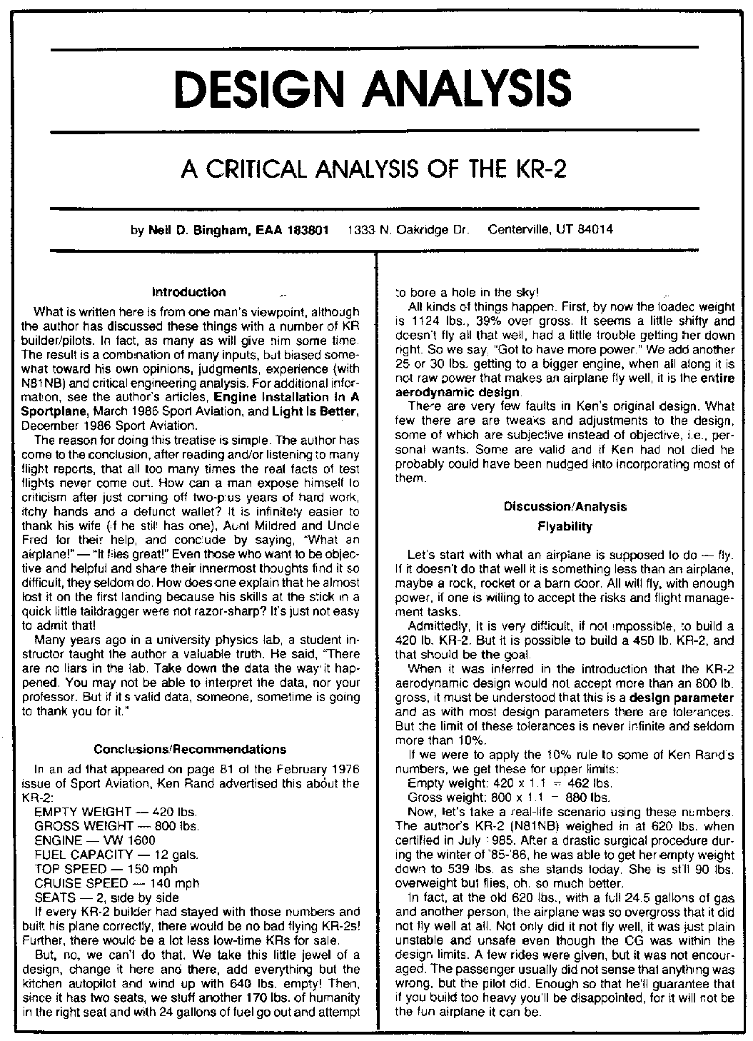

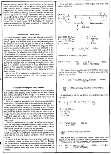

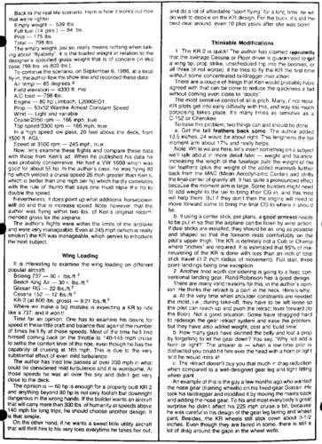

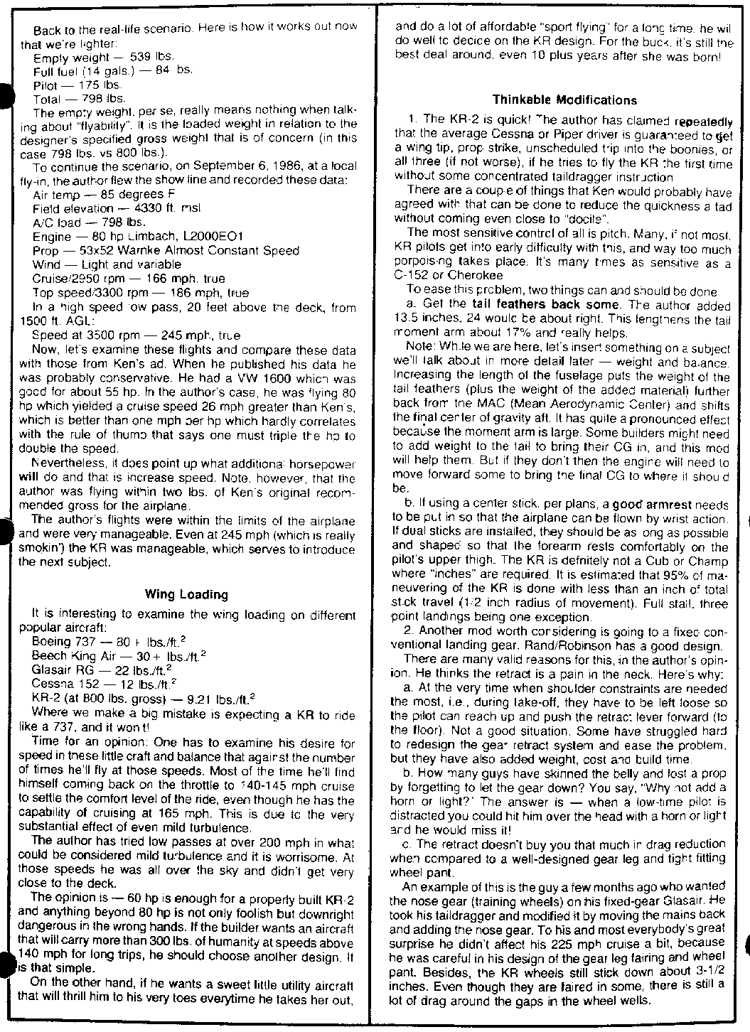

Included: Some nice reads I've collected over the years. If the attachments difficult to read, you can read original over
1.Here
and really also
2. Here
All the best mates,
Henni
This is why I need more material - to get the loads transferred to those attach points. However, thought about it last night & think I can come up with a plan using what I have.
Yes, the brakes are cable operated. Don't think you'll find anything fancy on this KR2 when completed. It'll be as basic as Ken Rand initially intended for it to be.
I have a few thousand KR2 pics I've collected over the years. It is so nice to put these on a flash drive, insert into our TV and scroll through all of these before going to bed. Only this time I'll join the other enthusiasts rather soon. Life is good & it keeps on getting better...

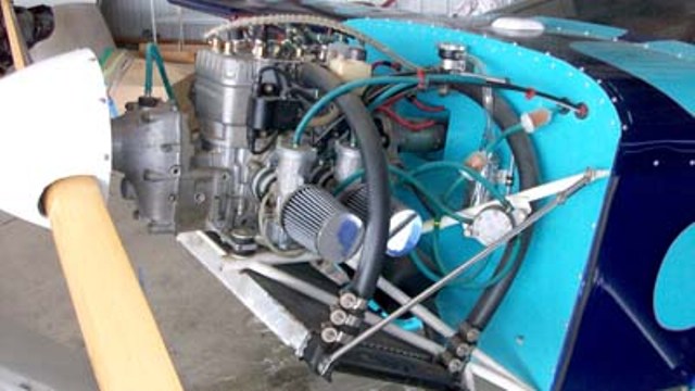

Re: Rotax 532 powered KR2
Hi all,
Found this installation pic of nearly the exact same engine as mine. Pity my prop is so long as I would have liked to install engine upright exactly like in this pic.
Keep well all,
Henni
Keep well all,
Henni
Henerik my maat, kyk mooi...........daai ratkas en joune is altwee die "B-box" , die een in die foto is in die regop manier aan die enjin gesit. Haal jou ratkas af, en draai hom 180 grade..........EN............
...........hey presto ....
.....jy kan dan jou enjin net soos die een in die foto monteer
Jean.
Jean.
Jean,
Wens dit was so. Sal more 'n foto of twee pos - myne het definitief nie dieselfde offset nie. Dit was die eerste ding waarna ek gekyk het.
Miskien is ek verkeerd en ek hoop van harte so...
Groete,
Henni
Groete,
Henni
Hi Jean,
I stand corrected mate. I looked wrong, my box is the same. It is my desire to mount the engine upright and now I can!!! Sounds silly, but Im elated. The part of the engine protruding above the gearbox will be covered by a bigger spinner. Ill make the cowling top like the Grunman Tiger, I think it is, and it will not look ugly as those other Rotax KR2 pics.
Tx my friend for the advice,
Henni
Henni
