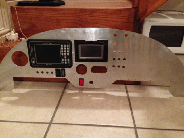

The pic below is the panel in the making. I will make it a glass panel with some backup steam gauges. Also fitting a transponder and some vents...

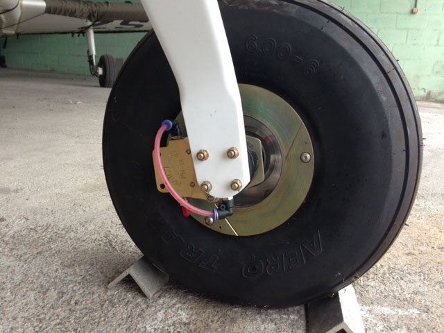

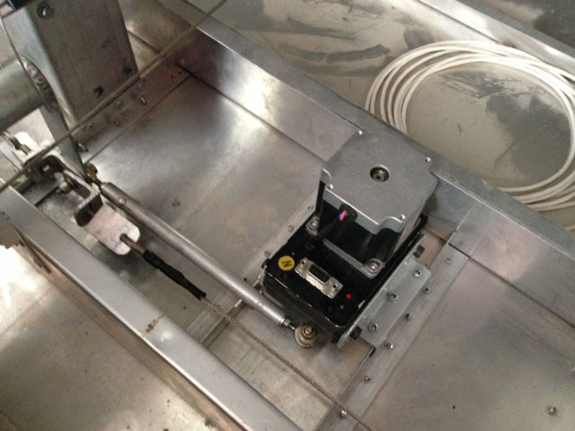

Postby Induna » Thu May 08, 2014 6:37 pm

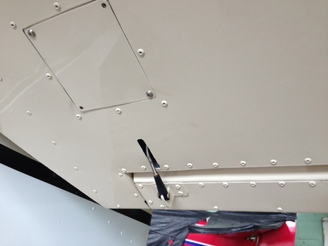

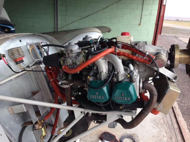

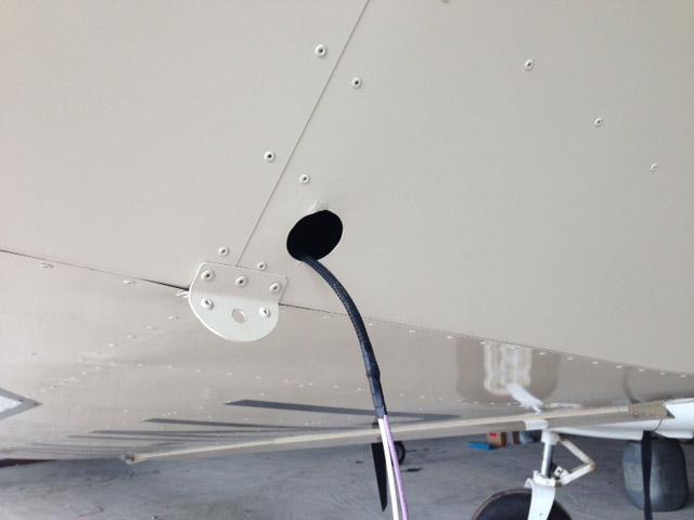

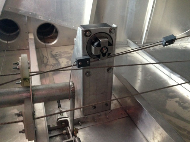

Here are some progress pics...
912 Engine
Brakes
Strobe light wiring
Aileron AP servo
Elevator AP servo
Elevator electric trim
ZU-RHT | Magni M18 Spartan

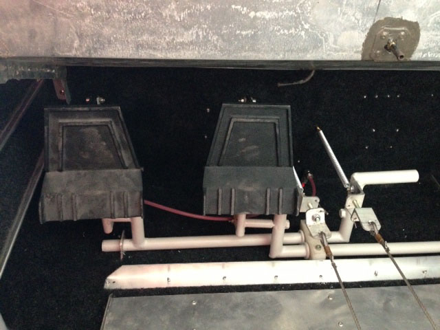

Postby Induna » Thu May 08, 2014 6:38 pm
Rudder pedals and toe brakes...

The brakes are completed and it is working very good! The panel has also gone to the powder coaters, so should have tomorrow or Monday.

The panel has been installed and 90% of the wiring completed. If all goes well I might get the chance to start the engine for the first time late tomorrow afternoon...! I am super excited!!

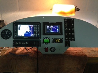

Below is a pic of the panel last night after pre-wiring and testing...
Jacques

Another interesting thing is the brakes. Traditionally the Ravens have drum brakes, which just sucks...!!! :twisted:
With the hydraulic brakes that I installed, it is very powerful and much needed in a taildragger! I used to own a Koala that initially had drum brakes, but a taildragger does not turn easily with those... Lol!!
I also installed nice big pedals that feel very comfortable and very different from the "normal" pedals installed in Ravens.

Today was a major milestone... I got to start the engine for the first time and all I can say is WOW!!! The engine is super smooth and temps and pressures are all looking very good...!
All the wiring is done. I just have an issue with the elevator AP servo that will only operate in one direction, although the setup is done correctly. The aileron servo is working flawlessly. I have mailed Rainier from MGL to ask advise.
