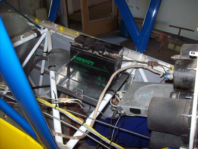

Postby Boet » Thu May 16, 2013 7:14 pm

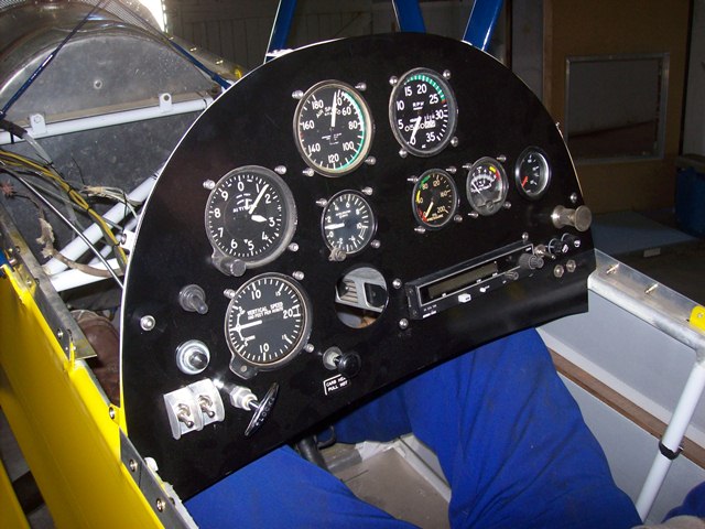

Battery box made up. It wil take 2 18ahr batteries, giving a total of 36ahr cranking power. That should be good to crank an 0200 into life. Panel also in. I have already started hooking up the wires.
Panel in, now just to hook up everything
The battery box, will take two in paralel.

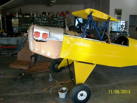

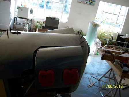

Postby Boet » Tue Jun 18, 2013 7:59 pm
Carrying on with the build. "Nostrills" on, cowling basically complete, but need some aly sheet. Will have some towards the coming weekend. Wing far along, will post pics of that later. All the wiring and plumbing done, and the engine turns when u hit the starter button. Radio working. Still looking for an altimeter.

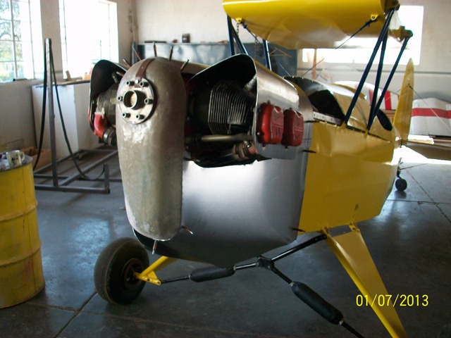

Postby Boet » Mon Jul 01, 2013 5:49 pm
Cowling nearly there.

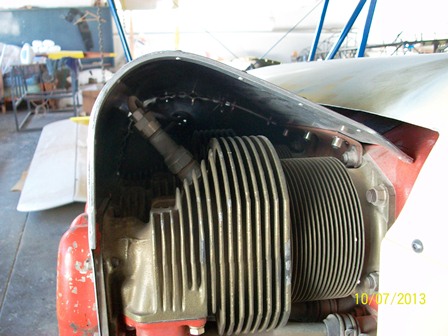

Postby Boet » Wed Jul 10, 2013 8:57 pm

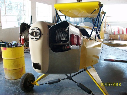

Donkey work on rh lower done, and going together nicely. Today we painted the cowling. Nice and shiney yellow.
Cowl, complete and ready for paint
Detail on nostril, aly edge added to keep baffle from fluttering. Been there......

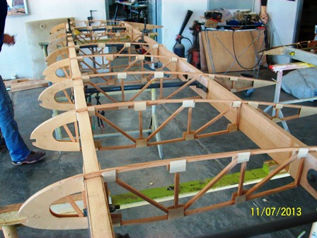

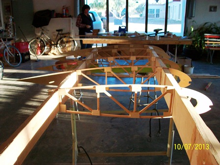

And finally, a seak preview of the wing, just for Oom Gans.

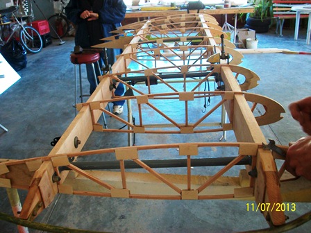

Postby Boet » Thu Jul 11, 2013 12:27 pm
The little wing is coming together real nice now. Now just to add some glue, and a couple more match sticks, and voila! (^^)
Spesjil net vir Oom Gans.

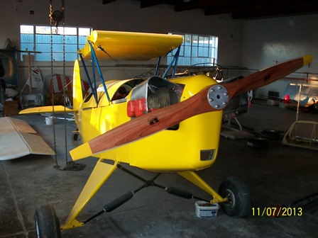

Postby Boet » Thu Jul 11, 2013 5:39 pm
`Ol Yellar."

Boet wrote:The little wing is coming together real nice now. Now just to add some glue, and a couple more match sticks, and voila! (^^)
Wragtig pragtig, Oom sien ek laaik mooi houtwerk in airies. =D* =D* =D* =D* =D*

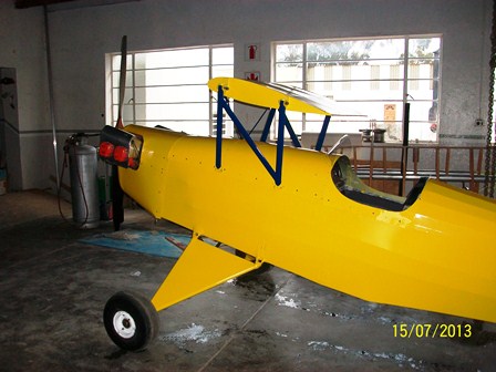

Re: Re building EAA Biplane.
Postby Boet » Tue Jul 16, 2013 6:32 pm
Just loooove aeroplanes with long nose! (!!)
....and the nose on this one is rather long!
