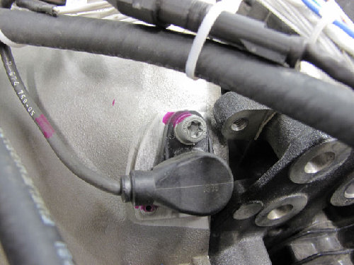

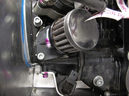

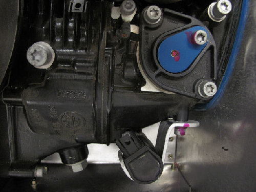

Thank you Ystervark7 for explaining the system so well. I see we have passed the 25000 mark, at the moment I'm clearing all the little loose ends I'm showing the brackets for the coil on plugs that are underneath and are part of the secondary system . On the one side you see the breather filter and on the oposite side the blanking plate for the area where we harvested the camshaft sensor. The blue plate holds in place a plug with an o-ring and on the last picture I show the sender unit already previously mentioned. That is the sender unit for system #2. On the first two pictures note the close baffling now hel in place with springs. The air passing can only pass via and around the cyl head and cylinders. Also note the purple nail varnish is put on anything that has been double checked. We are now aiming for the finishing act. Enjoy the pics

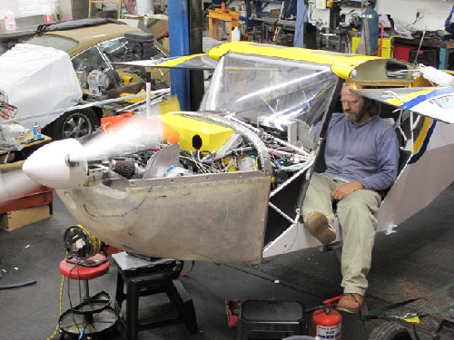

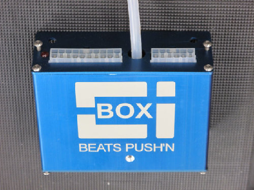

Thanks everybody for the kind words I'm just trying my best. I have the ability to use every minute and it helps not watching TV I find TV not very inspiring except for a few programs and then there is the wonderful machine that can record. In the photo's you will see Otto tuning the engine and Eboxi programs. I caught him tuning with the prop spinning. With all the probes installed I can't get the engine to overheat. Of course we can't pull any power in the workshop. I have started withe silicone baffle sealing. This works out well and the taxi tests are coming closer. Installed are the piggyback Eboxi's . Both boxes have started the engine no problem and we will now finish the wiring for the backup system we chose to do that wiring in two steps as not to build in problems that can so easily happen. From the header tank point of view everything is working well the header tank at the moment is breathing to atmosphere and in the final setup the breather will breath back to tank. Breathing the system is absolutely essential. I'm calling it a day tonight and will finish the baffling to-morrow subject to the Red Cross calling me. Enjoy the photo's.
Cheers Oupa-G

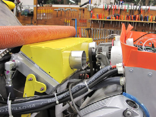

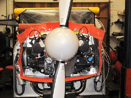

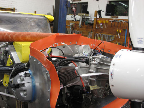

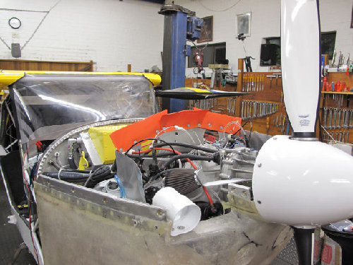

Another day of intense working finished the seal around the baffles to make sure that none of the precious air escapes without doing some heat absorption. The material is high grade silicone sheeting cut to suitably sized strip and riveted in place. The material is heat as well as oil resistant. Also the sheeting is soft enough that it will mold and shape under the air pressure.
The oil cooler air box has now received the piping. I reckon one more day of tidying the wiring from all the probes and all the work firewall forward is completed. At least I can say that that side of the building is finished before the end of April. The panel and the connecting of the radio's transponder etc. will take some carefull thinking as well as time. Some pictures enclosed of the baffle seals.
Enjoy the photo's
Cheers Oupa-G
