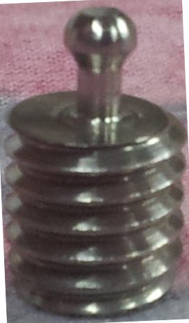

Still some issues to sort out. I previously had problems with the throttle sticking a bit. So I redid most of the throttle system, and it is smooth as silk - but after all that work, I discovered that it was actually due to a poorly machined part in the carb itself! Sonex is sending me a new one, but now the throttle is so smooth that it is almost impossible to use. Let go, and the vacuum of the engine will pull it closed. Hold the know, twitch a muscle in your big toe, and the RPM changes. After working so hard to take the friction out, I will now have to add a friction nut to 'fix' it!

The offending carb bit:
The little knob is fractionally off centre, so it pushes the needle against the side of the metering hole, when the offset is to the side, causing it to stick. At the moment I am running a 1/4 turn too rich, so that the needle is pushed down (instead of sideways), and still moves freely.
