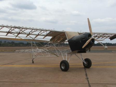

At last the wings is on vhpy

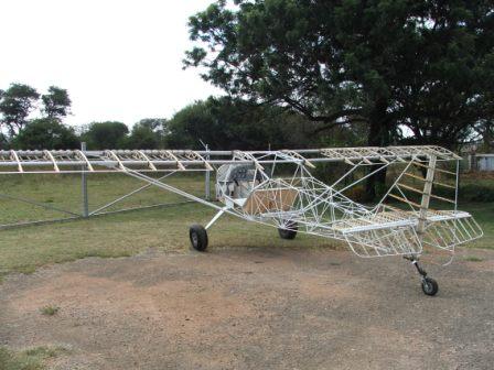

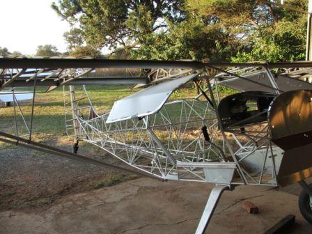

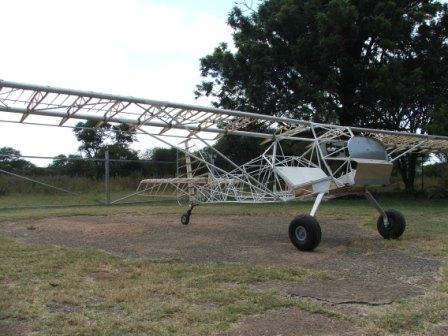

Postby Goose » Sat May 16, 2009 5:50 pm
Doors and Jerry struts fitted
Re: My Kitfox7 SS Project
Postby Morph » Tue May 19, 2009 10:42 am
Goose wrote:..Jerry struts fitted
Jury struts Goose :wink: 8)

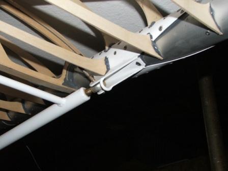

Postby Goose » Sun May 24, 2009 9:58 pm
All top and bottem falls rips installed. All wood parts will be sealed with epoxy resin(Resin: LR20 Hardener: SLC60)
OWL
Slow starter
Posts: 1
Joined: Thu Jan 15, 2009 7:49 pm
Postby OWL » Sun May 24, 2009 11:53 pm
THANKS FOR PICT (FALSE RIBS) GOOSE
