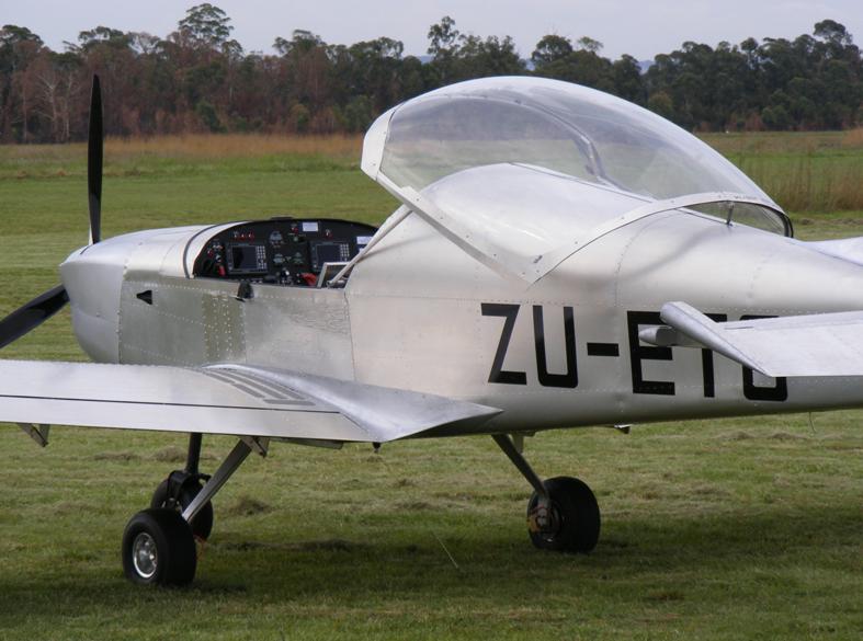

What does the current canopy do?. Tip back?. I kind of liked the sharp lines on the cowling....

Construction will be hole-matched, with the holes exactly to size (I think only the RV12 has exact holes). Unfortunately, all my detailed construction photo's were taken before we have started our matched hole approach. As we build the production prototype we will take lots of photos and time the construction more carefully. The matched hole approach also elliminates all jigs except for a very simple jig (also supplied) that ensures accurate wing twist.
The canopy on this plane has swing arms hinged just behind pilot/pax's shoulders, while the top rear centre of the canopy slides along a rail. The canopy takes on a rather low profile when fully opened. This allows visibility as good as any other "bubble", without the risk of a sudden gust removing your open canopy (we've had the canopy open while the engine was tested to 100%)

That is nice. Why change it to the production model?. Simpler? cost saving?.

Stephan van Tonder wrote:That is nice. Why change it to the production model?. Simpler? cost saving?.
It gets really hot in there during taxi and powerchecks. Sliding canopy is also less of a danger if a latch comes loose.
But I will also miss the visibility of a clean bubble...

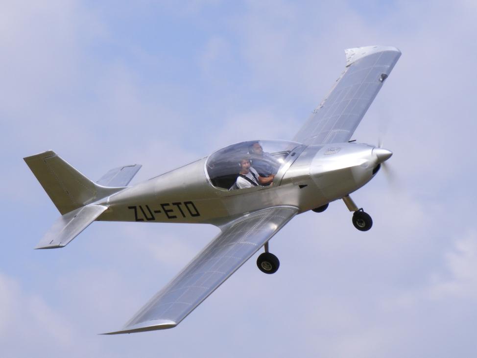

We do have a website in the pipeline, but all our attention at this time is on the test flying. As soon as we have decided on all the changes to be included or excluded from the production prototype, we will be in a position to publish some "official" specs and pictures on the web. As the article in the January edition of SA Flyer will point out: this is a development prototype only, but here is another picture taken recently.
