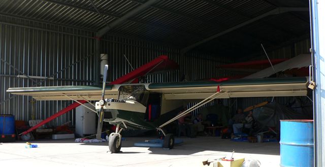

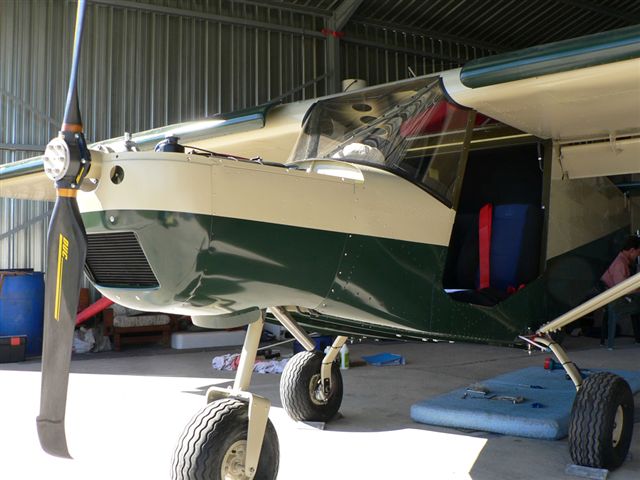

Another Savannah derivative has just been completed in Port Elizabeth by Guy Blain....This one is the Bingo derivative which is renamed the "Oribi" in South Africa.....
Ian
Posts: 486
Location: Crosswinds
Postby Ian » Mon Aug 14, 2006 7:17 pm
FAWGie wrote:Another Savannah derivative has just been completed in Port Elizabeth by Guy Blain....This one is the Bingo derivative which is renamed the "Oribi" in South Africa.....
Now, THAT looks really nice !
The cream colour (it looks off white) with the green is Cool :!:
FAWGie, what motor does she have :?:
Any other pics ?
Cheers ian

Postby FAWGie » Tue Aug 15, 2006 11:53 am
Any other pics ?
Cheers ian
It is fitted with a 582 Rotax....one more pic....
Quote from the agent's news e-mail (John Waterson) shown below:
Hi Guys
This is the first Oribi 582 built as our Demo by Guy Blaine in PE.
We decided to go for the Bush Colours to attract the attention of the farmers and nature lovers.
Awaiting Reg No's CAA.
John
Bush LR3.jpg (39 KiB) Viewed 4735 times
