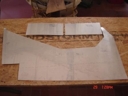

44 Cabin Side Panel.jpg (24.98 KiB) Viewed 20038 times

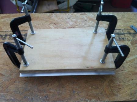

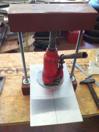

48C Finished panel with flanged hole.jpg (27.03 KiB) Viewed 19982 times
48B forming the flange using a simple press.jpg (29.81 KiB) Viewed 19982 times
48A Blank in the forming blocks.jpg (29.21 KiB) Viewed 19982 times
48 Fuselage rear panel blank.jpg (26.07 KiB) Viewed 19982 times

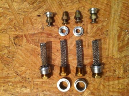

47 Fuel tank fittings.jpg (39.04 KiB) Viewed 19982 times

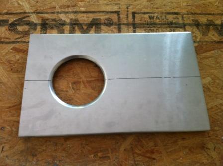

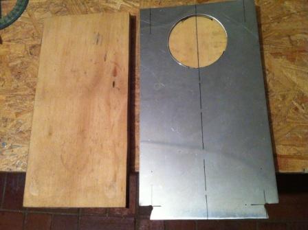

Few more parts to add to the build

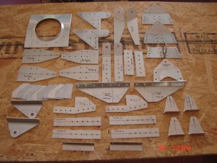

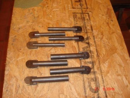

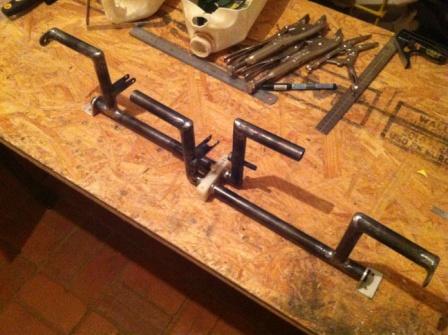

Quick update on the build, been making what seems like thousands of smaller parts, rudder pedals done,been waiting for more material to arrive from Zenith so I can start the wing spars,fuselage etc. Crate left zenith yesterday weighing in at 150kg, air freight bill was ouch!!, but at least it will be here in about a week, crate heading towards O'Hara by truck then onto a plane for a round trip to Zims.
Whats in this crate would even get father xmas excited,so if he doesnt make to zims over xmas due to "sanctions" I am sorted already.
Will post a few photos of more parts made soon.

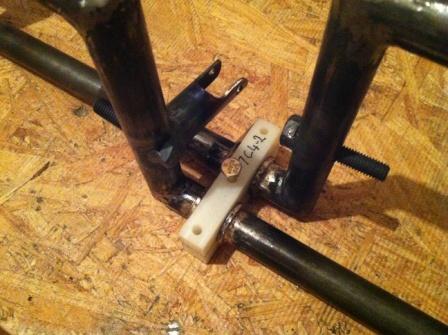

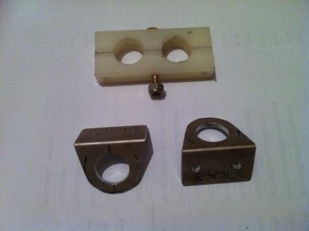

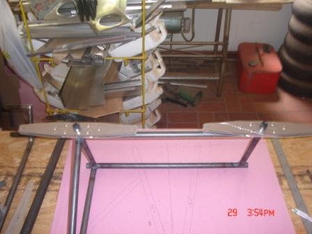

49B Rudder pedal centre mounting nylon blok.jpg (37.07 KiB) Viewed 19852 times
49A Fabricated rudder pedal assembly.jpg (36.38 KiB) Viewed 19852 times
49 Rudder pedal mount brackets.jpg (18.76 KiB) Viewed 19852 times

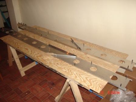

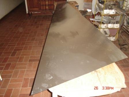

55A Fuselage side skin.jpg (28.6 KiB) Viewed 19744 times

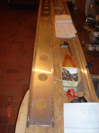

54D Spar web.jpg (27.62 KiB) Viewed 19744 times
54C Spar web.jpg (29.25 KiB) Viewed 19744 times
54B Spar web.jpg (26.21 KiB) Viewed 19744 times
54A Spar web.jpg (27.97 KiB) Viewed 19744 times

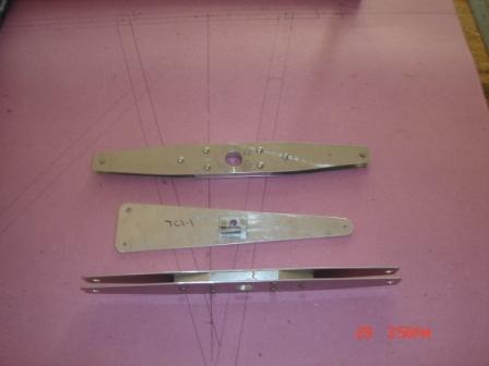

52 Alireon horns.jpg (20.46 KiB) Viewed 19744 times

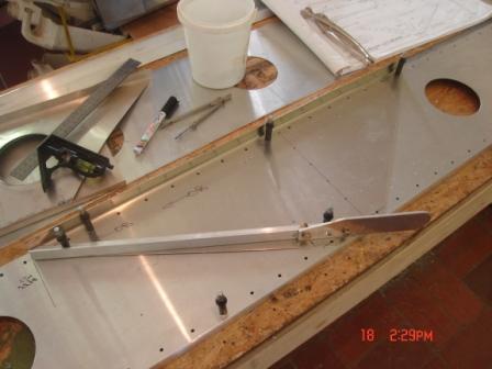

51A Flaperon moxer.jpg (31.08 KiB) Viewed 19744 times
51 Flaperon mixer.jpg (25.66 KiB) Viewed 19744 times
50 Streamline struct mounts.jpg (33.49 KiB) Viewed 19744 times

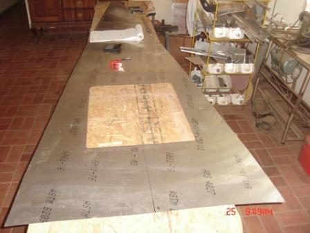

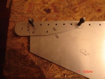

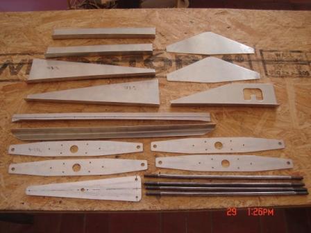

Here with progess update of the 701. I have been putting together an order from zenith which has now arrived, air freight $$$$ ouch , any now can start building the bigger parts of the project now. Pity some of my materials I ordered they got mixed up between feet and meters, so very short on 4130 0.75 tubing but will make a plan.
Building log is now up to 530hrs, work single handed this is lots of building.

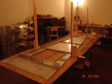

Have now finished drilling all the longerons/skins for the rear fuselage section.Deburring all done so next is primer at all joints and begin rear fuselage assembly. There is a huge amount of measuring done on this section so I really hope it all comes together as planned.
Just dismantled the existing work bench and will upgrade it to a wider bench surface so the fuselage and wings can be assembled on the bench.
Will post some pics once I have some pieces joined together, trail assembly with clecos then riveting.

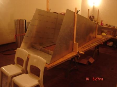

The 701 build took a big step last nite. Finished riveting the bottom rear fuselage skin, now to mount the side and top skins. Then we have half a plane,well maybe half.
Before I do any more riveting I need to get the air riveter working, my hands have had enough of hand riveting now.

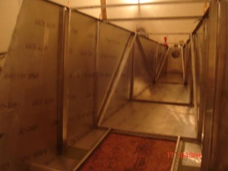

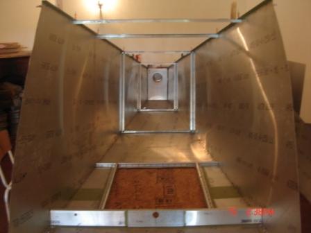

Postby Z-MRP » Thu Mar 13, 2014 10:13 am
55B completed bottom fuselage skin.jpg (25.42 KiB) Viewed 19474 times

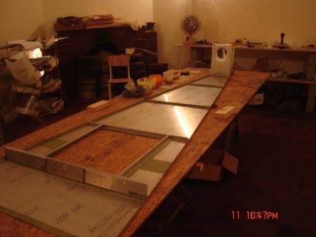

Photo of the completed bottom rear fuselage skin,along with the new bigger work bench to accomodate building bigger sections now. All wing parts are on standby for assembly as well now.Just waiting for the solid rivets to be done on the wing spars.

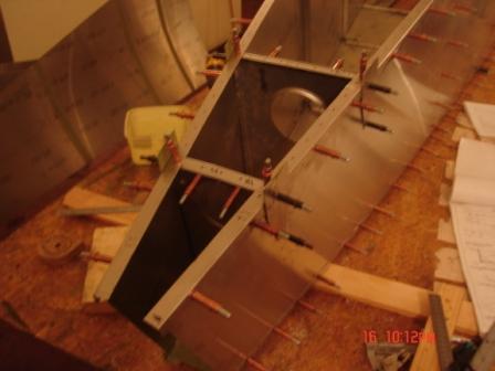

Postby Z-MRP » Tue Mar 18, 2014 7:35 am

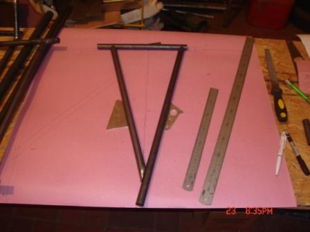

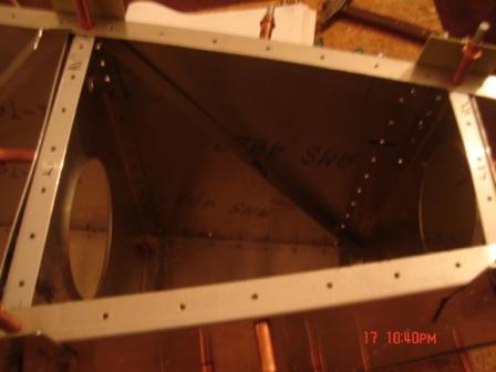

59 HT frame diagonals fitted.jpg (24.61 KiB) Viewed 19399 times
58 Horizontal stabilizer mountings fitted.jpg (27.42 KiB) Viewed 19399 times
57B Side skin diagonal stiffners.jpg (23.36 KiB) Viewed 19399 times
Few more photos on progress with rear fuselage section construction

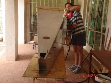

The rear fuselage section has now been moved onto the veranda for final riveting. The landord wasnt keen to fit a bigger french door in the lounge ## . ##
Riveting is now under way, thank goodness for pneumatic rivet guns.Really satisfying to be able to assemble and eveything fits as it should do.
I will post a photo this weekend
Z-MRP
Posts: 190
Joined: Fri Jul 25, 2008 11:35 am
Re: CH 701
Postby Z-MRP » Sat Apr 12, 2014 8:36 am
60 Riveting rear fuselage section.jpg (31.77 KiB) Viewed 19201 times
