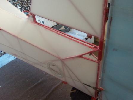

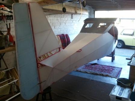

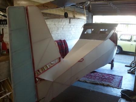

Started covering. Rudder and elevator done. Flapperon's pre-fitted and turtle deck cut outs done. Wings also ready for covering.

Re: Bushbaby Explorer 153
the rudder and elevators are the hardest to cover 'cos of the tight corners, the rest is easier....except maybe the dreaded fuselage to fin corner.
mic wrote:the rudder and elevators are the hardest to cover 'cos of the tight corners, the rest is easier....except maybe the dreaded fuselage to fin inside corner.
Die "dreaded fus to fin inside corner is maklik"

Wel, my speel tyd is alweer om en tyd om te gaan werk. Kon darem redelik progress maak met die covering. Het elevator, rudder en stabelizer voledig oor getrek. Altwee vlerke oor getrek en kry eerste coat en picking strips as ek terug in die land is. So volgende is die fuselage. Het ook drawing van die panel klaar, wag net vir die GPS om final laser cut te laat doen. So ek vorder so stadig maar seker. Jammer geen fotos nie, dis almal op my foon en het kabel vergeet.

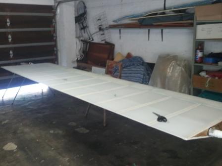

Progress with the covering.

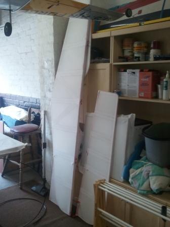

The wings

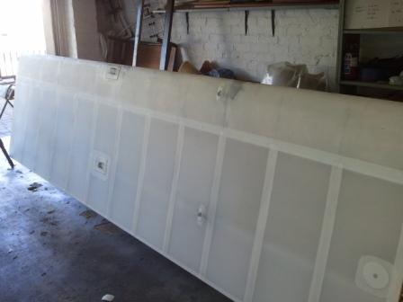

Basically finish with covering. Only few strips to be installed on fugelage and then the painting progress begin. Wings and loose parts already 4 coats Nitrade applied.
