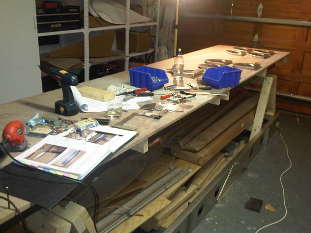

My nice clean workshop is a mess again - started building the wing.
Cross_Wind

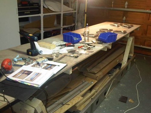

cross_wind
Posts: 225
Re: Conrads CH 750 Project
Postby cross_wind » Fri Mar 04, 2011 12:59 pm

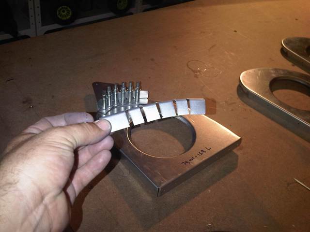

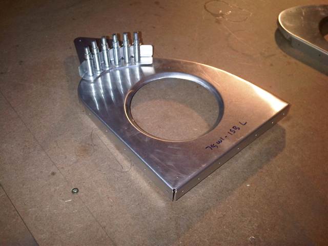

Postby cross_wind » Fri Mar 04, 2011 1:01 pm
These freaking brackets take forever and I have to make 8 of them!
Cross_Wind

cross_wind
Posts: 225
Postby cross_wind » Fri Mar 04, 2011 1:02 pm
Bracket close-up.
Cross_Wind
