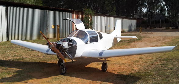

At home at Rhino Park:
Checked the timing, and all four ignitions seem to be fine (gack, what a pita...).
Still need to organise someone to do the compass calibration, compass swing, and radio and transponder check. Hopefully get this sorted out next week, and get the AP to sign everything off!
Cowls are still off for the initial break in runs (following the Great Plains recommended break in procedure). Engine is purring nicely now on fresh Avgas, but I still need to get the tuning right. First run was marginally lean, the next a little rich. Will tweak some more tomorrow, and hopefully get it just right

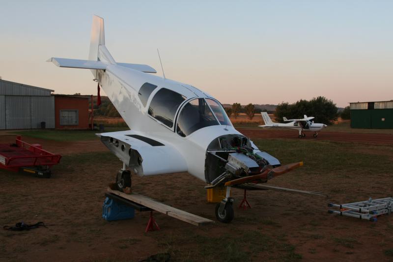

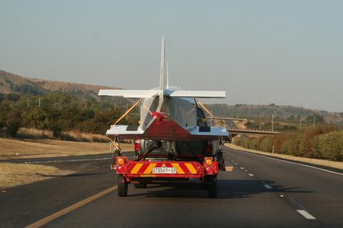

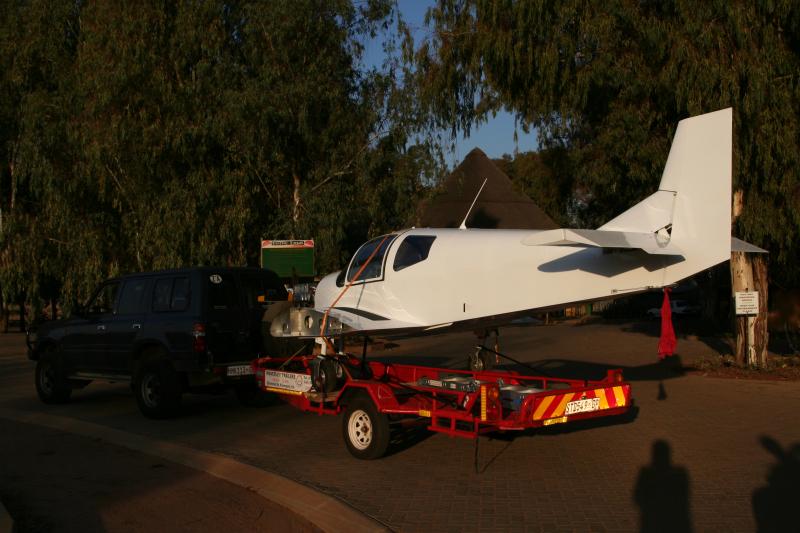

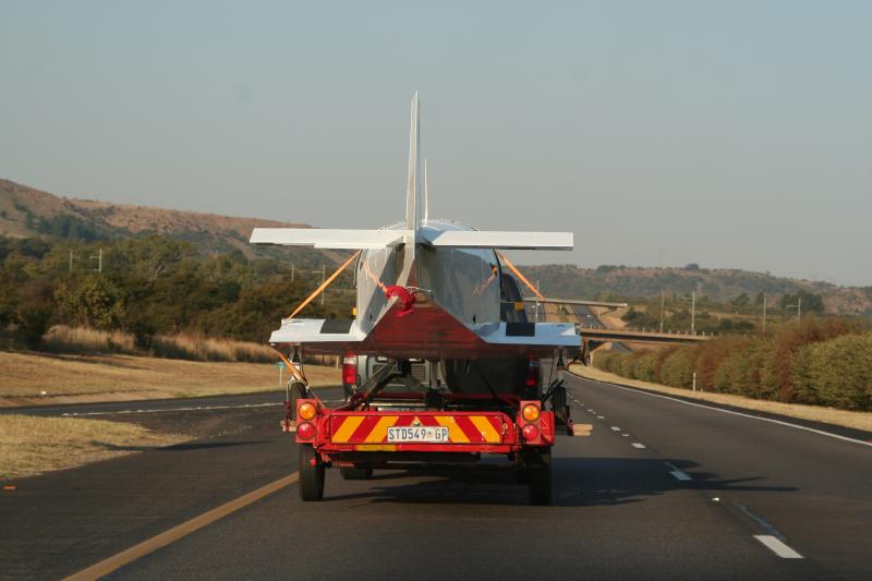

Some pictures from the move. It was quite an exercise, seeing as the wheel base is a hair under 2.2m (actually a bit over, if you count the forks too). I have only ever found one rental trailer that fits (barely) - but that was not available. A bit of ingenuity, and a few stout planks solved the problem
Sunday's rain interrupted the engine runs. So far done 3 of the 6 runs, and nearly have the carb dialed in (although I may need to try a leaner needle).
Temps look good. Max 190C after 5 minutes at 2500RPM with the normal baffles, and only 160C with the ground run baffles. Another 2 minutes at full power got it up to 190C. I expect it will do fine with a little air speed to keep things cool...
Max static RPM is only 2950, which is a little disappointing. I really hope it does make enough power to fly well.
At the moment, I am losing ~0.6" in manifold pressure (measure 25.4" with the engine off, and 24.8" at full throttle), so I will try to find a dust free area for a run, and see what it is like without the airfilter. Perhaps it is too small?
Another busy week ahead at work, but hopefully I will be able to take Thursday, or Friday off to do the cables and weighing.
