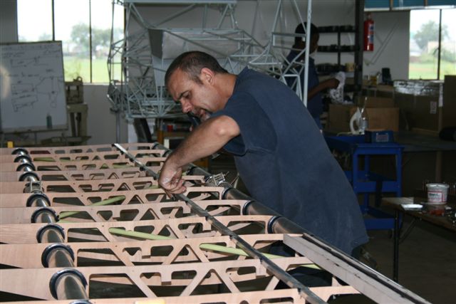

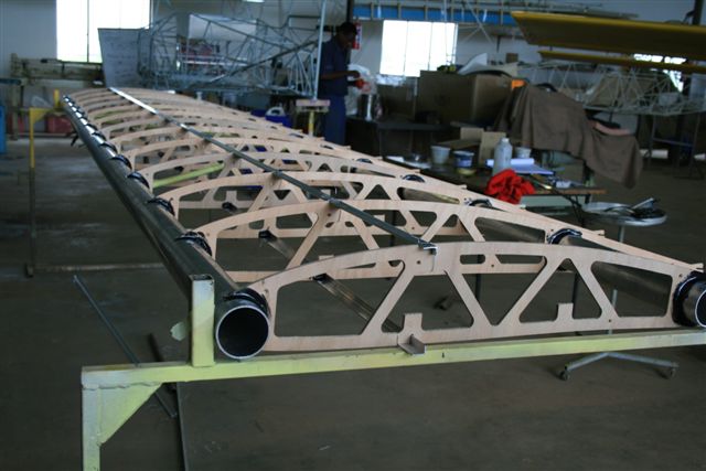

Postby KFA » Wed Feb 04, 2009 8:29 pm
Rick aka Mogas, finishing the wings for load testing. Very nice job!!!!! (^^)

Postby Boet » Wed Feb 04, 2009 10:03 pm
Jy kan maar knoei, solank jy net netjies knoei. :wink: Rick, jy moet daai vlerkie donners sterek bou ou, anders gaan hy dalk te vroegtydig breek :shock:. Good show guys, keepin my fingers crossed and my thumbs up. See ye next weekend. vhpy vhpy vhpy

Postby KFA » Wed Feb 04, 2009 10:23 pm
That wing is stroooong. I think we could have kept it the liftstrut brackets where they were and just lengthened the stiffeners. We have now moved the bracket otboard with 330mm and lenghtened the stiffener(I-Beam) from 990mm to 1200mm. We also increased the wall thickness of the liftstrut from 0.9mm-1.2mm. If you compare to the Super Sport we have here wich has a 700kg all up weight. It has a 1.5mm main spar with only 11 ribs where we have 13 and a 2mm main spar. I have all the faith in this wing.
