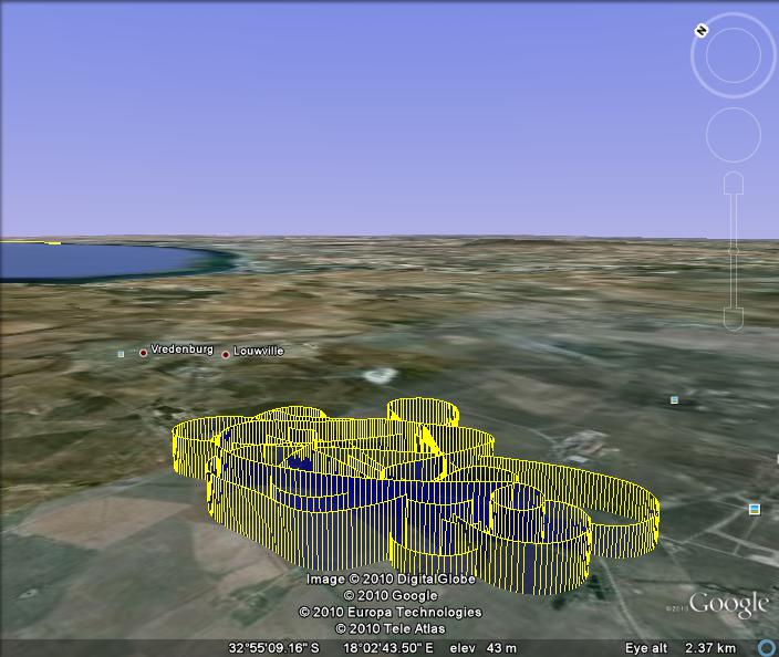

We had a 45min flight on Sunday and the little yaris engine is performing without a hitch so far
Started playing with the mgl recording and am amazed at the valuable info this instrument can record.

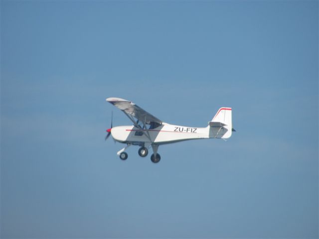

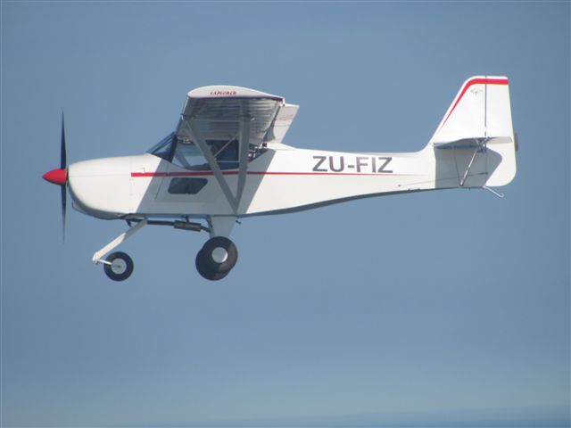

Sunday morning we flew to Lambertsbay and met the Saldanha croud on their way back, the yaris powered explorer performed without a hitch, she has done 10hrs and we have not changed anthing under the cowl,do preflight add fuel as required and fly vhpy
There is still a lot of testing to be done but i am confident that the little yaris engine has a place as an alternative powerplant in experimental aviation,we are busy importing the 90hp kit
Alt 1800ft ASI 85mph RPM 5800 Coolant temp 84 c Oil temp 94c OAT 24c
