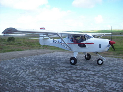

Postby diesel dog » Wed Jul 14, 2010 12:10 pm
Things are looking up ,just spoke to Van zyl aviation and they are positive that we will have proving authority before the weekend vhpy vhpy vhpy vhpy
It is raining at the moment and we need plenty more,so this could be an exciting weekend
the jabi is lonely at the moment the explorer is stealing the lime light
kjh 006.JPG (34.33 KiB) Viewed 11321 times

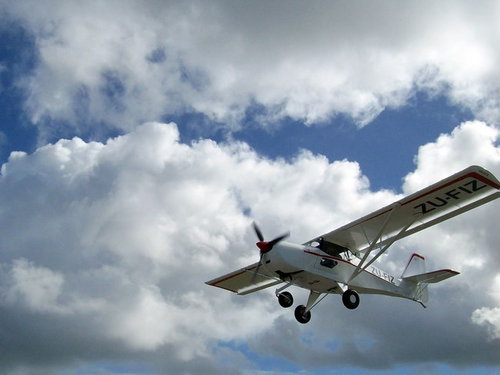

And some more of the big day.
Roaring by
Touching down
Diesel Dog and Johan

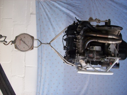

64kg engine exhuast header starter alternater enginemount
