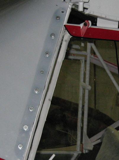

Massimo wrote: So Rainbow managed to cut and bend the windscreen to your required curves etc with no problems? Im asking this because i may also need a new windscreen and i dont want to import it from the states.
I see you don't have a windscreen. Do you have an old sample? Typically the front screen is made of flat polycarbonate sheet (Lexan)
Buy a sheet from Maiseys plastics, I used 2mm and it unfortunately comes in a 2m X 3m sheet. (It can be rolled up and put in the back of a bakkie) You can sell the left overs to other guys who need to replace their winscreens. It's about R1400 for the whole sheet
(Maiseys have their own brand called Nexal (lexan, nexal, geddit :wink: :lol: )
If you have a sample use it as a template, if not, use some cardboard. put all the various parts on like cowls etc that need to be there and then fit the cardboard. It takes a little while but is quite easy to do. I used a grinder with a very thin (1mm) thick cutting disk to cut it, but the straight pieces can be cut with a blade and snapped off like you do glass.
Make sure you start oversize. Again a grinder with a flexible sanding disk is brilliant for shaping it down.
Use cleco's or nails or pins or even self taping screws initially (something that can be removed) to temporarily hold the screen in place until you get it fitted properly
To permanently fit it, drill the holes slightly bigger than the rivets, i.e. 4mm for 3.2mm rivets. This leaves some space for expansion and contraction
rivet into place using a rivet and washer, see pic
Finish the edges with vinyl or matt black paint (second pic)
Remember to leave the protective covering on till the last minute and be careful, it does scratch easily

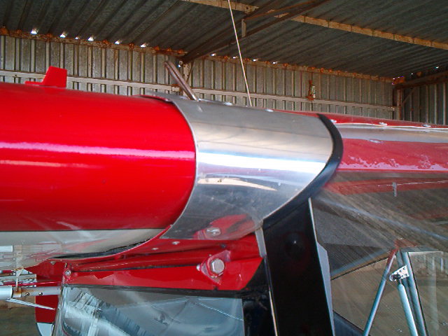

Morph i have a screen but is has 2 small cracks on it and it a bit scratched so im considering putting a new one. My main problem is that the screen makes a big bend at the top where it joins with the roof and also dowN the sides, see pic. How do i get it to bend like this? Heat it up?

Very similar to the Bush Baby.
Polycarbonate is very flexible, no heating required. Once you have it in, the curves and bends make it sturdy. I guarantee you if you take that screen off it will go flat immediately. It's only really bubble canopies that are formed using heat and moulds
here is an example of the curve where the windscreen joins the roof
