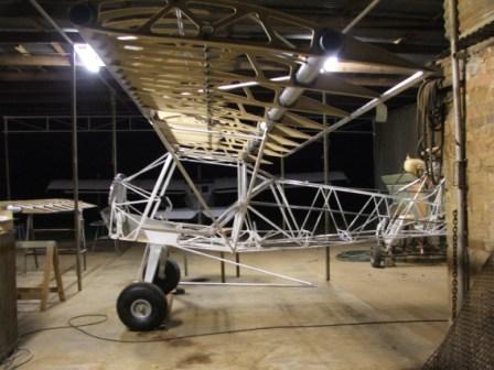

Re: My Kitfox7 SS Project
The first wing is fitted
- DSCF50471.JPG (28.35 KiB) Viewed 7888 times

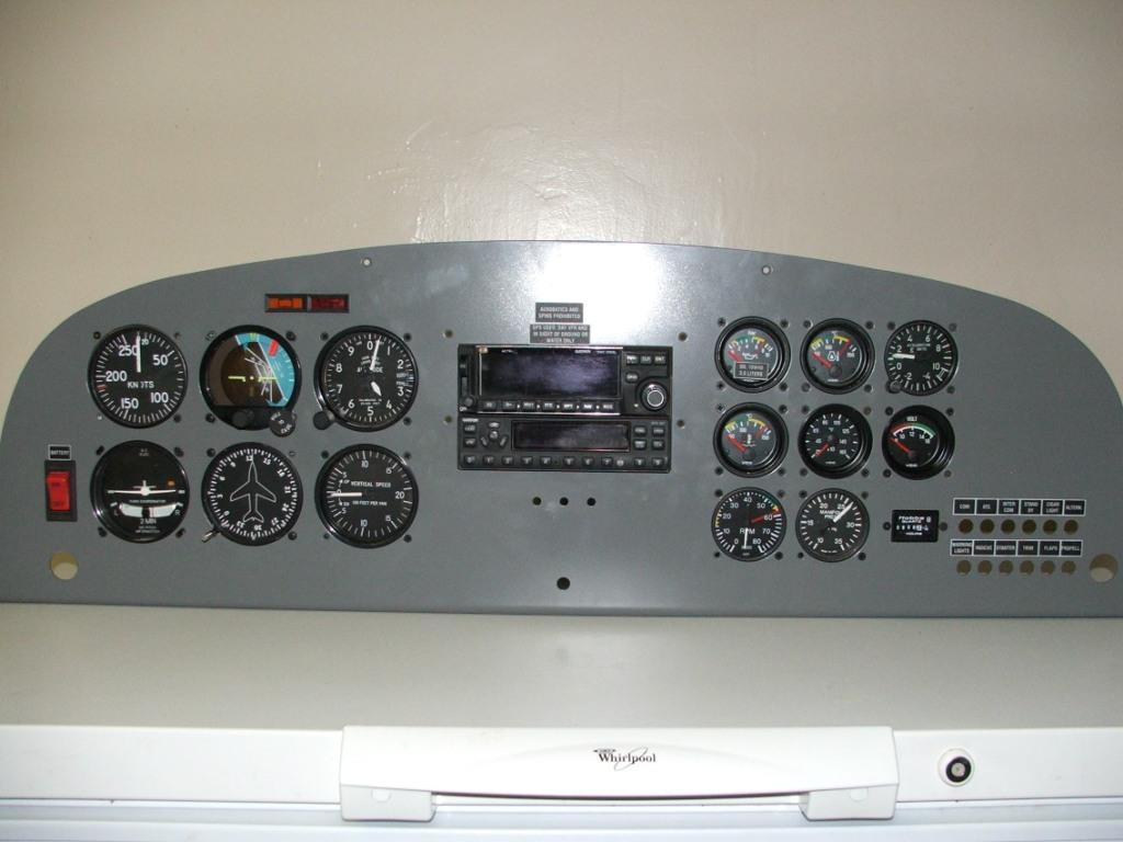

The Instrument Panel
- DSCF55588.JPG (15.21 KiB) Viewed 7702 times

Nice one Mr Goose.Goose wrote:Yes the BB is ALMOST a Kitfox
Hi Goose.
Your panel is looking really great. The six pack balances all the engine instruments and you have a lot of space left.
I really did want a six pack in my new explorer but the one cross member interfered tto much, perhaps they will look at this as a mod on the buchbaby.
When do you expect to fly.
nico
Hi Dusty Eagal
I think i have all that is needed in there,I kept the panel to what im used to in blik airies, I do not like the TV panels.
Hope to be done by the end of this year
Goose
