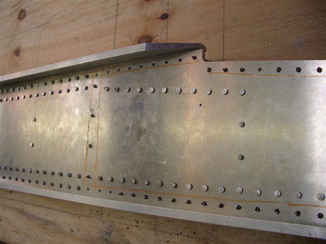

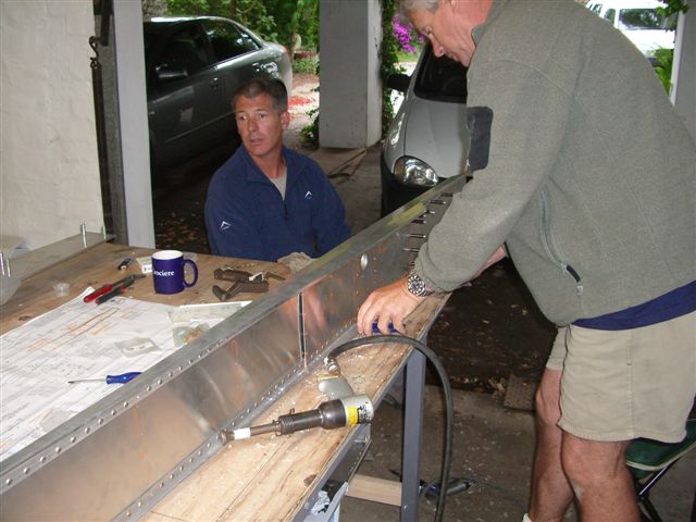

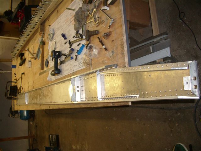

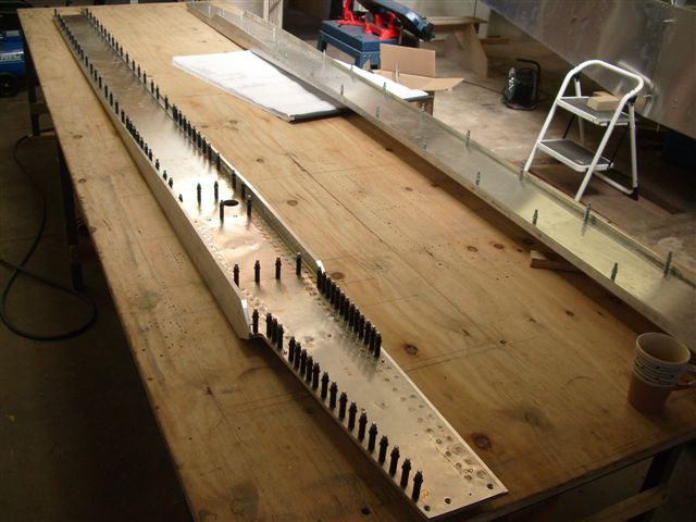

Ok, so you all thought we had given up! Ok, so we did, for about two hectic months, at the end of last year, when business pressure got tooo bad!
But now, back into the full swing of things again, working late afternoons and evenings.
A big job has been the assembly, and solid riveting of the main spars - pics below.
Also had a very useful gt450 flyer - Straydog's been busy again! - got caught here for a few days in bad weather, so put him to good use.

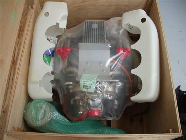

Oh, and engine is here!!!! Jab 2.2.
- IMGP0916.JPG (52.22 KiB) Viewed 3540 times

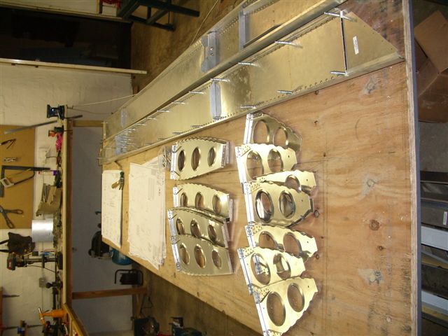

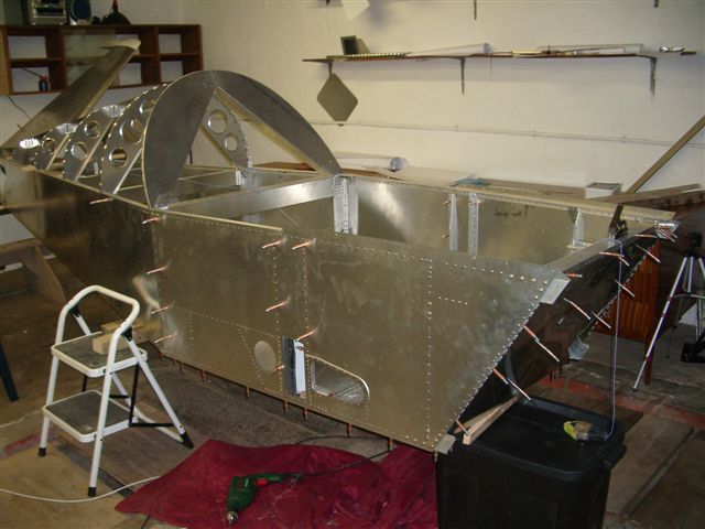

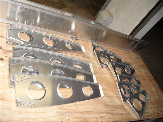

Spars finished, now busy with ribs - below!
Also decided on the 2.2 jab, hoping for better fuel economy, and range.
Time will tell!
Gary Butlion has just assembled his aerovee, in PE, for the Sonex, and should be testing in the next few weeks. Says he went for the slighly lower compression ratio, so will probably get slightly less than the advertised 80 hp.
Will be interesting to fly the two planes against each other when done. Factory says no difference between the two, so will see!

BTW, that new Jabiru 2.2 looks good, but I think they sent you the cooling ducts from the 3300?

Well picked up, Rudix! Accidently posted some pics that were taken in the Jab factory a while ago, of a 3.3!!!
My 2.2 IS in the garage, with the correct cowls. Those supplied by Sonex, for the engine installation, are aluminium, and THOSE are made for a 3.3, so will need cutting, if I decide to use them!
Not exactly how strong the spars are, but I know someone who jumped on them, - not mine! - while attached only at the root only, to try to straighten the bow after riveting, so they are strong! Mine dodnt bow very badly after riveting, seems the more clcos you put in, the straighter the spar after you finish. Plane rated for +6-3 G, but apparently tested to double! Cant wait for the first loop and roll!
