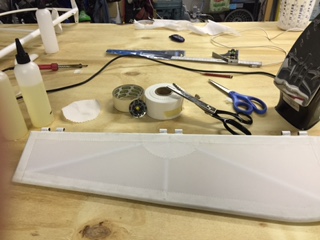

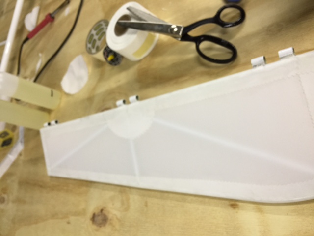

Learned to cover today - Thanks Mike.
Began with the trim Tab it took 6 hours to complete - at this rate I should finish the covering in 6 years.

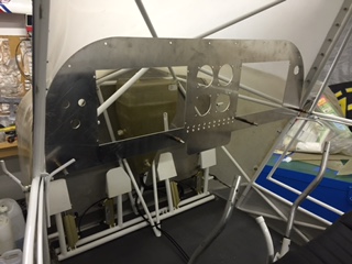

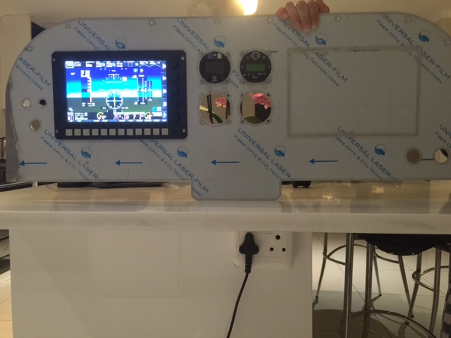

While I have been covering also had my Panel Laser cut.
The cut out on the right is the same size as an MGL explorer so I can add one at a later stage if desired. In the mean time it will be a cubby hole with the cover interchangeable with an IPAD mount. (still need to figure that all out)
The lower left 2.1/4 inch hole will have a slip and the Lower right will have a Analogue ASI the Transponder also has the ability to set display Alt, so I have dual ASI and ALT.
Any ideas on what finish to use, was thinking of carbon fibre covering or just painting white or black.

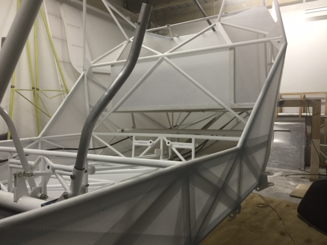

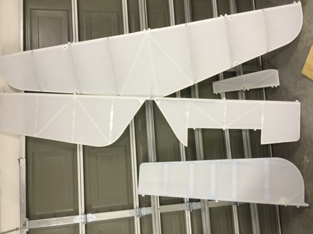

Still busy covering.
Rudder, Elevator ,Horizontal stabiliser and trim tab stitched and 1st coat nitrate done.
Busy with Fuse, bottom covered now busy with the right side.

Finally Finished the finishing tapes on the fuselage and am now ready to nitrate, butyrate and paint. vhpy (^^)
These tapes have taken me more time than any other part of the build, thought I would never see the end (**) .

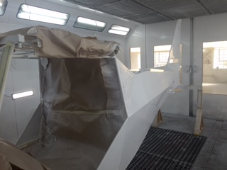

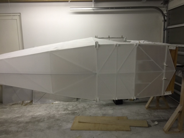

After Taking a bit of a break and revising my completion date by about 6 months I am back on track and getting somewhere.
Painting
Painting

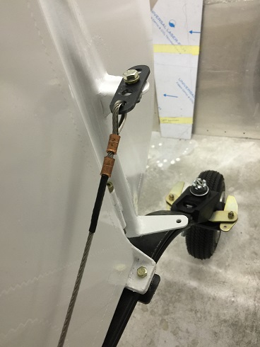

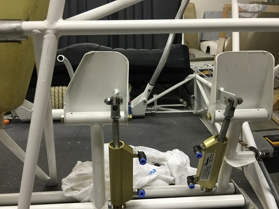

Starting to look like a plane, standing on her own legs now.
Brake Cylinders, Header Tank, Cables and Tail wheel all done.
Rudder and Tailwheel.jpg (51.14 KiB) Viewed 10497 times

Postby KFA » Tue Jun 14, 2016 3:24 pm
Looking good. (^^) The pedal attachment of the master cylinder should be as close to the pedal as possible for max torque

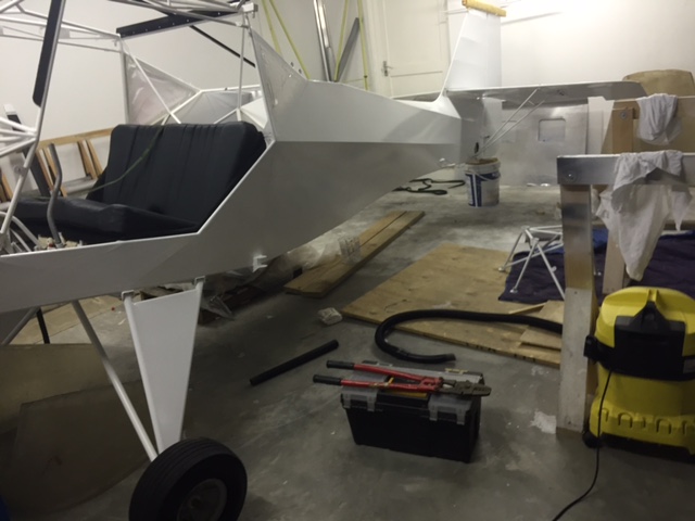

A busy wweakend

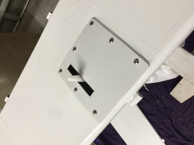

Trim Servo
Door skin
Windshield and engine mount

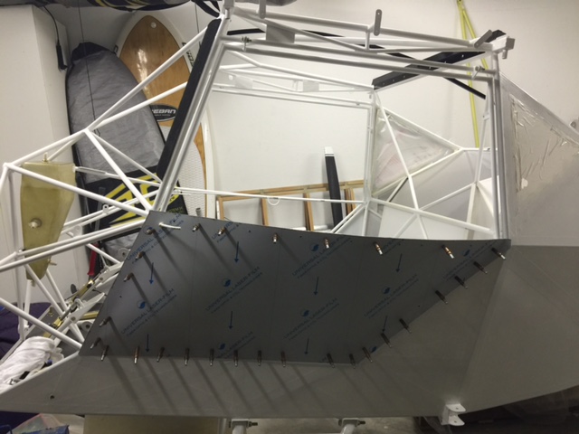

DaveM

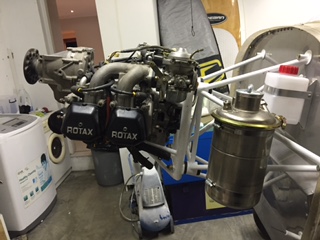

Postby DaveM » Thu Jul 07, 2016 12:25 am
Working hard, putting in lots of hours. She has an engine
