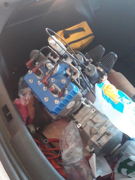

I guess it's still close to my original intent. And now I have dual ignition, a proper Ebox etc. I think what I have now is much more reliable. The KR2 was originally designed for 60hp, so it should fly just fine at the lighter empty weight here at the coast. Hopefully I can register her as a microlight as I need to get licensed to fly once again.
I am at peace. It is everything that I've wanted & she will end up exactly as I originally intended. I'll try my best to finish her quickly. I long to fly again.

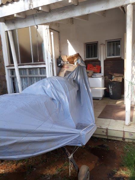

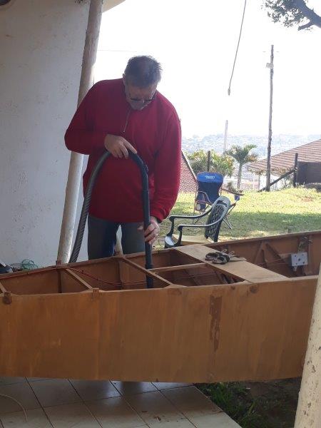

Hi all,

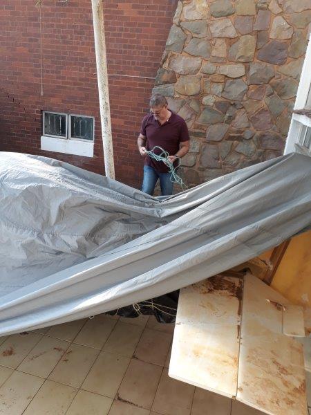

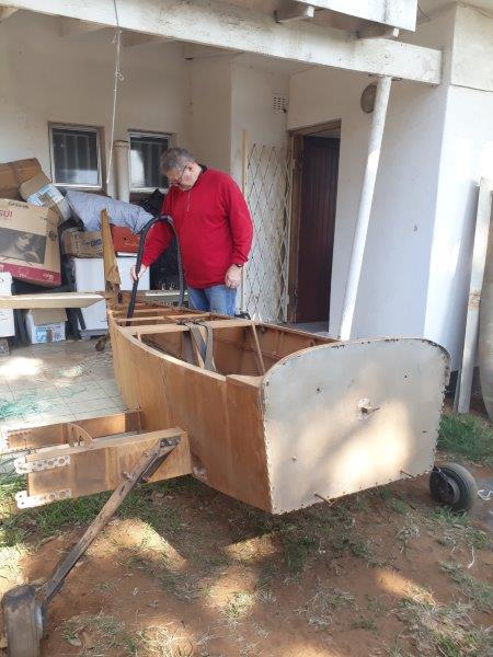

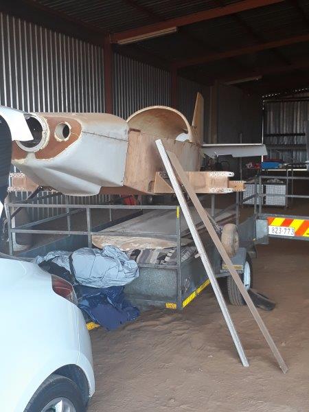

At her new home - cleaning out seven years of Rhino Park dust. Eventually found a real jewel underneath all those dust.
After giving this some serious thought, apart from fitting the Rotax 582 in the place of a VW and adding a belly speed brake, I'm not going to change anything. I want to be in the air flying soonest. I can't wait to fly again!
We will be relocating to a house with a double garage soon - hard to work outside like this and in this August wind my two gazebos won't last so I won't even erect them.
Anyone has contact detail for an AP in the Durban area?

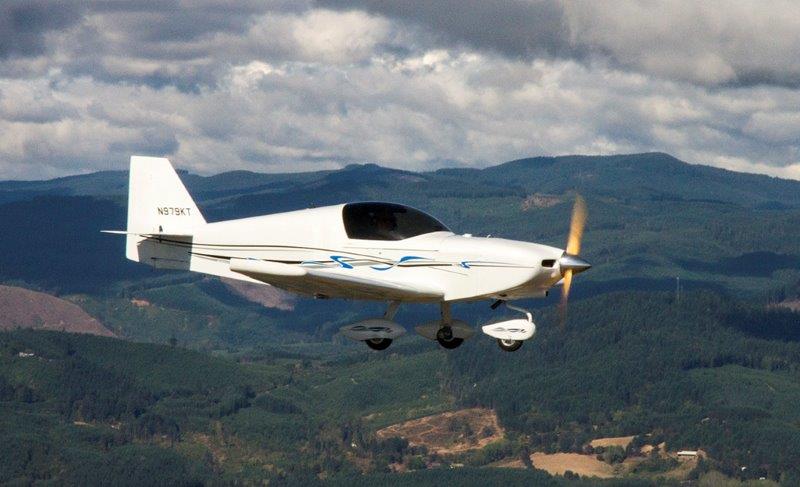

It will be either brilliant white or cream. I do not think anyone has more KR2 photos than me. I search for more on a daily basis. I am still looking at schemes. Will simply copy a good looking one. I really like the paint jobs on the newest Stings - maybe I'll go for something similar.
I am looking at all of these schemes. Notice what the interior will look like.
All the best,
Henni

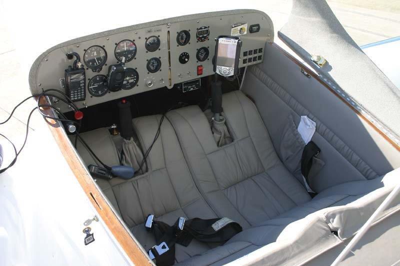

From a KR2 newsletter:
"In an effort to improve interior living space, the aircraft uses a staggered seating arrangement. The stagger is accomplished by different back padding. One side uses little or no back padding . The two occupants do not sit shoulder to shoulder but are staggered by four to six inches. Much like having two reclining chairs side by side but at two different reclined angles."
I am going to build my seating like this to compensate for the lack of shoulder space. This saves me rebuilding the whole cockpit area as I did before.

Dankie Hans,
Ek wil rerig hierdie keer nie te veel peuter nie, maar nog steeds seker maak dat ek en Monica ten minste pas. Ek is nie van plan om baie alleen te vlieg nie en verseker nie weer net al om die blok nie.
Groete en dankie vir daardie enjin - was rerig 'n goeie koop gewees en ek is super tevrede daarmee.
Henni
Henni
