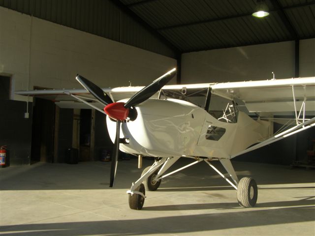

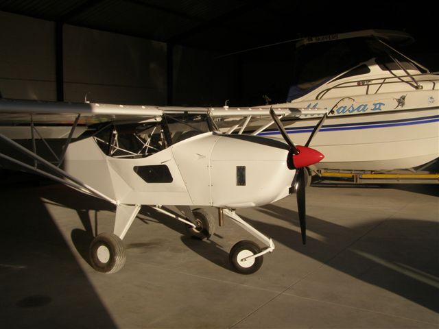

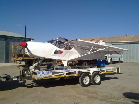

At last we are ready to move to the airfield. vhpy
the paper war has started and now we wait patiently. (**)

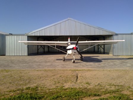

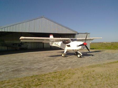

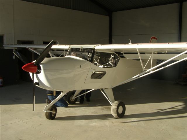

At the airfield done some taxi test and very happy with the results.
leaving the workshop
at home
sniffing the air as Boet would say

diesel dog
Posts: 68
Joined: Thu Nov 19, 2009 7:29 pm
Re: TOYOTA YARIS ENGINE
Postby diesel dog » Tue Jul 13, 2010 5:40 pm

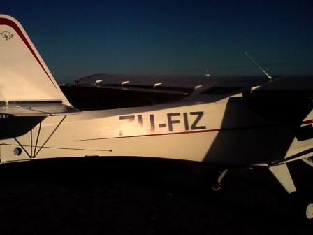

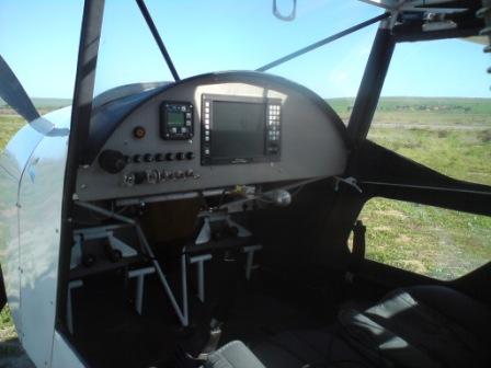

Reg no done. ZU-FIZ
Proving authority submitted apparently caa are on strike (**)
The Spanish have just landed at home and SA is back to normal, strike action and xenophobic violence.
We have done 6.5hrs ground runs and taxi tests and are ready for test flight once the paper work is in place.
