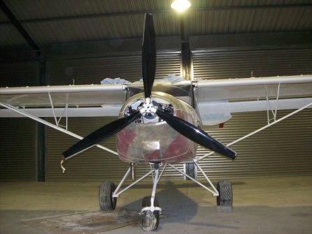

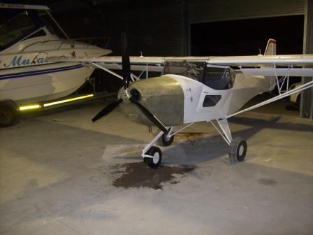

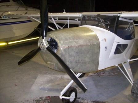

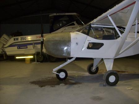

some pics

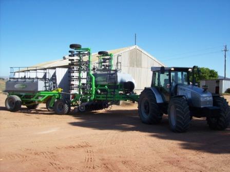

Back on line but still no camera,I have a very stressfull job and electronic equipment tend to suffer when I get BEFOK ##
Looking forward to your visit Boet
the last picture my old camera took .this is a 8meter planting rig I built for a farming operation in Darling
