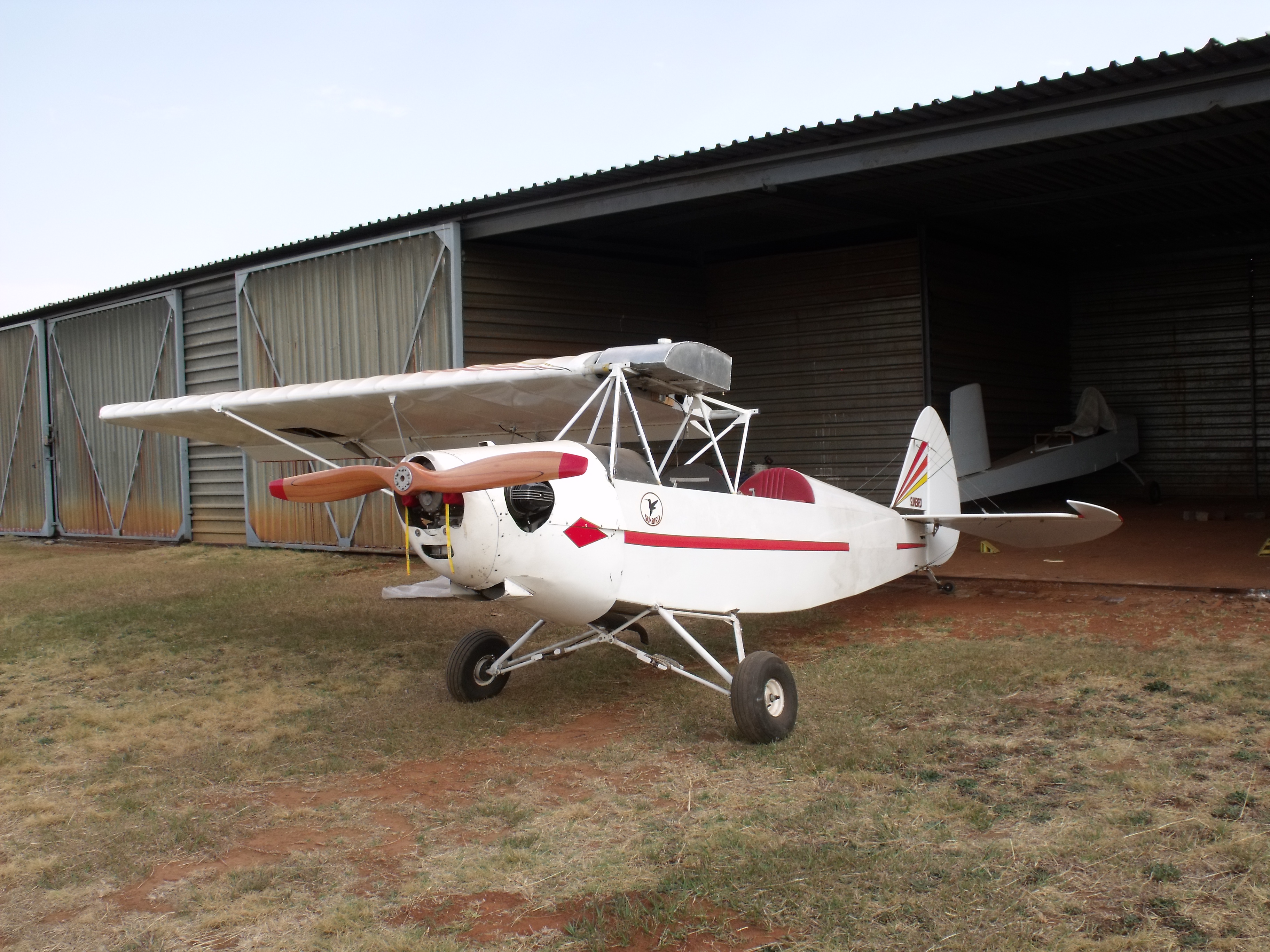

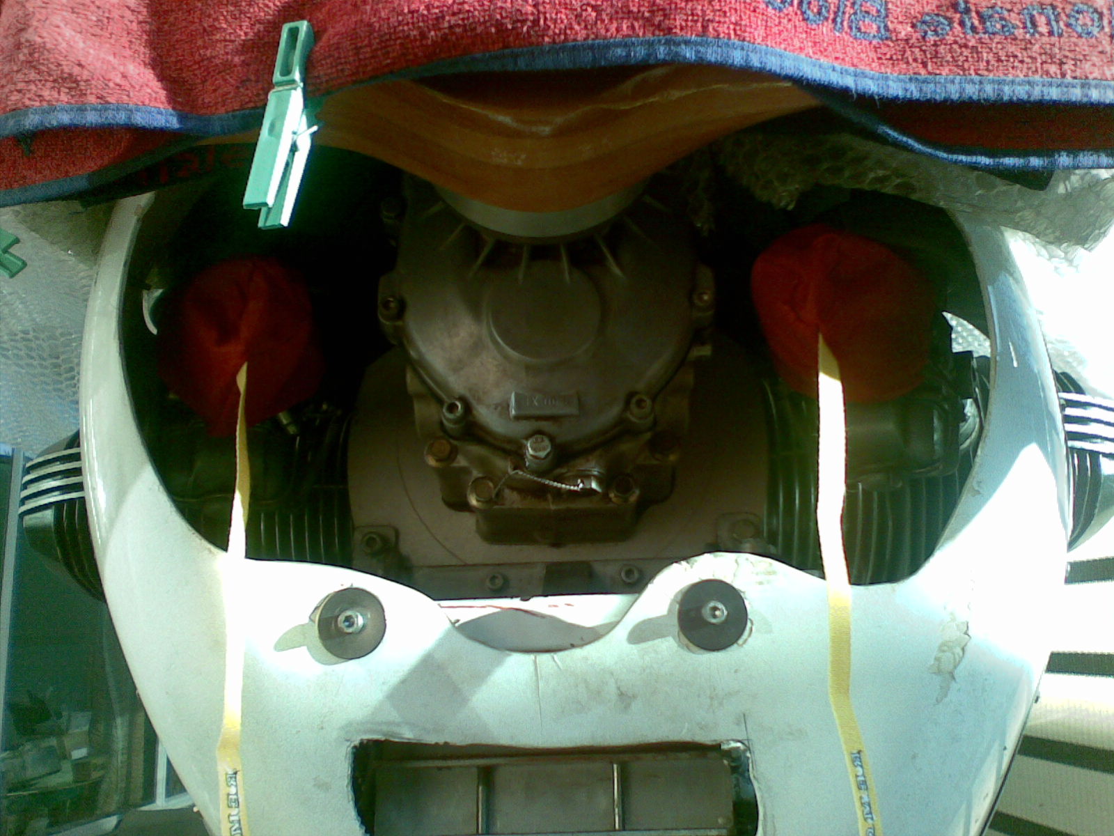

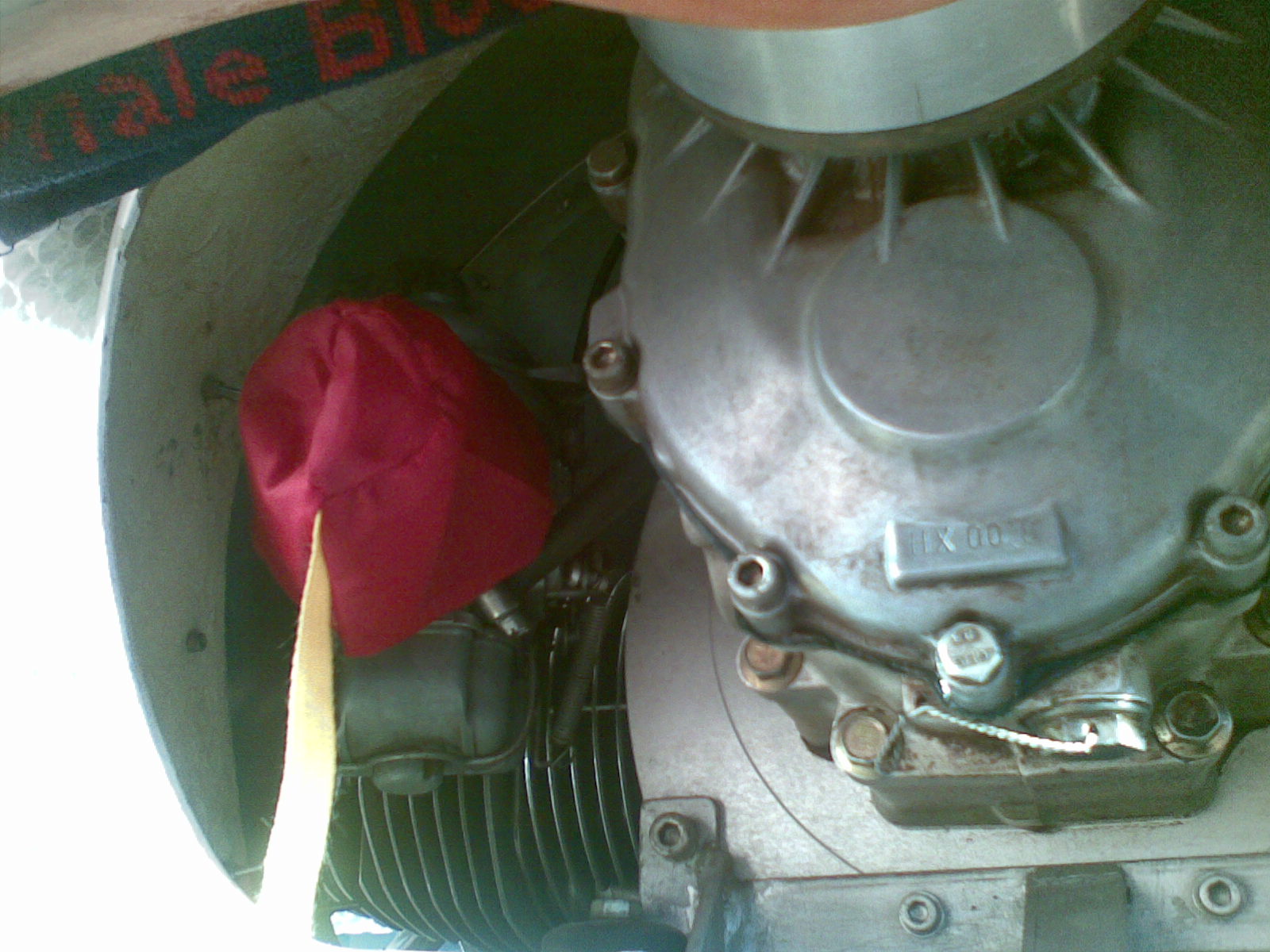

Quick update.
Plane prepped and ready to go to Airfield for Final assembly and Last quirks to sort.
Prop on - Filter covers on. Getting there.
Airfilter Covers on
Closer View
Prop On and Covered

Lyk goed Tailspin
Kort nou net die vlerke en n nuwe locking op ratkas dan dan jy vlie (^^)
Groete

Goose wrote:Lyk goed Tailspin
Groete
Goose
OH SH1T :oops: :oops:
Thanks Goose xxx did not notice that before (**) (**)
Will cut it off tonight and redo ## ## ##
DANKIE - I love this FORUM :!: :!: :!:

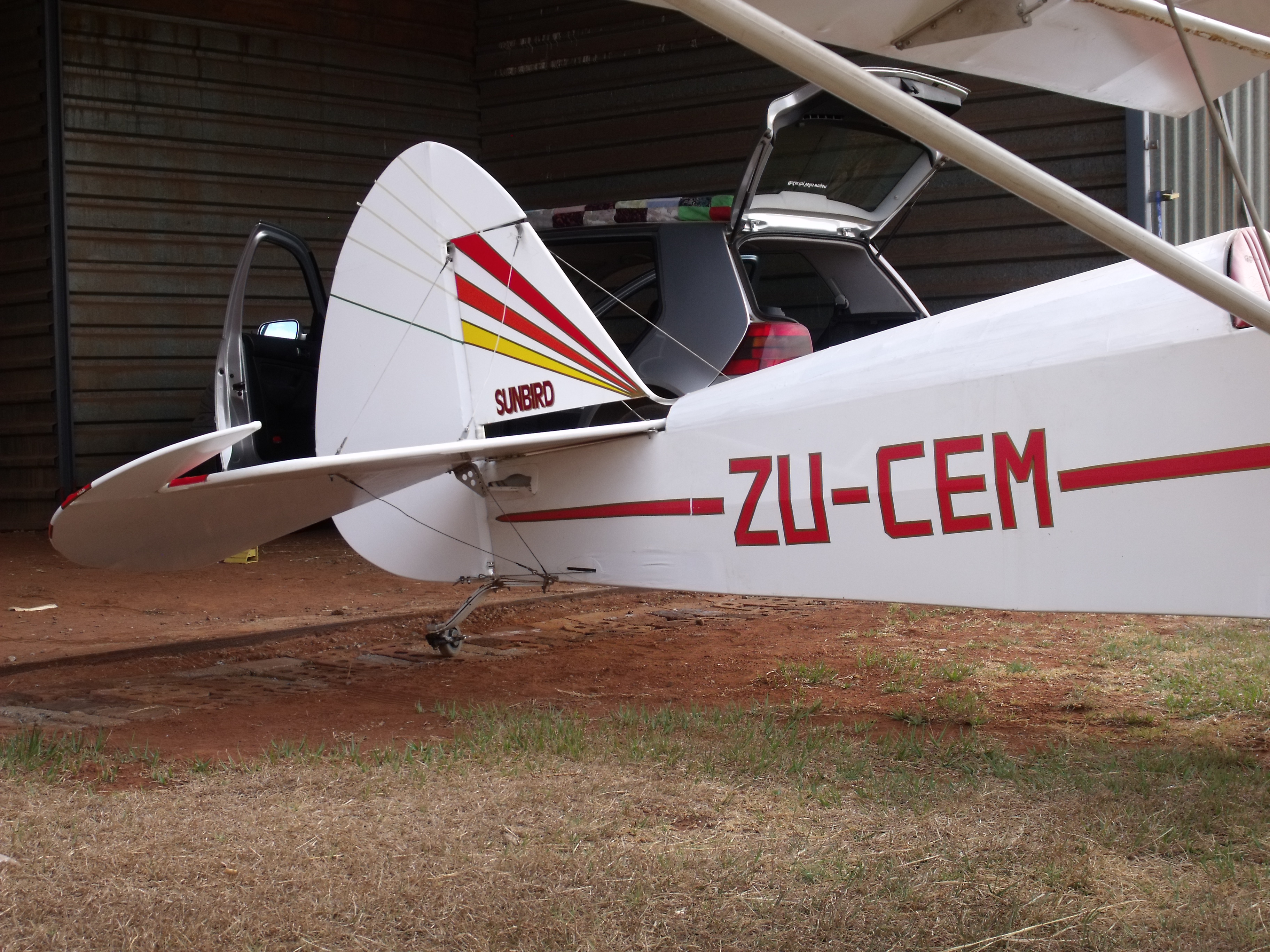

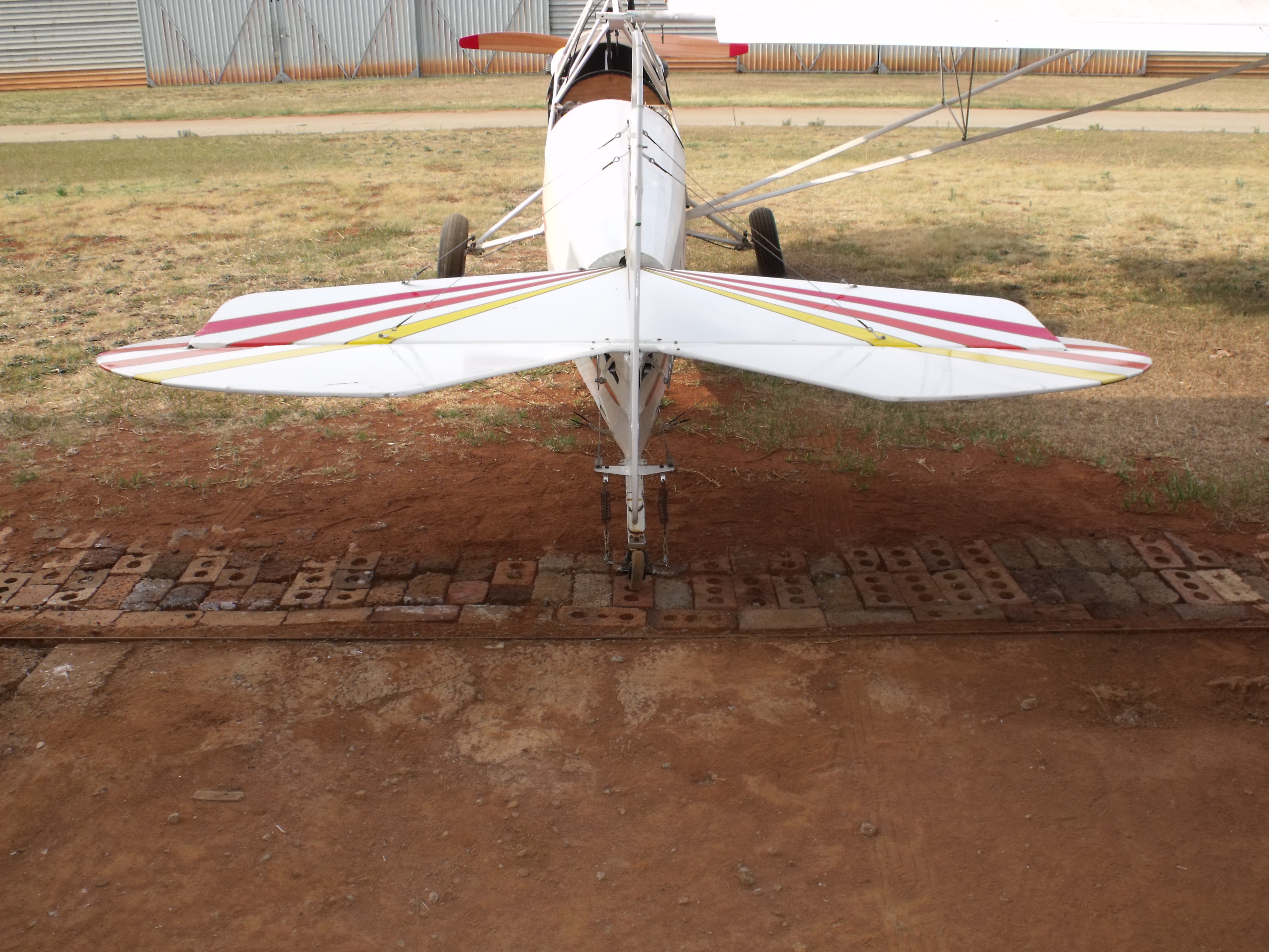

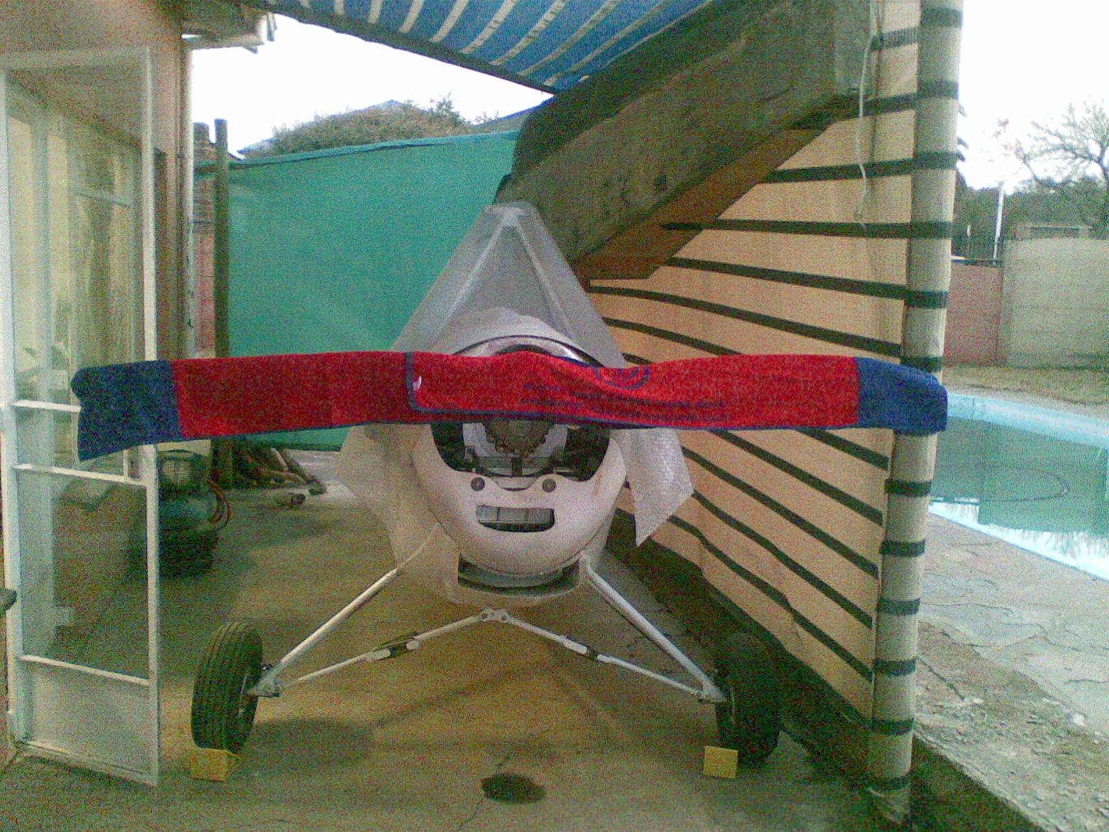

Re: Tailspin's VP-1 Project & Sun Bird Deviation
Postby Boet » Thu Aug 12, 2010 5:32 pm
Gavin, have you checked the wheel alignment? It seems quite seriously out of whack. Toe-out. Ideally should be about .5 deg toe in, otherwise you will only be on the centreline when you go across it!! :lol:

Postby Tailspin » Fri Aug 13, 2010 8:11 am
Boet wrote:Gavin, have you checked the wheel alignment? It seems quite seriously out of whack. Toe-out. Ideally should be about .5 deg toe in, otherwise you will only be on the centreline when you go across it!! :lol:
Hi Boet
The undercarts Bots are not completely tight - that is one of the things that are on the list to sort at the Airfield.
I do not have enough space to get her all lined up and perfect.
I hope to get much of the niglies done at the Field with the plane assembled.

Postby Boet » Sat Aug 14, 2010 8:55 pm
Mogas, have you EVER tried to land a taily on asphalt with a slightly out-of-whack landing gear? It CAN and WILL be exiting to say the least. Ballet or tap-dancing classes do help a bit!!! Tha dang thang just developes a mind of it`s own......... :lol: :lol: :lol:

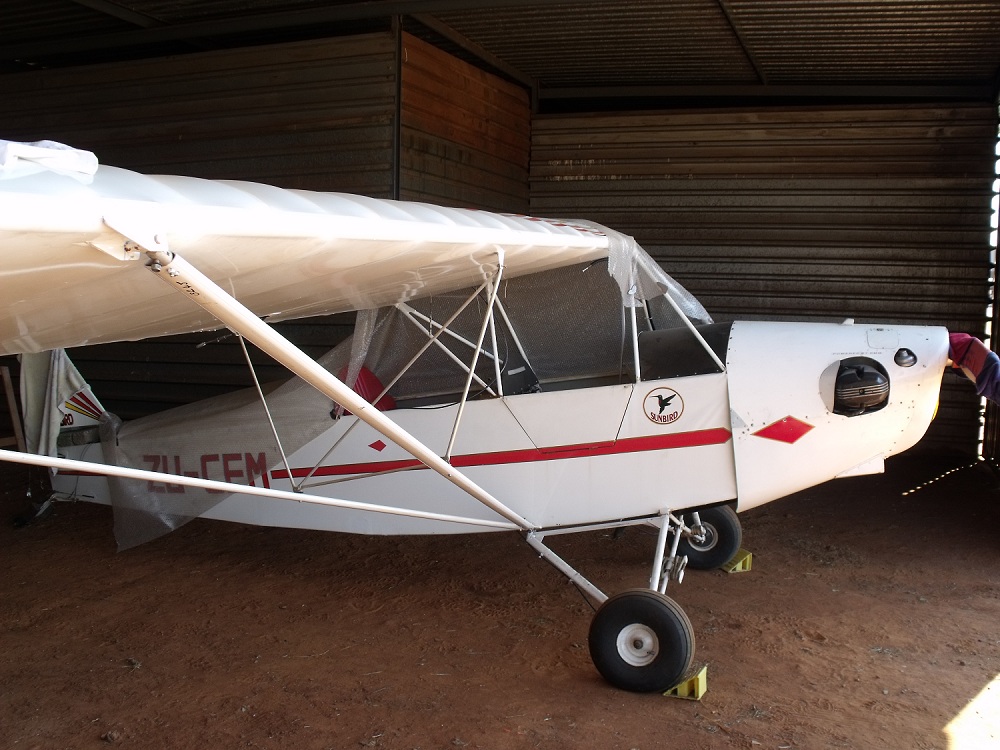

Postby Tailspin » Fri Sep 17, 2010 7:31 am

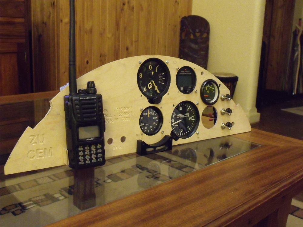

More Pics as Promised.
Dash vhpy
Dash Populated
Sunbird in Hangar and assembly moving along very Slowly :( :(
In her Hangar Assembly going very slow.

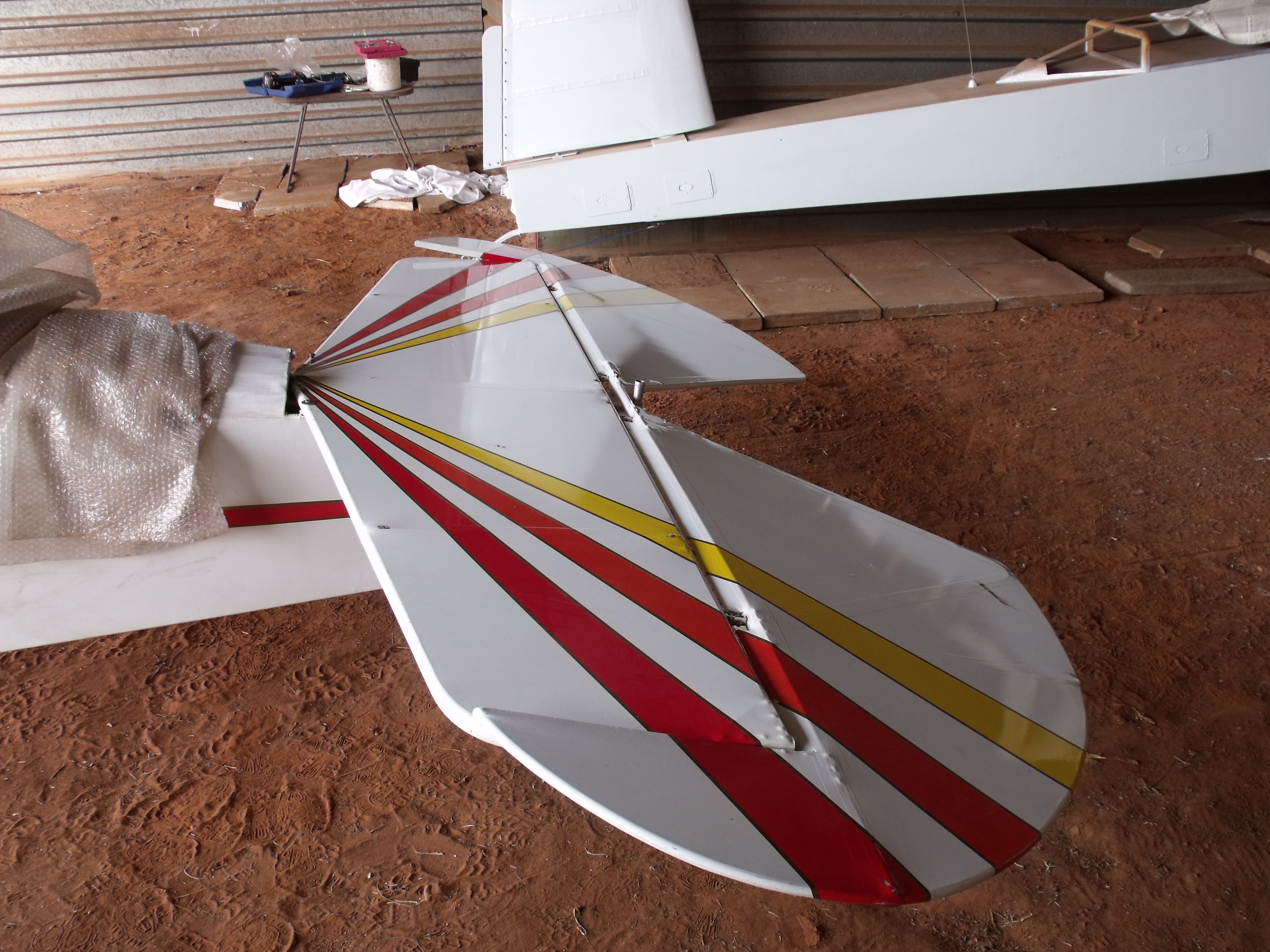

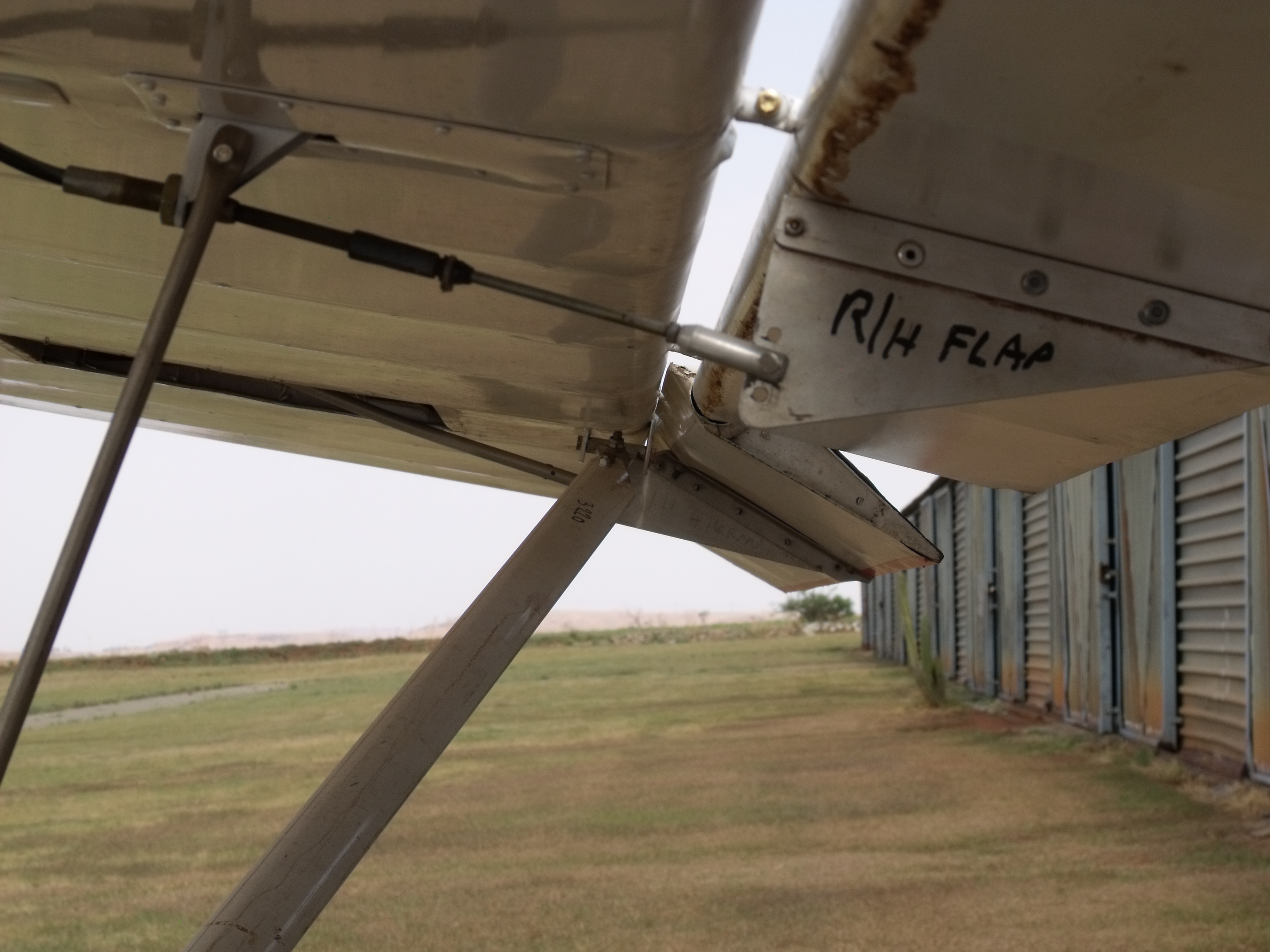

Some More updates.
Rest of Tail assembly put together.
Fuel tank Pre-installed and Fitted. Final adjustments to be made.
New tailwheen assembly busy being fabricated with a slightly more hefty Wheel.
Right wing flap installed and Aileron also installed and tested for Movement.
Controls checked. vhpy
A bit squeaky from all the DUST :evil: But will make covers and try to keep it from getting in everywhere.
