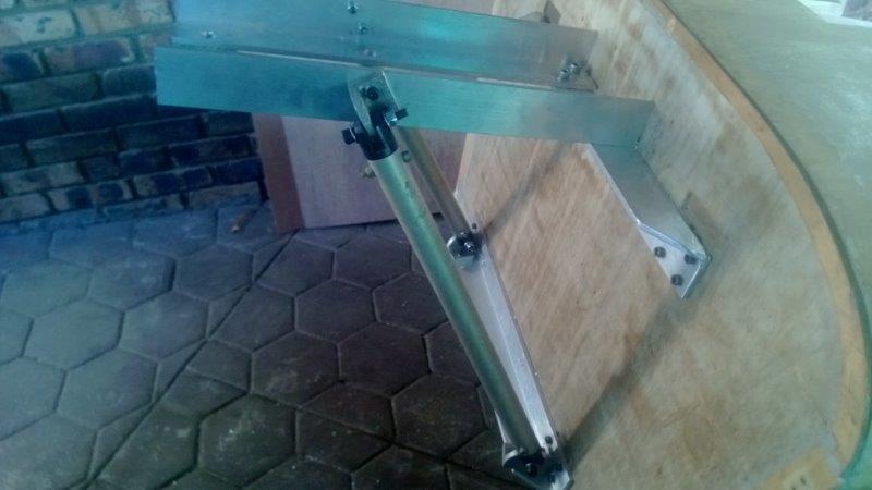

Re: Rotax 583 powered KR2

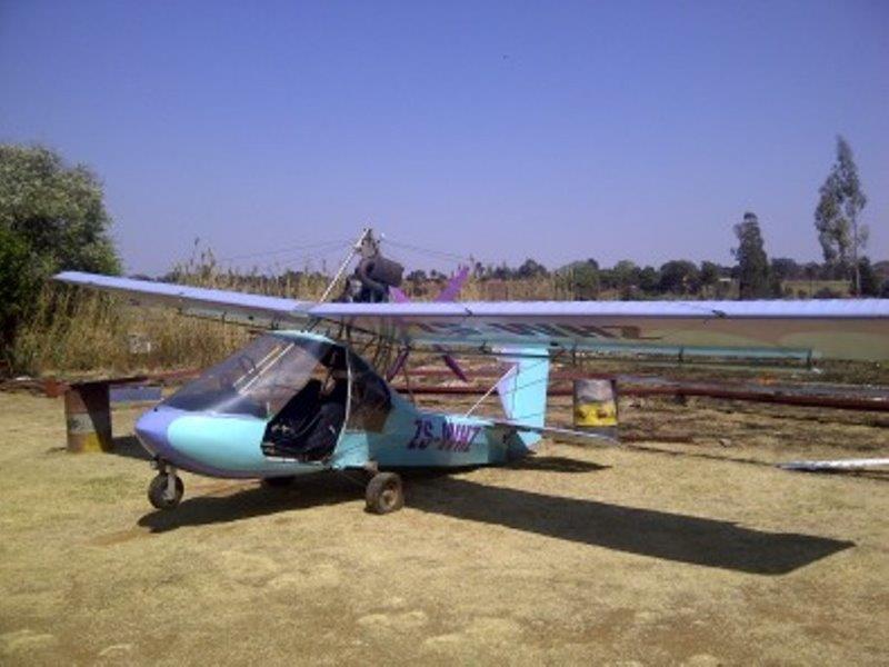

Hi all,

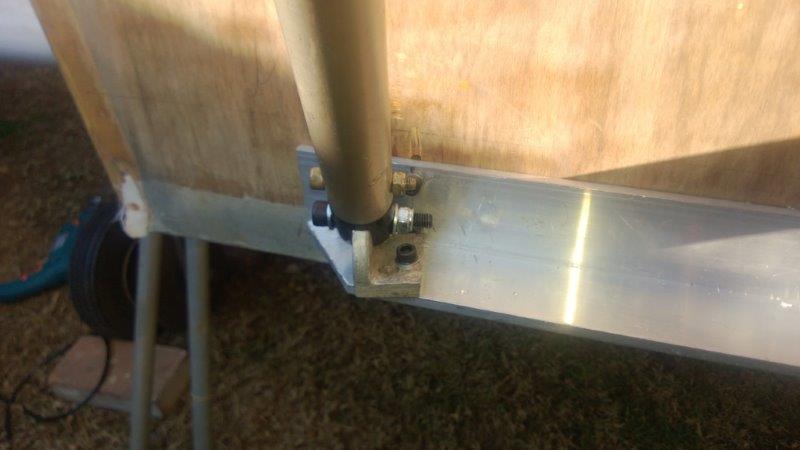

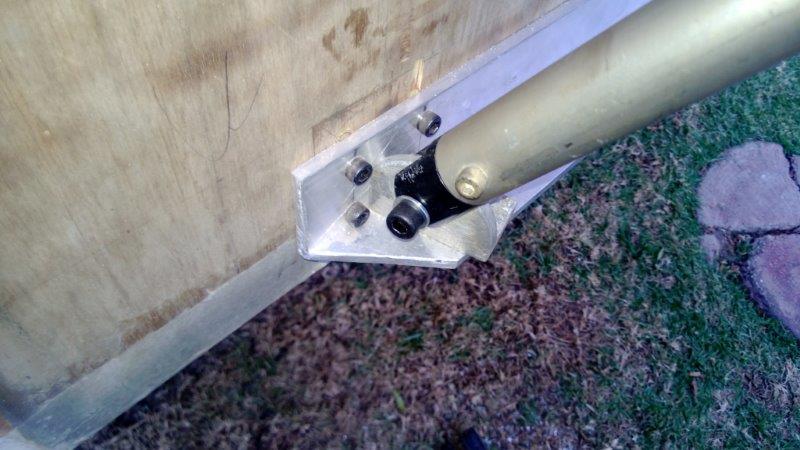

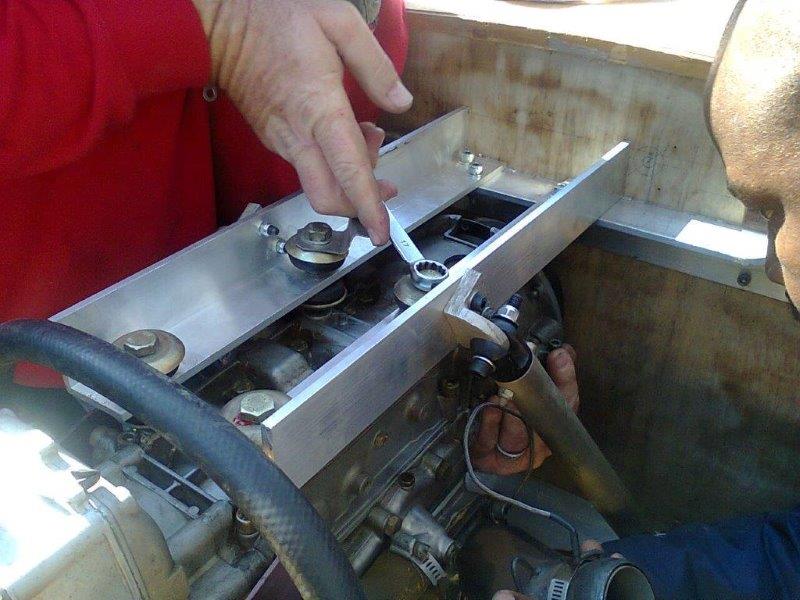

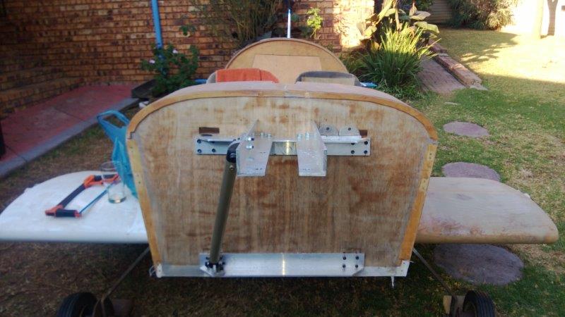

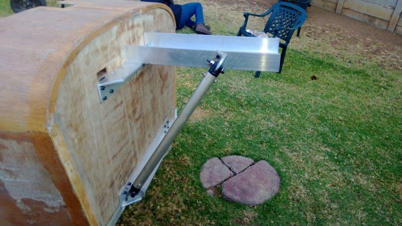

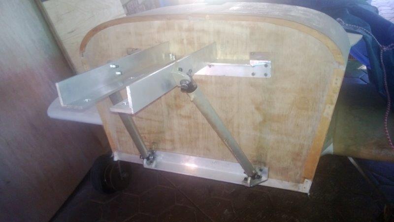

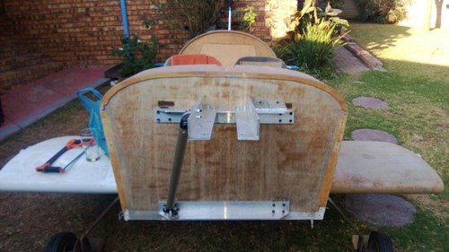

Now only the other side then I can hang the engine! I think my idea works well and this should be one sturdy engine mount. I also purchased all the wood to finish off the widened canopy. However, I'll first hang the engine before I continue with that.

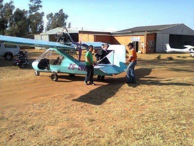

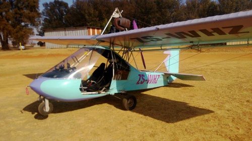

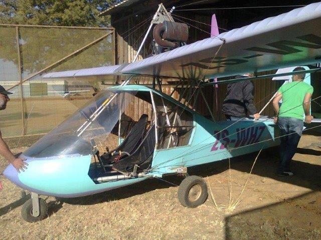

In the meantime I've found myself a Mizer MKIII microlight again. I really like the type and had lots of fun with something similar before - my affordable version of a Cheetah or Bushbaby. Performance wise she's exactly the same. So now I can at least focus on getting my licence current again and can also look forward to some serious flying whilst I'm building. Life is good...
Hi all,
This will be my new baby that will get & keep me flying once again whilst I'm busy building my extremely modified KR2. I'm really looking forward to it. I really looooong to fly again...
Building is nice, but flying is much better!
Mind you, with the current engine & wrong prop combination the KR2 will perform more or less the same: Stall at 45mph and cruise at 75mph. At least a new properly pitched prop will up the cruising speed to around 120mph and later to 150mph when I exchange the Rotax 532 with the Rotax 583.

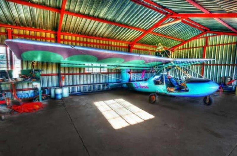

Hi all,
Promise next post will be back to the status of the KR2 project.

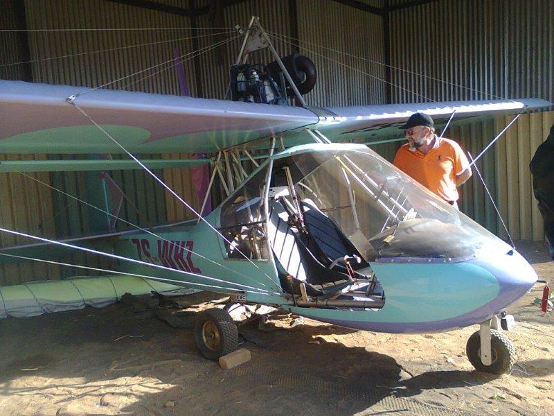

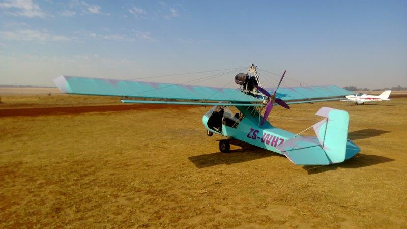

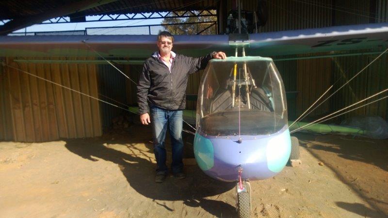

See what my previous Mizer looked like - yet I had tremendous fun with it. This one has much more power, has a far superior propeller, is much more steamlined & does not even look nearly as worn. This time round I'll not be ashamed to be seen in our Mizer. And soon me & Monica will start to go places with it. I'm really looking forward to it all.
Cheers all,

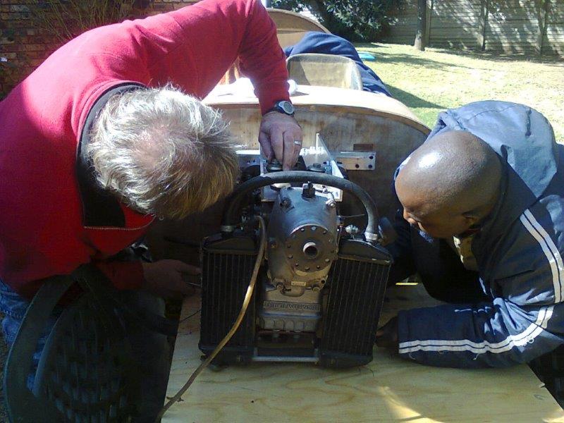

At last! Tomorrow I can hang the engine. Looking forward to it.

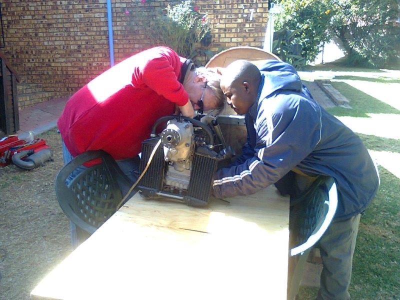

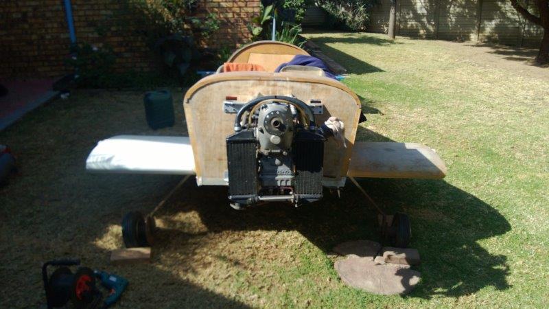

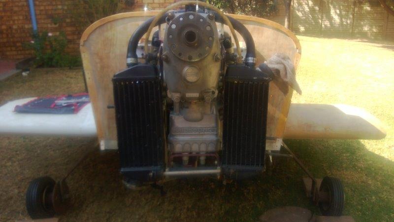

Getting there - slowly but surely. Now at last it looks as if something is busy happening...
Yes, I know - many things are still upside down. I'll get to those in due time!

Tx Byron & Jean!

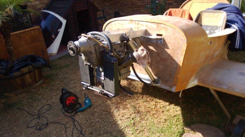

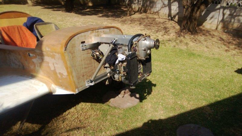

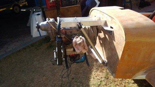

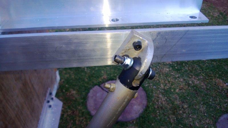

Hi Jean,

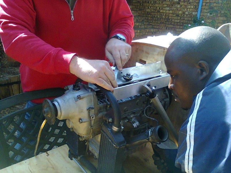

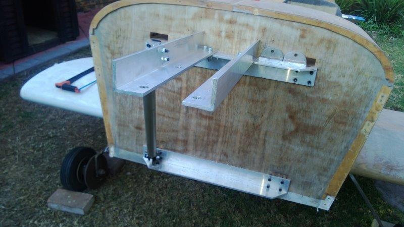

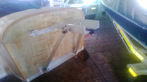

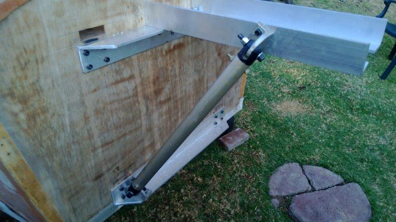

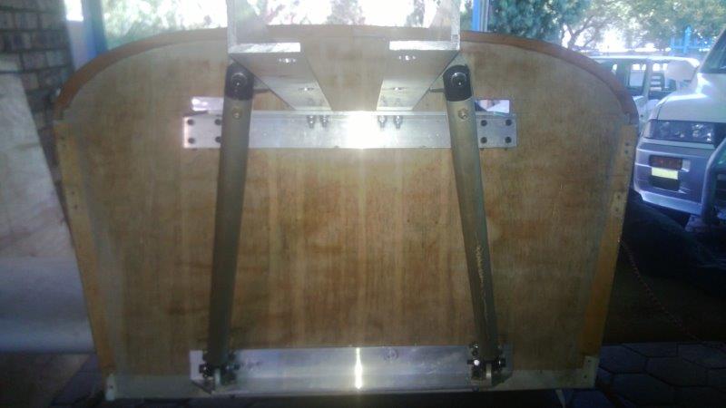

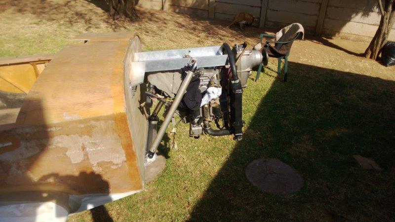

Progress is rather slow as I'm not building from a kit or from plans. Everything needs an idea first before I can fabricate it. All in all I think everything is coming together rather nicely.
Had to remove the carburators & silencer as they are in harms way for the moment. I'll put those back shortly.

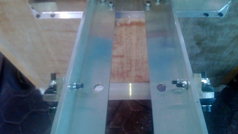

Here's a more detailed view of the engine mount. Notice that rear of engine touches mount. I'll have to remove engine once again and cut slots in top angle beams to clear. So engine installation not done properly yet.
So far most of it fits rather nicely into the existing VW cowling. All I have to do to it is some minor modifications. It would be hard to tell she's got a different engine looking from the outside.
