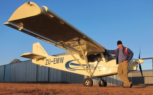

First year's feedback
So here we are a full year since I got the first ATF, got my 2009 ATF from CAA in 20 minutes.
The Sav has done 110 hours in the year, furthest I wandered from JHB was Kroosnstad and Barberton AF. We are planning to go much further this coming year.
Below are all the issues (or work outside normal engine and airframe requirements) I experienced with the Sav since completing the proving flights.
1. 40 Hrs - Chanaged leaking Rotax fuel pump.
2. Rotax decided we had to replace gearbox gears and mine was one that had to be changed. Done by Rotax AMO.
3. Under advice of the Rotax AMO, I fitted a solid elbow to the oil inlet (front of motor, by the fuel pump) which prevents low pressure due to a possible rubber pipe bend in flight.
4. 91 hrs - The fuel low level switch that sits in the top of the fuel header tank started leaking, John Waterson sent me a new one within 3 days (great support !)
5. 95 hrs - The Ac stood outside during rain, I covered the windscreen but the cover flapped on the side scratching the Lexan - Boet's advice of elbow grease and Silvo fixed it to almost new.
6. 100 hrs - Replaced brake disks and pads, at build time I did not ream out the caliper mounting bracket which needs a bit of play, so the disks were shot. In the last 10 hours the disks are still flawless.
During the annual inspection, Fred B's beagle eyes picked up 2 wee issues:
1. Coolant header tank (small round black tank that sits ontop of the motor) was touching the engine block, eventually the rubber would wear away. Fixed
2. Rubber fuel hose between filter and pipe entering engine bay had a small crack on the loose side of the clamp. Fixed by fitting a better sized pipe.
Apart from above the prop has been adjusted a few times to give me the best performance between climb and cruise. I am happy with the DUC windspoon, it is great for the climb, obviously you give a bit away in drag of the spoon end in the cruise.
I am VERY pleased with the Sav's performance and reliability.

Since the first year's feedback (Dec 2008) I have had:
1. Engine replacement at 200 hours - Rotax free replacement - CAM followers not hardened (?) which affected a small number of motors with plenty loose metal bitties looking for something to attack.
2. Fitted a small mode 's' transponder (Trig) so I can fly in controlled areas and big tin can 'see' me ...
3. Changed the prop to a Kiev - better cruise, lost some climb but not much, spinner looks quite nice too
4. Moved from Summit to Crosswinds airfield, much better and a good bunch of people out there
Now on 274 hours and enjoying every minute of flying it
As mentioned in Dec '08 at 100 hours I had to change the brake pads, well, since ensuring some movement on the calipers the 2nd set of pads are still fine
I also bought spare tundra tyres at time of build as I thought they would wear pretty fast, well, the original set still look pretty new
What would I change ? Nothing.... the aerie is great as it is .
If I was to build another arie, what would it be ? - if I could own 2 (for different purposes) then I would build an RV12 for going places and a Sav VGXL (or CH750) for my weekend fun !
Trouble with another build right now is in spending the most valuable resource we have - time - I enjoy flying (and golfing) too much right now..
cheers

Yes, I still have the Sav, it has around 450 hours, has been to the Botswana Delta, KZN and many other parts of our country. I still enjoy every minute flying her.
Issues- the Rotax was exchanged under warranty at around 200 hours due to a faulty batch of engines (cam followers were not hardened properly). Also changed the prop to Kiev, really nice. No airframe etc issues at all. Scheduled maintenance jobs have been painless. Windscreen is getting a bitty old, and will need to be replaced in a year or so. Support from John Waterson the distributor has been exceptional !
I would like to remove the slats and fit new leading edge but I don't want "out of service time" at the moment , flying is just too nice
The new Models are really nice, good cruise with good STOL flying qualities. An Allie aerie doesn't age that fast and mine still looks good after 6.5 years.
Would I buy anything else ? - doubt it as my mission is not commuting but mainly local weekend flying into any small strip where one always meets nice interesting people !
