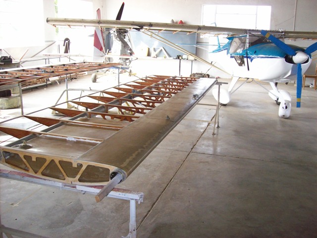

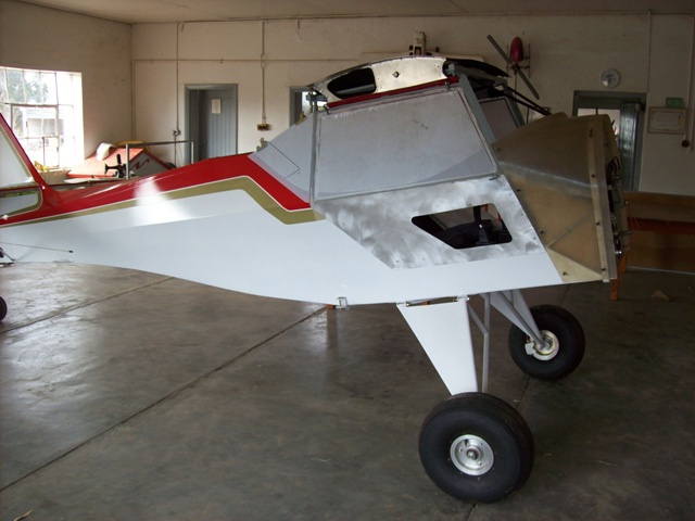

Postby Boet » Mon Jan 14, 2008 10:12 pm
Shop re-opened today. Back to normal: Werk jou gat af :!: We prepped the vlerkies of the Animal, will cover tomorrow. Meanwhile, while last bits of glue dries, we fitted the boot cowl and the doors. Doors and small windows can now be painted and fitted. I took the engine mount with to Cape Town, last week for welding, but the bloody welding shop okes were still on holiday. :evil: Going to CT on wednesday, hopefully better luck this time around :D
Animal nose and doors.JPG (92.06 KiB) Viewed 2185 times
Animal vlerkies.JPG (97.57 KiB) Viewed 2184 times

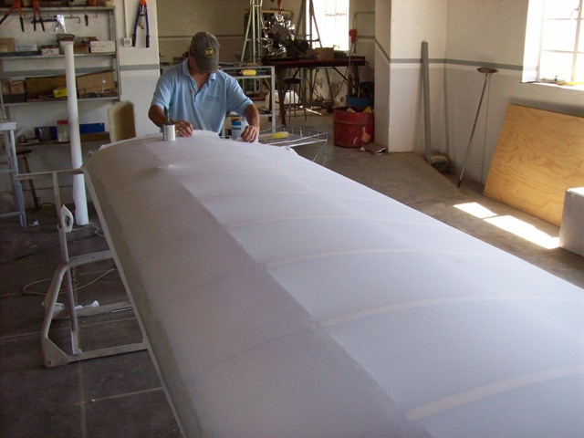

Postby Boet » Wed Jan 16, 2008 12:12 am
Covering going on.....off to Fairest tomorrow, to put little Softness on plane to UK. A prospect I do not look forwards to. :cry: By the time I return on friday covering should be completed. Lads well trained, motivated and VERY proud of the quality work they put out. :D Hopefully will return with the welded engine mount. Then we can hang the clockworks :!: :!: :D :D :D

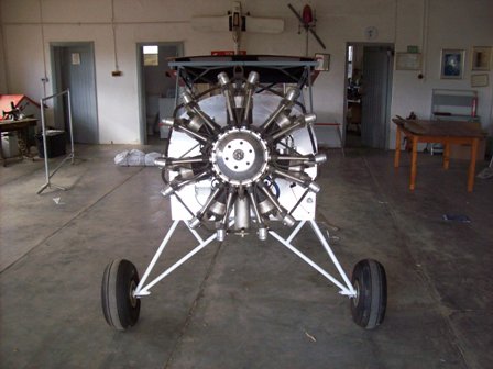

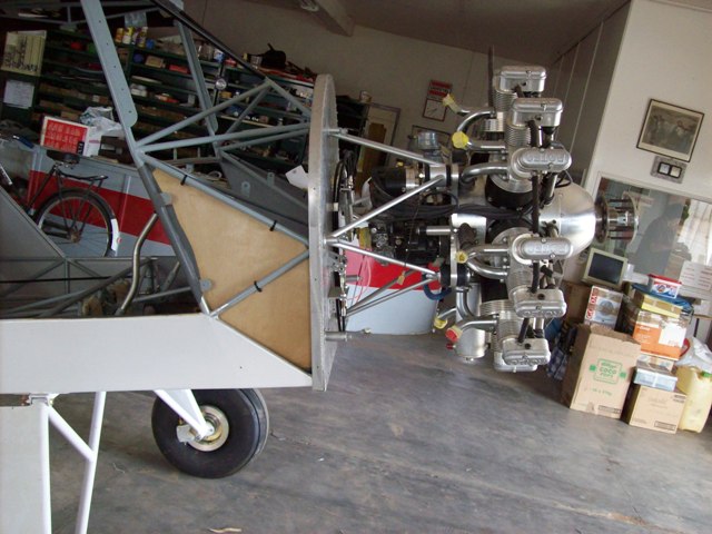

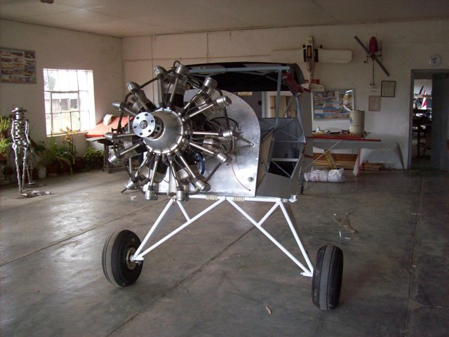

Postby Boet » Sun Jan 20, 2008 11:07 am
Back from the fairest. The engine mount has been welded, and now the clockwork-fun part can begin. The lads were very busy, and finished the wing-covering. :D Just the rib stitching left....

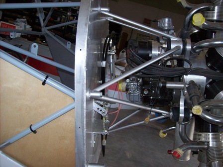

Postby Boet » Mon Jan 21, 2008 11:14 pm
Now the fun and games is really on. You laaaik?? :D :D The engine mount fitted 100%. :D
clockworx on.JPG (75.25 KiB) Viewed 2382 times
Postby Boet » Mon Jan 21, 2008 11:20 pm
More......
head on.JPG (44.09 KiB) Viewed 2378 times
Mount detail.JPG (66.32 KiB) Viewed 2378 times

Postby Cloud Warrior » Tue Jan 22, 2008 1:16 am
Can't wait to hear what she sounds like - I love a radial.
Are you going to fit a cowling Boet? How are you going to finish her off?
