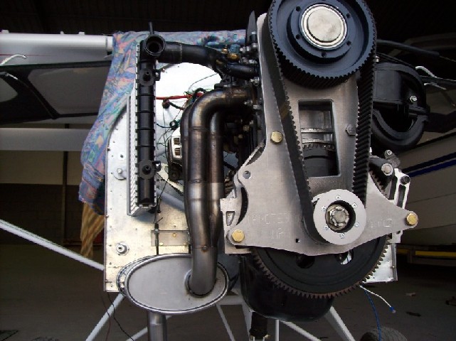

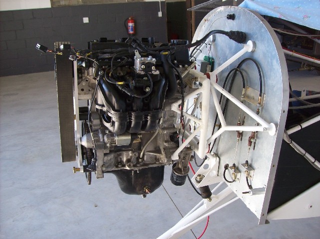

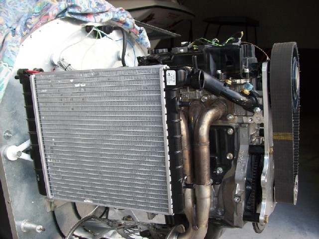

The YARIS engine was started today but not without some teething problems . The engine was assembled and the redrive fitted a metal sump replaced the aluminium one . The engine I am using comes from a Daihatsu and has power steering pump and aircon compressor , it also had external exhaust gas recirculation which were all removed. The bolt pattern also differs from the Toyota ,Renault and Peugeot engines fortunately the guys from Ecoyota left the mounting holes and external profile of the redrive plate blank and with some old school engineering I indexed the bolt pattern using the crank shaft as a reference the holes were drilled and used to plot the external profile and milled in a cnc machine .The oil filter housing on this engine uses a cartridge filter element which is not freely available and bulky ,the housing was modified to accept a normal screw on filter . A union was welded on to the metal sump to accept a oil temperature probe the oil pump pick up is further away from the sump floor than on the aluminium sump ,as it is a plastic unit it not easy to extend ,I will machine a spacer with the necessary porting that will fit between the oil pump body and the plastic pick up .Fitting the adapter plate for the redrive required removing some coolant hose tails that press fitted into the cylinder head ,some minor cutting ,filing and drill and tap 3 m8 holes,plugs supplied in the kit were installed to blank coolant ports not required.The rest of the conversion required no special tools or machining

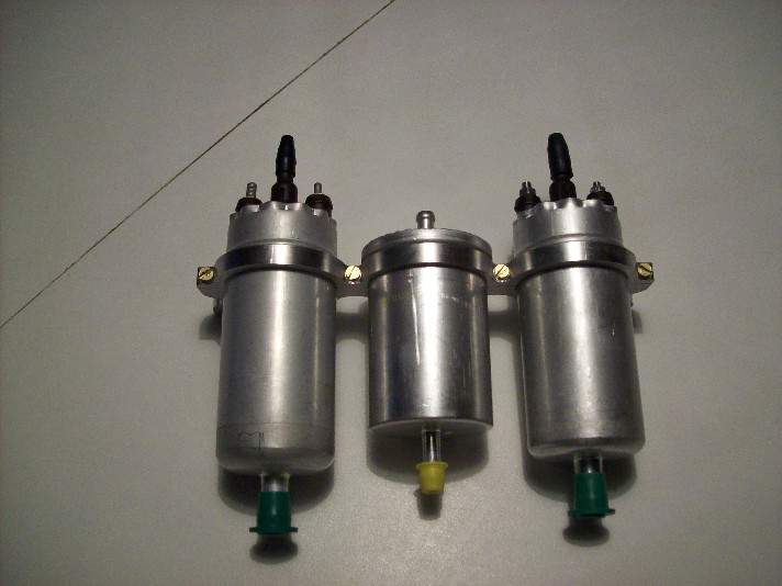

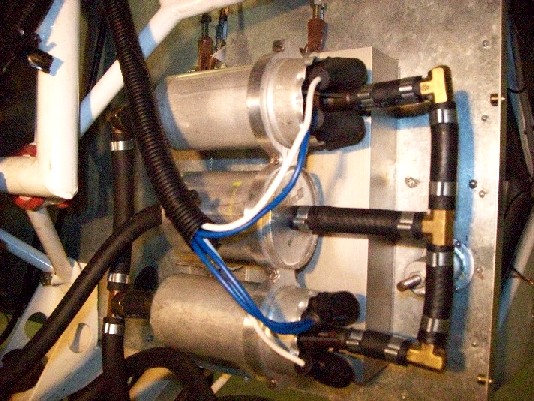

The fuel system consists of a non return valve on the suction side of the high pressure pump ,filter and pressure regulator 2.5 bar with return to tank.will fit a second pump.

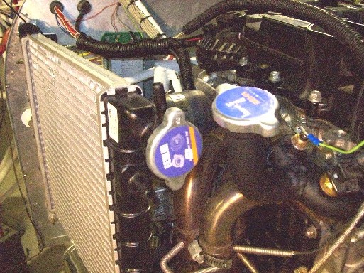

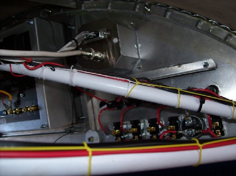

The engine wiring harness is of high quality and fits perfectly ,the loom is split in two sections ,cockpit and engine bay, and joins through the firewall with a bulkhead plug ,the ECU is contained in a FARADAY enclosure and is equipped with a static port for altitude compensation a serial port is supplied to connect to pc for diagnostic and data transfer.There is no mounting holes in the enclosure so silent block mounting will require a clamp bracket to be made.

I don't see check valves on those pumps, will it not return through the non working pump when you do run into a pump failure ?
- Passed radio course
- Posts: 68
- Joined: Thu Nov 19, 2009 7:29 pm
Re: TOYOTA YARIS ENGINE
Good observation Smallfly . I have not run the engine under full load yet still waiting for the prop but at max rpm no load the fuel pressure remains constant with standby pump down.this is something that will go on my test list
