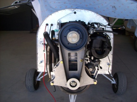

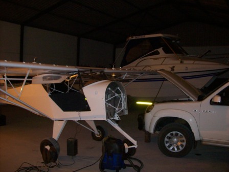

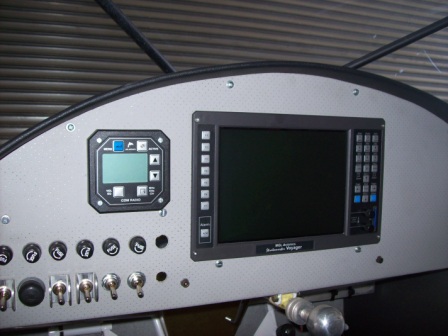

We are going to start the Yaris engine tomorrow ,some pictures of our progress.
- gerald photos 336.jpg (54.69 KiB) Viewed 4701 times
- gerald photos 344.jpg (66.72 KiB) Viewed 4696 times
- gerald photos 351.jpg (66.45 KiB) Viewed 4696 times
Re: TOYOTA YARIS ENGINE
Dieseldog just phoned me to let me hear what the Yaris sounds like. ( Noisy, for still no silencer....
), but running.
