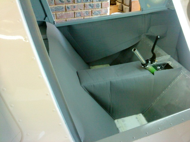

Re: Justin's Raven
At the moment I am discovering the aircraft version of the ancient chinese torture 'death by a thousand cuts'.
Not just the physical cuts from working deep in the guts of the central tunnel, and tailcone, but mentally too. There is so little left to do, but there seem to be a thousand small tasks. Each takes from a few minutes, to a few hours to complete, but when you are done, you seem no closer to finishing!
The internal upholstery and trimmings are just about done, the electric trim is getting there, the wiring is just barely started, finally (i hope) sorted out the brake handle on the stick.
Slow (and not very steady) progress, but I really hope to be airborne within 2 months now.

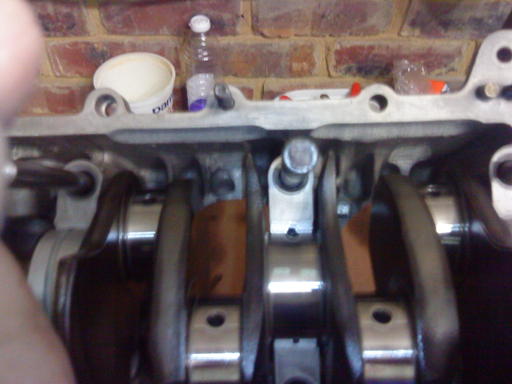

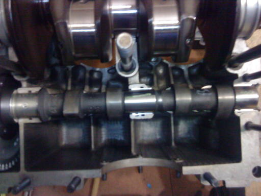

Finally... Spent the last two weeks building 3 different iterations of the throttle linkages. Each useless in its own little way. Finally got something workable - and it even fits when the fuel tank is in - there really is not much space up front!
Anyway, with the last of the metal work out of the way, I spent about two days cleaning the workshop - getting rid of every trace of metal shavings/dust from all the metal work - and this evening I finally started putting the engine together.
First step is the dry assembly - to plastiguage all the journal clearances. Crank and cam clearances are spot on - near the top of the VW 'new engine' spec. Cam end float is too tight though, so I will need to sand down the flanges a little (these are 'double thrust' cam bearings - not the stock VW bearings. Only measured one big-end so far, and it was quite tight, but still within the 'new engine' spec. Took 3 times to get it right. It is insanely difficult not to move the rod while torquing/loosening those nuts.
Will finish the other rods tomorrow, and then see how far I get with the final assembly (won't be _that_ far though, as I bought the wrong case nuts).
Plastiguaging the journals:

Re: Justin's Raven
Justin,
From my experience assembling an engine, you assemble it bone dry and then the engine must be able to turn by hand I'm talking about the bottom end you actually torque up the whole bottom end . Then if it feels stiff you can take it apart and you can see whatever rubs or is tight. Some times a hard soft-hammer and a tap on the big-end cup helps to free a conrod they must be able to fall freely under their own weight.
The final assembly again is dry and when all is free you put in oil in the feeding channel from oil pump and with oil and compressed air you blow till oil comes out of every journal and then the bottom is finished oiled and ready to accept the cylinders. It is of course necessary the measure everything I have seen the wrong bearing caps come out of a sealed package. In my student years I used to rebuild a motor every 14 days to help pay for studies and to fly. That was 45 years ago.
You can give me a call if you like to. Is it a type 4 ?
Cheers Oupa-G
Cheers Oupa-G
