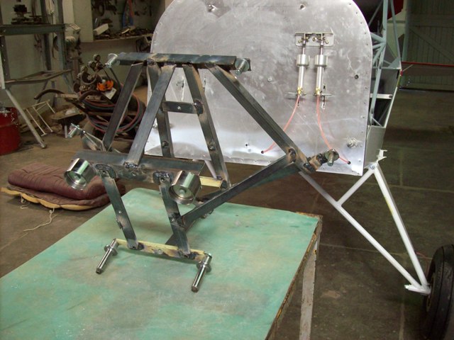

I completed the jig for the engine mounting today. Now need a coded welder to weld the pipes in. :D
sweis res.JPG (66.95 KiB) Viewed 4763 times

And I bought some 4130 1/2" OD tubing today to weld up the mount. I have to mitre all the tubes, and I found a well qualified coded welder in CT who will also give docs on the engine mount weldment. Now all I need is a little time. If this year do not run out too fast, maybe I can hang the radial....... :D :D :D

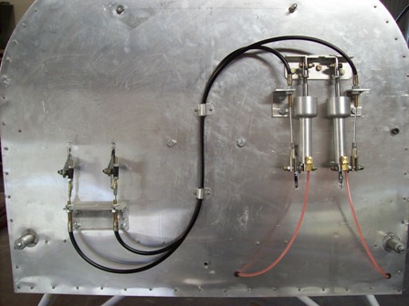

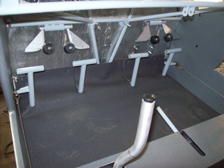

:D Da dual brake system. It WORKS :!:
Dual brakes.JPG (53.21 KiB) Viewed 4646 times
brake pedals 2.JPG (42.83 KiB) Viewed 4643 times
