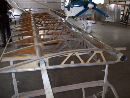

Today we glued the glasfibre leading edge panels to the wings. You will notice that we hang the wings in a vertical position. ( LE up) The reason? If you glue the LE panels on with the wing laying flat, it will take a slightly "bent" permanent set. :shock: Nothing like experience.... While the glue dries, I have started on the brake system. I understand that you guys want DUAL brakes. OK, Dual brakes it will be. :D

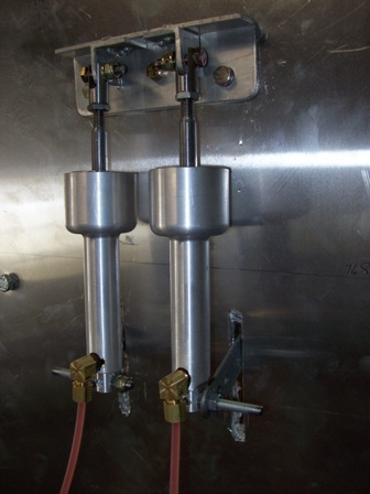

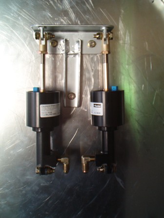

Master cyl`s. Note this is not the animals`. :D I was out on other bussiness today. Pics will follow tomorrow. While I was out the lads finished fitting the leading edges. We do the sections over the petrol tanks last, because you cannot RIVIT :lol: the LE panels to the tanks? :oops: So they have to lay flat with a couple of weights added untill the glue sets. Fhoto added by kind request for MOGAS
Brake master cyl`s.JPG (32.3 KiB) Viewed 2000 times

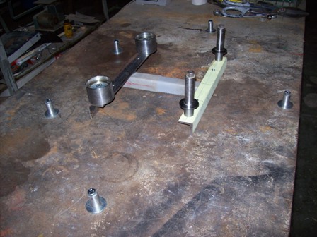

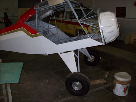

Brakes conected, fitted, fluid in, bled and WORKING. Seriaas brakes. Oh yes, and I found the right cowling. OK?? :D And another one of the brake pedals inside. It may LOOk a bit akward, but belief you me, this system, once you are used to it, really works best on these aries. ( I have tested the whole bloody shebang. :evil: )
I am moving my spray shop this week, so could not really work on the aeries a lot. Next week: FULL steam ahead again. I got fed up for constantly having to carry the aeries around to the adjacent building. Not good for my buggered back. :cry: Everything is now under the same roof, and the adjacent building is up for sale. :D

Mmmm... jammer man, ek het al weer drooggemaak met die fotos se laai. While I got busy figuring out the engine mounting, the lads tackled the wings. Do you want 2 lights in the wing tips? NOT landing lights, more like "HERE I AM !!! lights. ?? :D :D
:D So jy dink daai cowling is mooi?? :D :lol: :lol: :lol: :wink:
