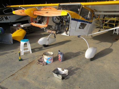

I recently did the 100hr inspection and service. Found nothing wrong with the inspection so it ended as a service which was oil filter Fuel filters pre and main checked the valve clearance no change then cut open the oil filter not even a bit of carbon. This is a good sign. Carbon normally comes from the bottom of the piston if the piston runs hot and then carbonizes the oil. This fits in with the oil temp where the sump oil temp runs at 85 C the oil from the valve gear comes into the radiator max 115 and leaves the radiator at 85. The exhaust is working well as well as the voyager driving the autopilot. She has done 107 hrs just running sweet. Because of these results I have decided to make another batch of ten components to help people with conversions. I was a bit cautious supplying because I had to first Iron out small problems. There is nothing worse then supplying somebody with something that does not work. The force landing I did in Namibia was totally unexpected but the clutch coupling that I have now made has changed the running of the engine to a turbine.

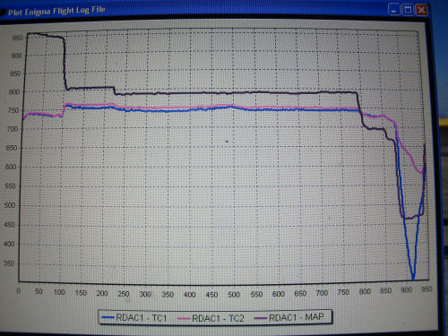

Enclosed some foties have a good look at the EGT's on the graph The tuning of the EboXi's took some time as I was changing the amount by 2% at a time . I'm getting there this even burning is part of the smooth operation engines to rich and to lean run rough. I so wish I had support but in the end I'm just a one man band. Comments will be appreciated because then I can answer them. Just writing and getting no feedback wears one out.

- The cowls are of
- service 1.jpg (58.36 KiB) Viewed 53408 times

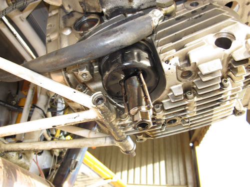

- Special tool to undo filter
- service 2.jpg (69.5 KiB) Viewed 53406 times

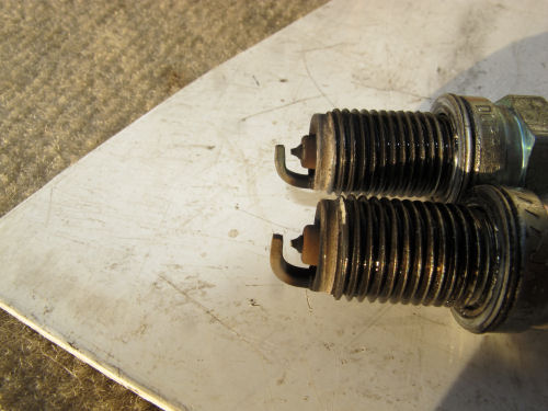

- Plugs lovely colour but I replaced them they are Iridium plugs the next set I will take to 200 hrs
- service 3.jpg (48.28 KiB) Viewed 53406 times

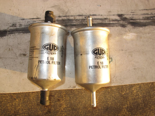

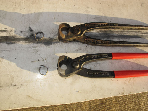

- Main fuel filter I cut the rubber fuel line there is sufficient lenght after the third year I replace the fuel line I still use Oetiker clamps they are wonderful
- service 4.jpg (53.55 KiB) Viewed 53406 times
- The proper tools for the Oetiker clamps
- service 5.jpg (49.1 KiB) Viewed 53406 times

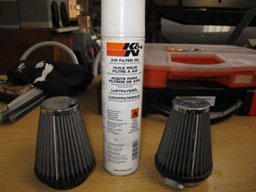

- Air filter cleaning as per K&N instructions
- service 6.jpg (47.55 KiB) Viewed 53406 times
- Typical engine temp graphs with the refined engine management tuning the helps with smooth running top graph is the manifold pressure bottem two graphs teh two EGT's Note the lower temps at full throttle mixture richer at full power as soon as the manifold pressure drops the mixture is leaned and hence the higher EGT's
- service 7.jpg (60.21 KiB) Viewed 53406 times
- Ready for test fly
- service 8.jpg (52.34 KiB) Viewed 53406 times

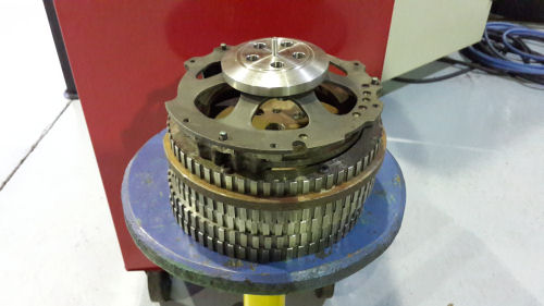

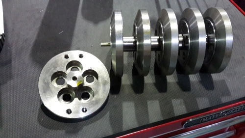

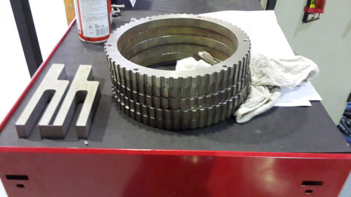

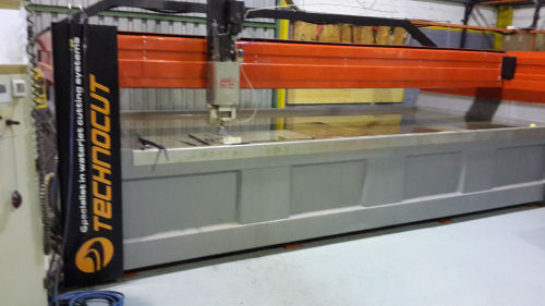

Just some pictures from my mobile phone these are the newly machined Flywheel part the extra weight on the flywheel doubles as an extra 60-2 pickup they are back for the fitting of the dowels once that is done they are of to the balancers. I have customers waiting for these parts so Sacha you will not have to wait to long now. The clutch couplers still need the final cut on the threads then they are also finished. THE Waterjet machine was newly installed at a friend of mines workshop and I can slip a job in when there is space on the machine the 60-2 gears were waterjetted and then the dowels that take the force of the starter ring gear are done on the indexing table.

- WaterJet machine
- Flywheel 1.jpg (45.67 KiB) Viewed 53405 times
- Flywheel parts
- Flywheel 2.jpg (42.38 KiB) Viewed 53405 times
- Some more 60-2 parts
- Flywheel 3.jpg (43.89 KiB) Viewed 53405 times
- New clutch couplings machined to close tolerences
- Flywheel 4.jpg (46.08 KiB) Viewed 53405 times

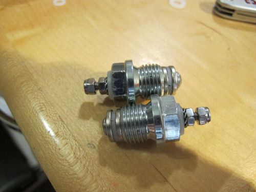

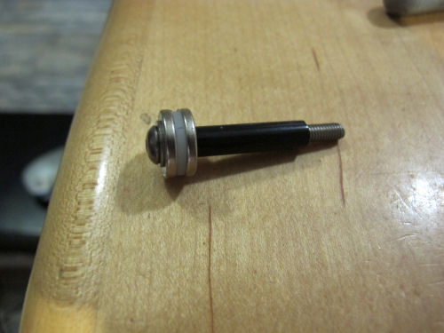

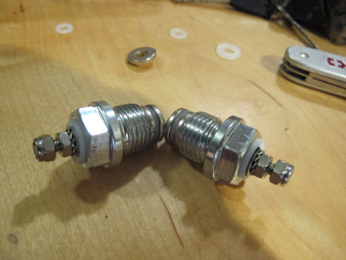

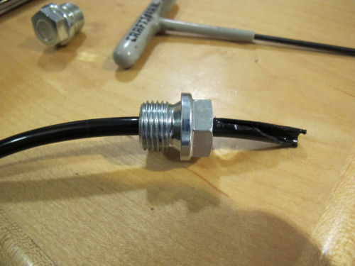

It has been a long time not posting. But I fly, busy refining the installation and bringing monitoring of the engine to a higher level. Reading about the Prieska accident with its very sad outcome, it is our duty to try and foresee potential problems. The gearbox has not been without problems and I'm in close contact with the makers of the gearbox. One bearing had a higher rate of failures and the new housing is made to take the new enlarged bearing. This made me think there is excellent monitoring in helicopter gearboxes as well as our gearbox on the PC12 in the form of Chip Detectors A chip detection calls for grounding of the aircraft.
I could not find a suitable reasonably priced Chip Detector so the answer was make it yourself . With the help of Ystervark on the net he found nice magnets look like a washers and the best of all the supplier is in Somerset West. He picked up the magnets and I did the machining and attached are the foties of the final product. The sensitivity can be adjusted by spacing the magnets further apart. The normal metallic dust particles will set of the warning light. What is wrong with an additional oil change its only 200cc of oil. It may save a forced landing. Any forced landing carries its risks. Chips will give a definite red light.
The insulating materials can withstand the temps of the gearbox, if I have to use this Chip detector on an engine I will use a different insulation material but there are no ball or roller bearing in the engine.
It is said that 5% of bearings fail within the first 10% of their life. How they came to these figures I do not but I do know from own experience that bearings fail.
I just want to add that the valve clearance that I measured at the last service was the same as I had adjusted the valves to 100hrs ago. So it was a check no adjustment necessary and the valve play was again noted.
Happy flying
Cheers Oupa-G
Happy flying
Cheers Oupa-G

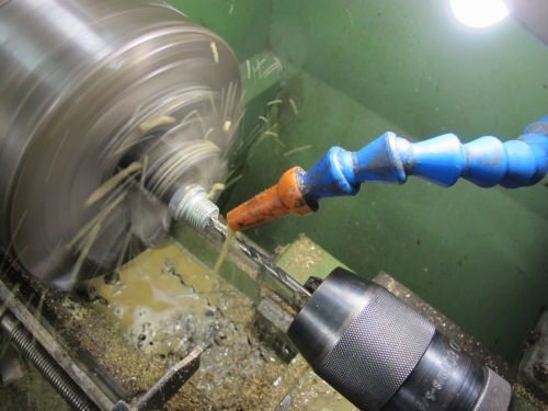

- Sump plug in lathe
- Chip detector 1.jpg (49.31 KiB) Viewed 53045 times

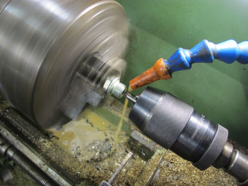

- hole drilled to 5.5mm
- Chip detector 2.jpg (48.19 KiB) Viewed 53045 times

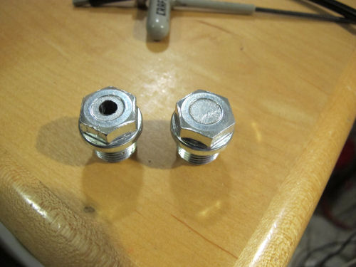

- Sump plug with hole, hole in magnet is also 5.5mm
- Chip detector 3.jpg (39.82 KiB) Viewed 53045 times

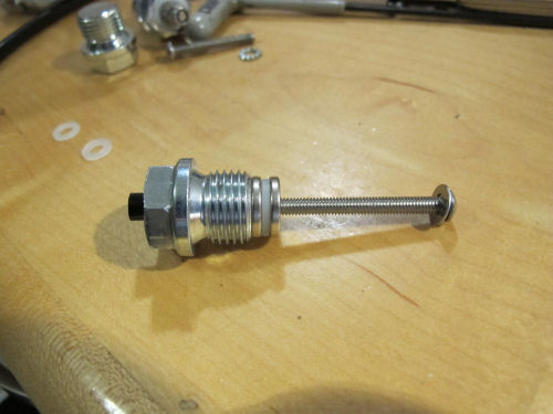

- the assembly that will fit inside plug
- Chip detector 4.jpg (37.9 KiB) Viewed 53045 times
- 6mm pipe pulled through 5.5mm hole and the cut to size
- Chip detector 5.jpg (39.29 KiB) Viewed 53045 times
- 4mm screw to screw cutting thread into pipe and holding magnets
- Chip detector 6.jpg (37.66 KiB) Viewed 53045 times
- these are these super magnets just see how the single magnet disc levitates in the background
- Chip detector 7.jpg (40.09 KiB) Viewed 53045 times
- just a close-up of final product
- Chip detector 8.jpg (40.05 KiB) Viewed 53045 times

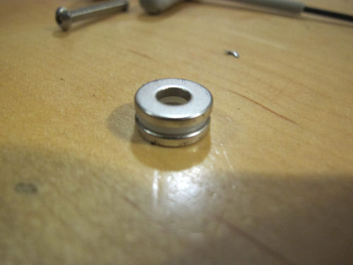

- magnets with insulating spacer
- Chip detector 9.jpg (29.36 KiB) Viewed 53045 times
