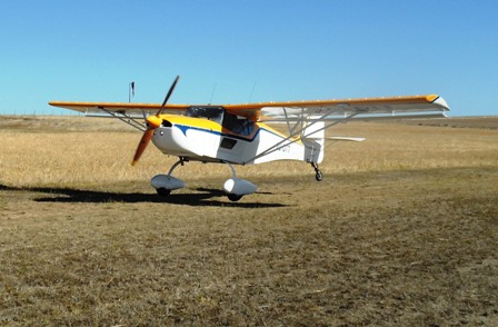

Just to show it`s still there! The front screen was too thin, and dented in when flying fast, so we had to go from 1.5mm lexan, to the next size up: 2mm. Problem solved.
- OTT STOL.jpg (27.91 KiB) Viewed 46681 times
- OTT Soft landing.jpg (42.79 KiB) Viewed 46681 times

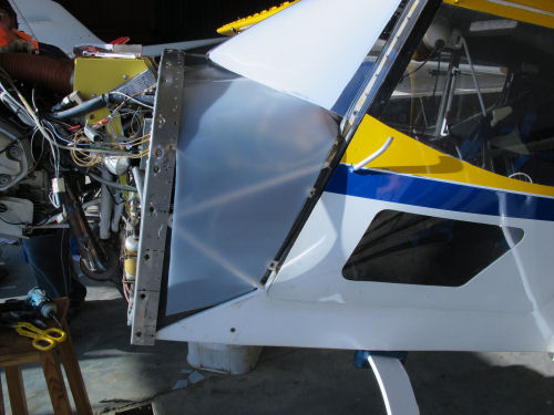

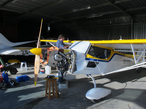

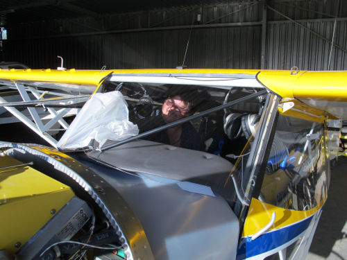

Before I went to Israel Boet helped me fit a new thicker window and it helps if somebody helps you that has done it before.
While being at the plastics wholesaler I bought thin Nylon sheeting and made a cover over all my electrics The window in the Bushbaby is not that water tight so now any unwanted water can run of the sides and not into the MGL and radios and Transponder.

- Boet in action 1
- Window 1.jpg (52.88 KiB) Viewed 46559 times
- Rain skirt in place
- Window 2.jpg (52.07 KiB) Viewed 46559 times
- Boet in action 2 skirt in place
- Window 3.jpg (58.31 KiB) Viewed 46559 times

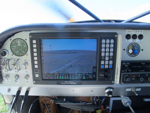

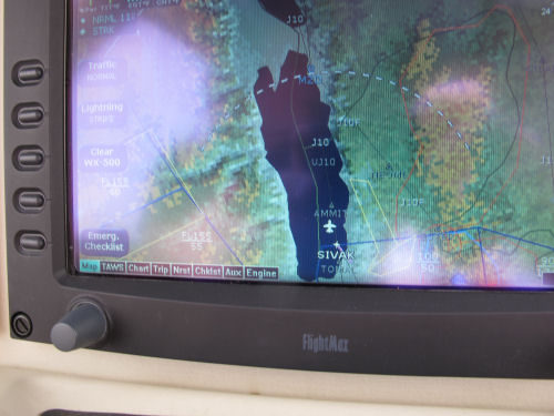

As promised I will now let the test flight data flowing. This evening it was stunning and I could just not resist the temptation for a quick flight.
I had a small problem with the internal clock of the MGL unit, it was quickly sorted out by Rainier. It is very handy that they are in Somerset West.
The Voyager is now functioning perfectly and it follows a heading and then when I tell it to go back to Grootfontein it just does it.

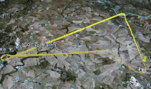

I am showing tonights flight flown entirely on autopilot except for the turn over Morningstar. The autopilot flies a rate one turn.

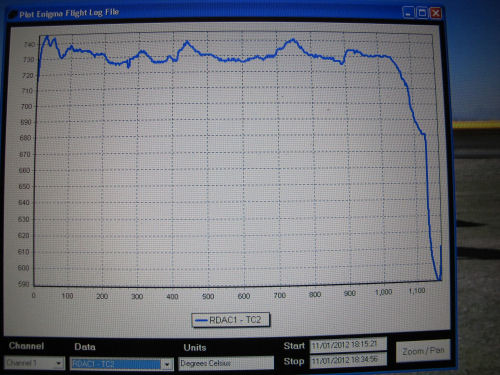

Also I'm showing the EGT's they run constantly above 700 C and the fuel economy is 16L/hour in cruise depending on the power setting that is about 60% power.

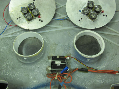

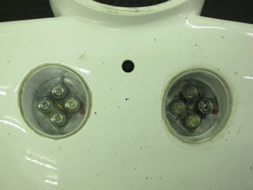

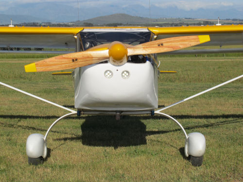

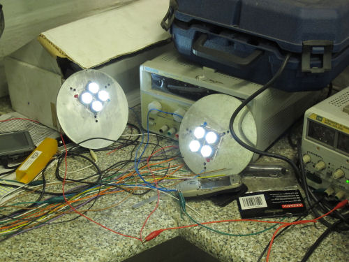

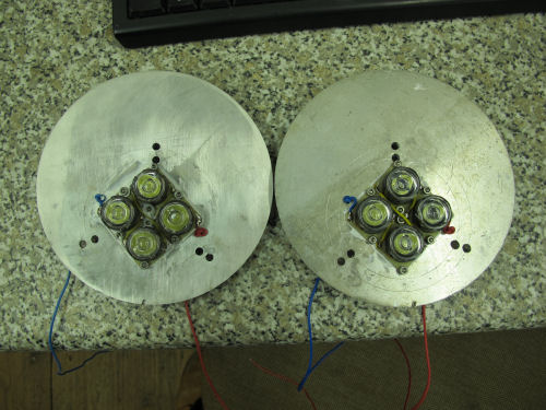

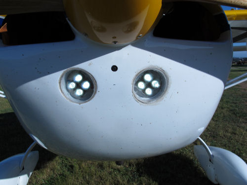

I had great fun making the new landing lights. The LED units are from Philips and they are the 3W units. The lights were tested on the bench for heat output.
In the specs they are rated at 3.5V each, so on the bench at 3.5V they become very hot and definitely need a heat sink. But at 3.1V the stay hand cool with virtually no heat build-up. So 4 units in series can run all day on battery power no heat. When the engine is running the voltage is 14.1V but then the big fan is also turning and the heat sinks do there work. I have flown landed and checked the heat sinks and all is well. I'm also enclosing some foties.
The camera is now in colour and a wonderful asset during taxiing. It just helps to have more vision in a taildragger.

- This documentation is just awesome
- Google flight.jpg (59.38 KiB) Viewed 46476 times
- EGT temps for this flight
- EGT.jpg (53.78 KiB) Viewed 46476 times
- On the bench
- Landing LED 1.jpg (64.06 KiB) Viewed 46476 times
- Landing LED 2.jpg (58.4 KiB) Viewed 46476 times
- The heat sinks are just two pieces of aluminium
the led's were mounted with that white past
and held in place guess what cable ties - Landing LED 3.jpg (54.73 KiB) Viewed 46476 times
- Landing LED 4.jpg (29.91 KiB) Viewed 46476 times
- The little black spot between the lights is the camera
- Landing LED 5.jpg (37.43 KiB) Viewed 46476 times
- Just look at those sexy legs
- Landing LED 6.jpg (57.76 KiB) Viewed 46476 times
- this is the picture of the black dot
- camera 1.jpg (52.42 KiB) Viewed 46476 times

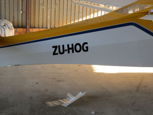

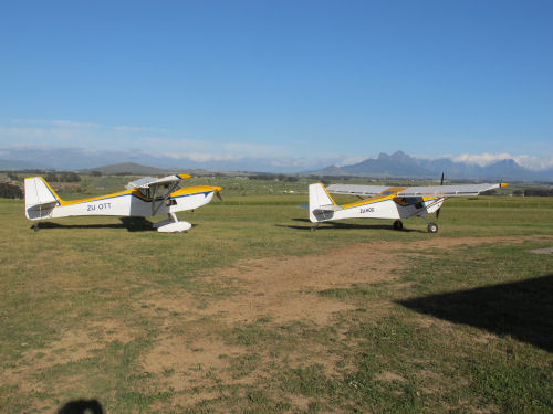

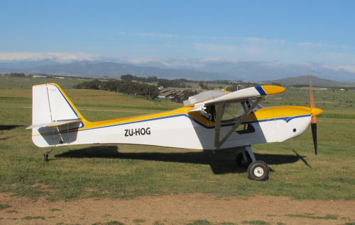

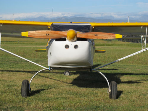

Here is some good news . The sister ship of ZU-OTT is now ZU-HOG they are both Safari's actually Ser # 142 and 141 and ZU-HOG received its Proving Flight Authorization.
HOG will overtake OTT with the paperwork because ZU-OTT is still struggling with the engineering departement that insists a CAA Test Pilot to accompany me with the test flying for the positive G-load test. The Cape does not have such a person and I spoke to the CAA test pilot in Gauteng and he says I know more about the little aeries then he. My senses are leaving me.
However the Bosvark OTT did 3.2 G's and if you observe the airspeed limitations that are recommended it is almost impossible to overstress this airframe. Hence the safety record of the Kitfox Bushbaby line of aircraft. As far as my knowledge goes no structural failures midair , they do bend when they hit the ground out of control.
ZU-OTT has now done in the excess of 300 landings and the gear is really doing its thing. I have now flown ZU-HOG she is an absolute honey flying dead straight Boet's aeroplanes fly straight because he builds them straight. HOG flies hands off. the Bosvarks are OTT and HOG I wonder why?
HOG has the more powerful 120 horse ENGINE This engine runs away with the same prop as OTT a new prop has been ordered from Pprop were looking at a 72X66. The tuning on this engine is different to the GS1200 but the blackbox and full telemetry helps a lot. With the tuning of the two BMW's and the Lycoming 235 and soon there is a Lycoming O-320 that is going into Donald's aerie. I do not dream ordinary dreams I now dream in numbers.
I'm enclosing some pictures of the identical twin Piglets.

- The registration is on thanks SEAN
- HOG 1.jpg (41.79 KiB) Viewed 46280 times
- The twin piglets HOG and OTT
- HOG 2.jpg (44.74 KiB) Viewed 46280 times
- The important piece of paper thanks Boet Sean Anton and the ever efficient Colett v Zyl
- HOG 3.jpg (63.22 KiB) Viewed 46280 times
- This is the foto that went on file
- Hog 4.jpg (40.34 KiB) Viewed 46280 times
- Only the spats to follow
- HOG 5.jpg (55.59 KiB) Viewed 46280 times
