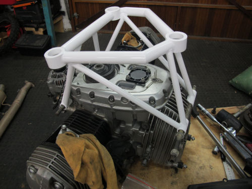

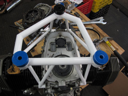

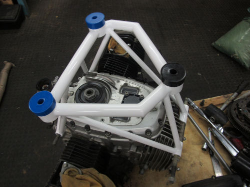

Got the painted engine mount back for the trike. The painting was done by Keith, 2K pack we do not like to have them powder coated because it can hide cracks.
I fitted the rubbers black at the bottom and softer blue at the top. When I fly I will let you know if it is a good idea.

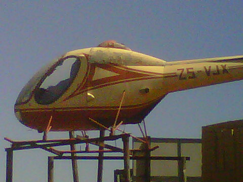

Took this pic today Easter Sunday while out for a drive down Main Reef Road. You can see it from Google Street View too, at 26 12'22.83" S & 27 58'52.05" E
That is one of two that Carel van Aswegen built
thanks for the pic that is history.

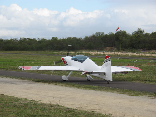

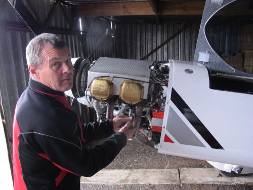

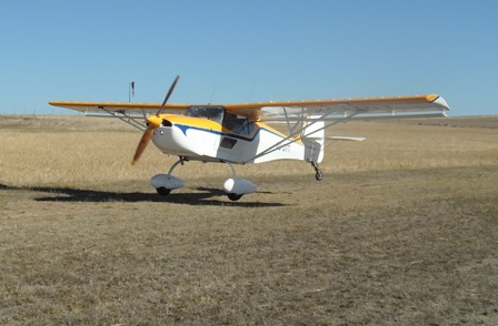

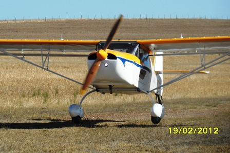

Oupa is nog steeds baie besig? Spikes took these pictures of me flying the big man`s pride & joy a while back. Thanks for the trust, I feel honoured for the part I could play to help get this aeroplane off the ground. What a joy it is to fly this magnificent machine!!
- The OTT one.jpg (44.81 KiB) Viewed 55110 times
- The OTT one 2.jpg (58.84 KiB) Viewed 55110 times
Hi everybody sorry for being away for so long I have been doing a lot of work on the Vansin put better monitoring equipment in and also a new radio Icom 210 so both my aeries have the same radio. I'm preparing and servicing the plane for a long trip coming up Botswana Zambia Zim etc so everything must be checked all filters cleaned etc etc. Work has also been keeping me well occupied and the RedX is also eating my time
The question about timing it depends which 1200 GS you have there are various models if I remember correctly Charles your engine is the same vintage as mine you can happily run at 30degrees before TDC on the main system and the secondary on the lower plugs at 26 degrees. Under full power the engine wants to run on the main plug only it has to do with the flame burning and that burning should not be disturbed by the lower plug.
I have also been testing the sister ship to ZU-OTT the registration is ZU-HOG same colours etc. She has the 125 hp engine with higher compression and here we run 25 degrees BTC. You can feel the extra horses and she has the same prop as OTT but turns 400 rpm more and that is about 125 rpm more on the prop speed.
I have been flying OTT a lot and on the last fuel measurement I did 4 hobbs hrs on 60liters this included 15 take offs and landing the normal cruise was between 5600 and 5800 rpm and silk smooth. I think that the flywheel mods are good and I'm so happy that at this stage I do not want to change anything. I am making some more of the flywheel ad ons the local market has depleted all my stock I have made and I have had requests from overs the water as well. All the testing takes a lot of time. The 912 has now at last come up with what we have been playing with there budget was 13million Euro to do the mod. That puts our backyard workshop into perspective.
The new exhaust is very quiet and every flight is recorded on the MGL blackbox and that makes the fine tuning so much easier. When my last fuel run with the fuel level below 10liters on the tanks I again did a fuel flow test. She needs the Facet pumps to start the fuel flowin like a syphon but then the flow is 60l/hour per tank on free flowing. I however run my aerie with both tanks all the time I do not see the need for switching tanks and below 15 liters in the tanks I use the Facit pumps as well as for take off and landing.

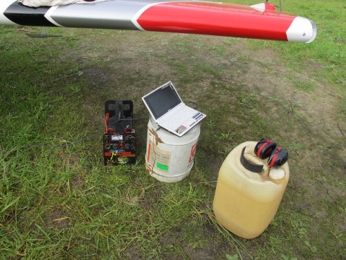

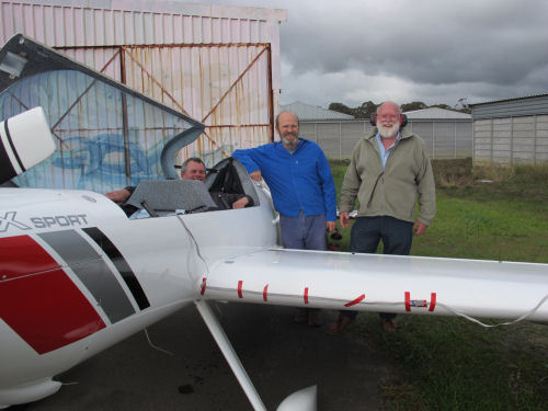

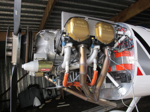

properly back in the saddle. Tuned the Lycoming of Donald. It was a team effort Ystervark and myself we scratched our heads and finally got to figures to make the Lyc humm cold start hot start wait ten minutes and start then did the throttle snatch test and then the full power tests. The air was humid and the prop tips were making vaporization.The day was well spent and today Donald did a test hop of 180 seconds. He was interrupted by an oil leak but he said the engine was super smooth.
Today I down loaded the data from the Enigma and the EGT's from all cylinders are absolutely equal. The Ebox's were doing its thing very well and I must say that Ystervark has done a magnificent job on this piece of electronics. Tuning the Lyc was a slight difference then the BMW but we soon got the feel for it. During the weekend I still did some RedX flying all in all 6hrs all at night with 4 ILS'S trown into the deal. So I am IF and night current. But I lack sleep. Here are some foties.

- under the cowling
- FJU.jpg (63.32 KiB) Viewed 54447 times

It has been a long time of no news but it does not mean we have not been busy. Every time I get to Morning Star I get reprimanded by Mike (Mic) and Ian. Mike built his own own Bushbaby and Ian has just replaced his h h h h h Hirth with a 80 horse Rotax and he is smiling. The Hirth gave Ian some serious experience in the replacing of cracked parts and he also touched up on his actual forced landing practice. Mike quietly is enjoying his 582 he flies his yellow machine very well. On the topic of colours there are the yellow supporters and the red supporters and then you also get the odd other colours like blue purple, but in my eyes yellow is the way to go we have a yellow Sling on the field it is stunning.
Meanwhile we are tuning the IO-235 eBoxi Lycoming. There is a net loss of weight the two mags and the big carb are heavier then a twin eBoxi system. The aircraft has flown when the aircraft picks up speed the ram air effect makes the Air more and the fuel is constant and the engine gives of soul inspiring backfires, this helps to make Donald confident and more relaxed in the cockpit. But every weekend there is another tuning session. The weather in Cape Town has not been helping but I can at least say that I'm very currant on ILS approaches.
On the topic of ideal mixtures a lot has been written on Lean of peak flying and the GAMI injectors which are matched to the induction system. Donalds induction system is equal length and the air is not warmed by the sump as is customary in other installations by Piper Cessna etc. Our EGT's are running within a few degrees of each other.
All-though the latest fashion is running lean of peak from a chemical flame point of view that exhaust flame is an oxidizing flame and that is why the old myth that a lean mixture burns valves is not a myth, some valve material can not cope with this oxidizing flame. The valve material on the Lycomings and Continental engines can cope but it remains an oxidizing flame. 100 F rich of peak EGT is best power it also give a reducing cooling flame. For Donalds aircraft he wants the power so on the rich side it will be. Just remember a cutting torch does its job with excess O2
The tuning of the Lycoming is very much different then the BMW the Lyc works with few revs lots of torque and for that she wants lots of fuel. In the end it is always grams of fuel / kilowatt / hour. When we run into trouble we call on Ystervark he is after all the Big Daddy and brains behind the eBoxi.
Because we retard the timing when idling she sound smooth slow idle 400 rpm is no problem and she sounds like an old farm LISTER diesel , their operating revs were 750 rpm. big flywheel and one piston.

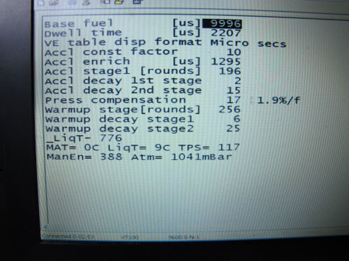

I just have a few pictures I document all changes in the map with my camera easy documentation.
